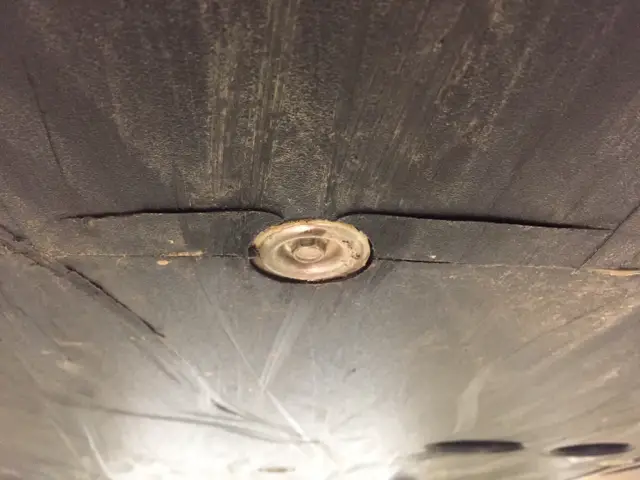

This is after the ride at royal blue. I heard it banging on rocks all the time and the crack must've come from the freezing temperatures and rides in the river.
Interesting. I doubt this stuff is irradiated any for cross-linking for strength? Maybe it was a flaw in heating to strengthen the UHMW poly - if they even do that. Very cool process on the joint implant side for wear reduction and reduction in free radicals.

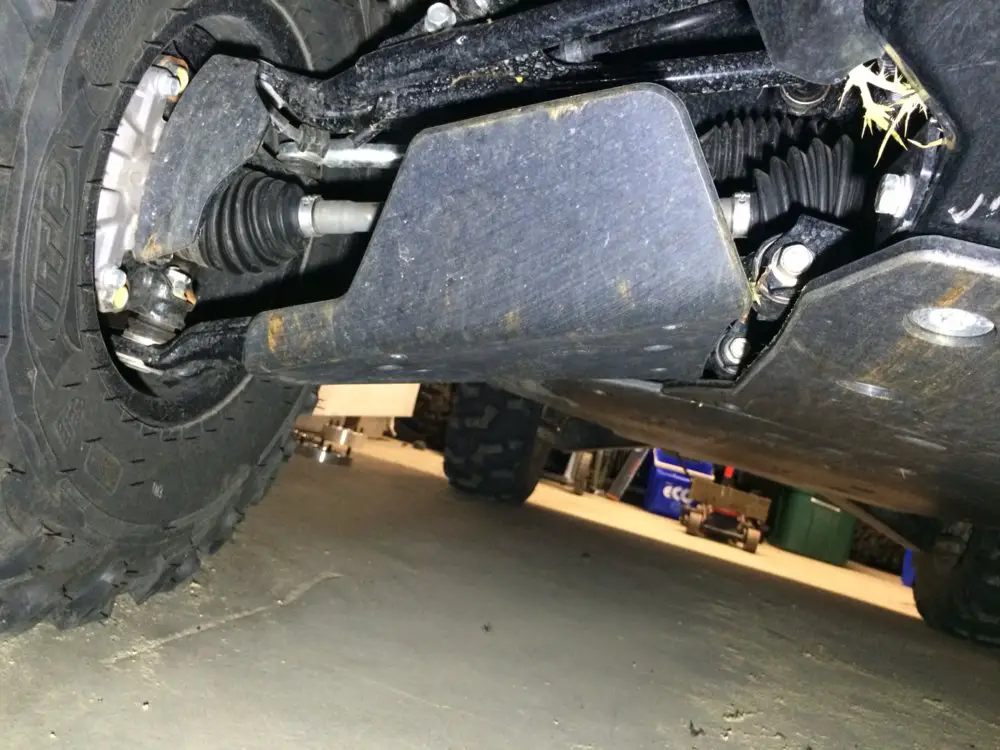

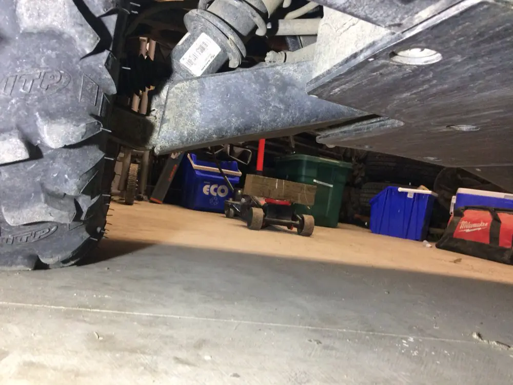

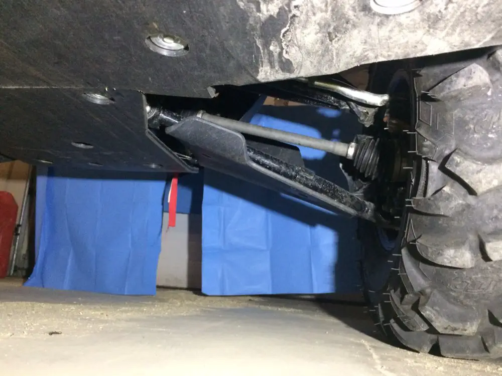

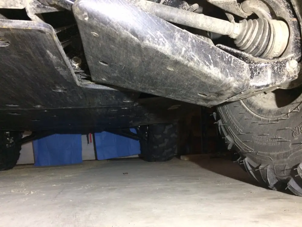

Here you go @500
Picks of A-arm guards: Front
IMG 3039 IMG 3038
Rear:
IMG 3037 IMG 3038
Bolt on
IMG 3040
IMG 3035 IMG 3036

We use an abundance of UHMW here at work. It's easy to drill and form. The crack in the pic happened because of the bolt hole. We use it in our Mega Shredder on multiple conveyors and it takes a hell of a beating.
