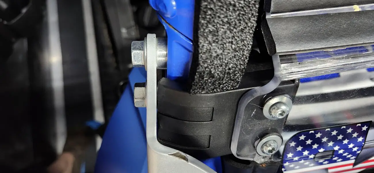

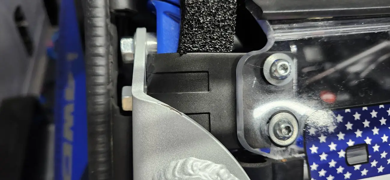

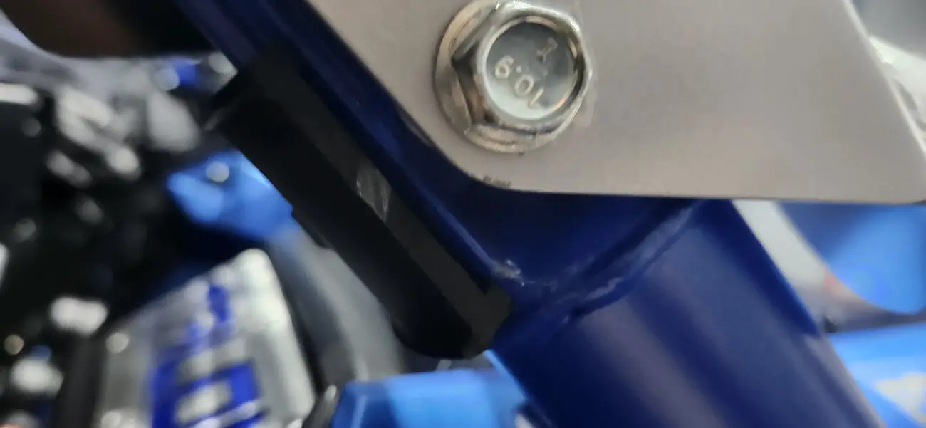

Hell that aint bad
I basically used a cutoff wheel and took put the hing, about a half inch from pivot , just enough to clear the exo tie in, still seems to clamp tight. I see no issues

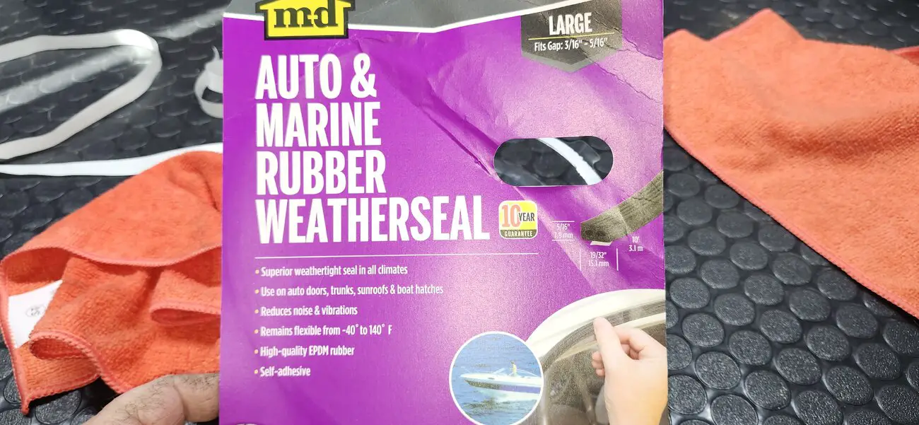

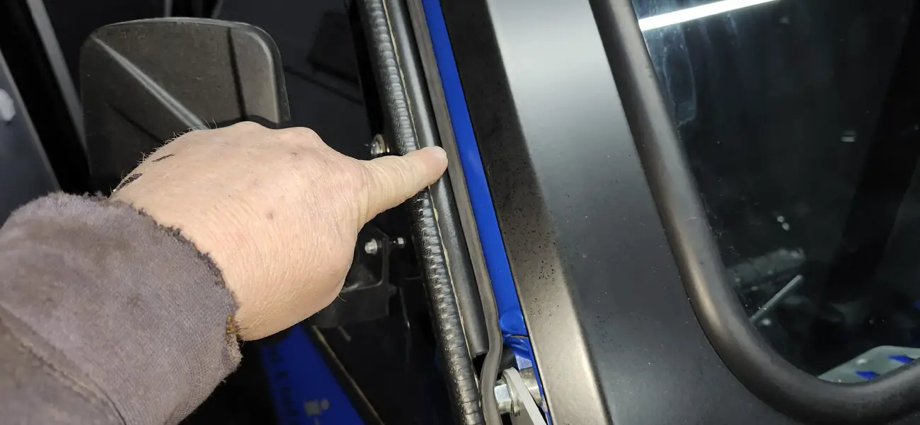

Found a perfect solution. To make satv cab seals very snug, found this weather stripping at Ace hardware, super sticky, now a great seal on my cab doorsView attachment 454482View attachment 454483
Curious what kind of temps you see with that weather stripping? Need to try to add some on my pioneer and wondering how it actually handles cold.
18 19 when I put it on, shut door on it and stuck very well, riding this thurs morning, 23dg, 1 mile in, easy 60 dg in cab, no heater, just honda heat
