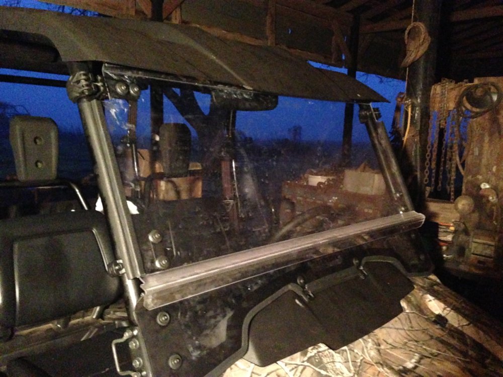

After I finished I noticed one of the 6mm locking nuts on the top left hinge was missing & the one next to it was loose. I tightened it up & I'll get with honda tomorrow for the missing one.
IMG 0759
Here's the finished product. It seems like I got it on tight enough but the 'V' on the upper doesn't quite contact the lip on the lower. 1/4" gap but I'll play with it little more.
IMG 0761

I had to adjust mine up and down to make the lips line up with each other. When I was happy with the results I took a paint marker and put a line on the roll bar where the clamp sits so when I remove and reinstall it, I know where to put it. Looking good.

Looks good! I had the same problem. My lower was so close to the top but not quite touching. I discovered that you can push the weather stripping on the lower windshield up a little and make it touch. That fixed mine.

I gotcha...so the lip doesn't have to touch in the deepest part of the 'V', just somewhere along the top or bottom edge of it?
That's my understanding. Just to stop wind. I thought it was suppose to meet like in the instructions picture but when you bolt it to your dash, I don't see how that's possible. I could be wrong and there are much smarter people on here that may be able to help but I'm happy with mine.

Thanks for the tip. My weather stripping was really wavy out of the box so I pushed it all the way down on the lower. Maybe I shouldn't have done that.

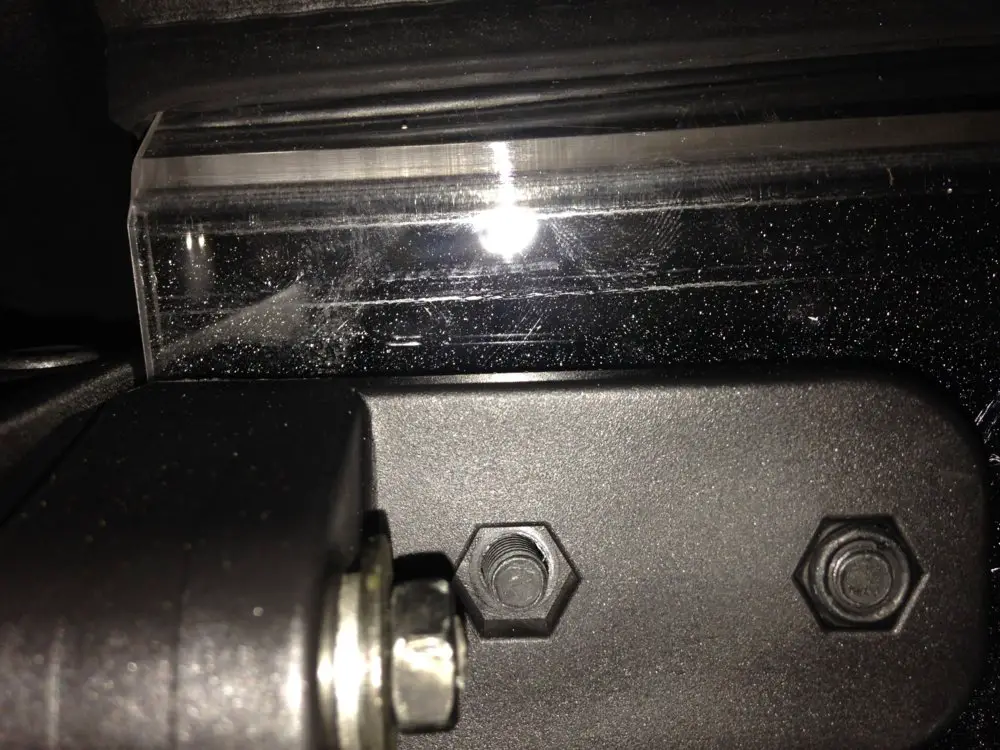

That's odd. Mine actually tighten up the weather stripping by the dash mount.
IMG 0440
Also, this is what I meant by push the weather stripping up.
