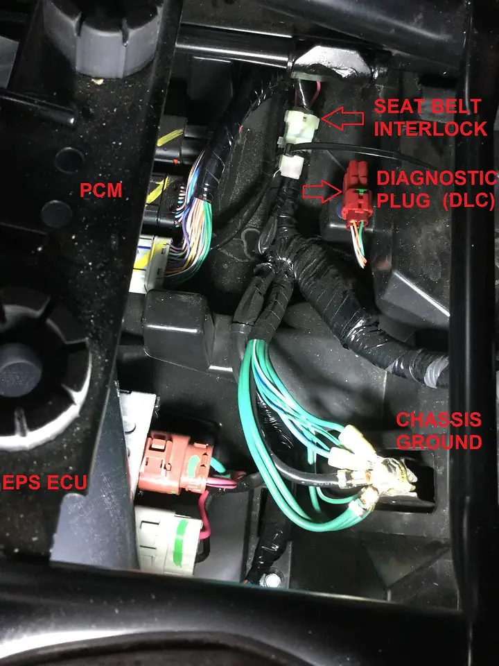

1000r non live valve. Have some weird electrical things going on, want to start by checking all of the ground to frame connections. I see the ones on the left side of the engine and in front of the left rear tire, but i am sure there must be others. Would hope to not miss one. Anything associated with the charging system (stator, regulator/rectifier) is of particular intrest. Where to look?

Hi, Dan - under the driver's seat - (this is linked in my sig for the curious)
