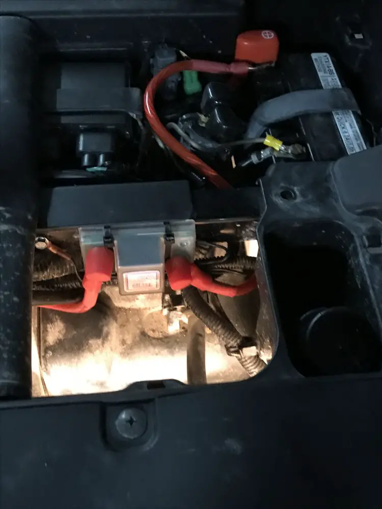

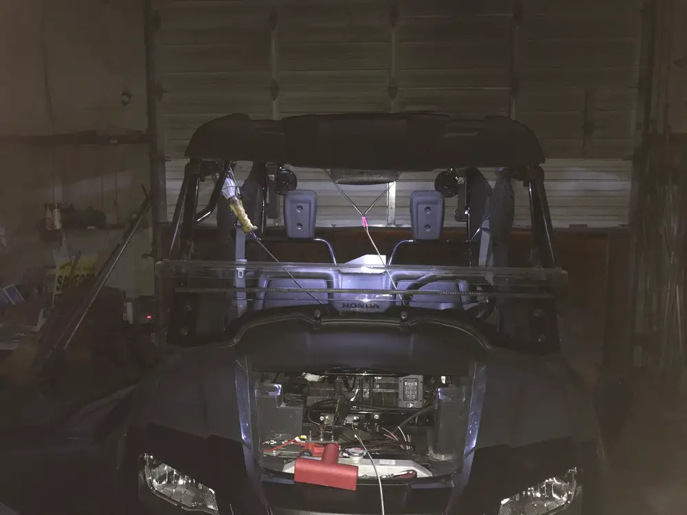

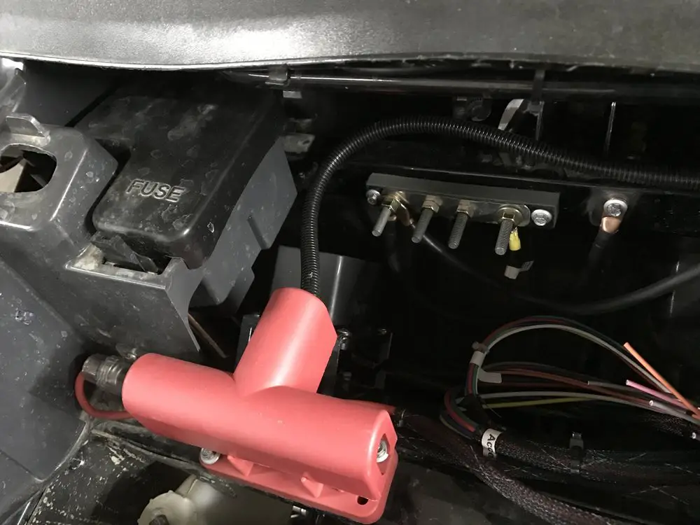

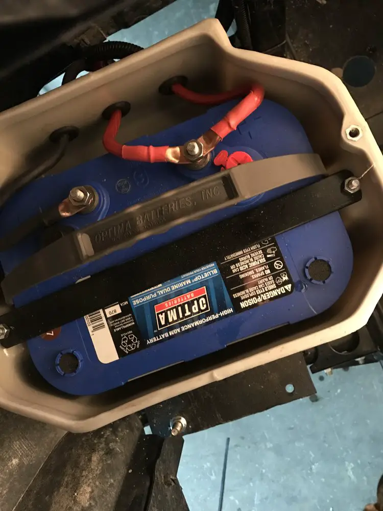

Ok guys tell me what I did wrong. Primary battery to isolator from there to secondary battery. I left the secondary and went to a 300 amp relay per @ohanacreek. Left relay to a three prong jounction block. Built my own ground block ran ground wire from battery to ground terminal and also ground to frame. I also installed the waterproof bussman fuse and relay box. I think I'm ready to wire my accessories. Does anyone have anything to add @CumminsPusher?

Did wrong? Lol. Sounds good to me, great base and overkill like it should be good job

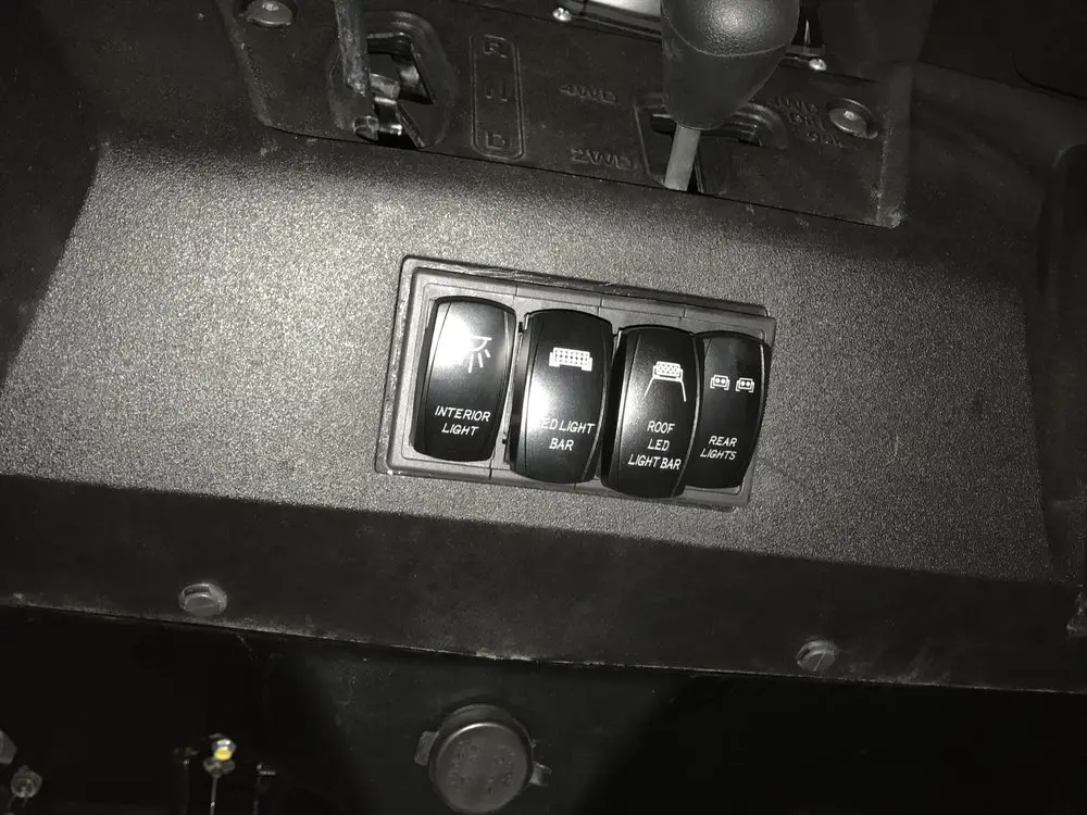

I like the placement of your switches. Most everyone is placing them where the warning sticker is above where you have them. I always thought I might add some where you put yours.
Going to have a few up there too but my radio takes up a lot of room so had to look for somewhere else for a few.

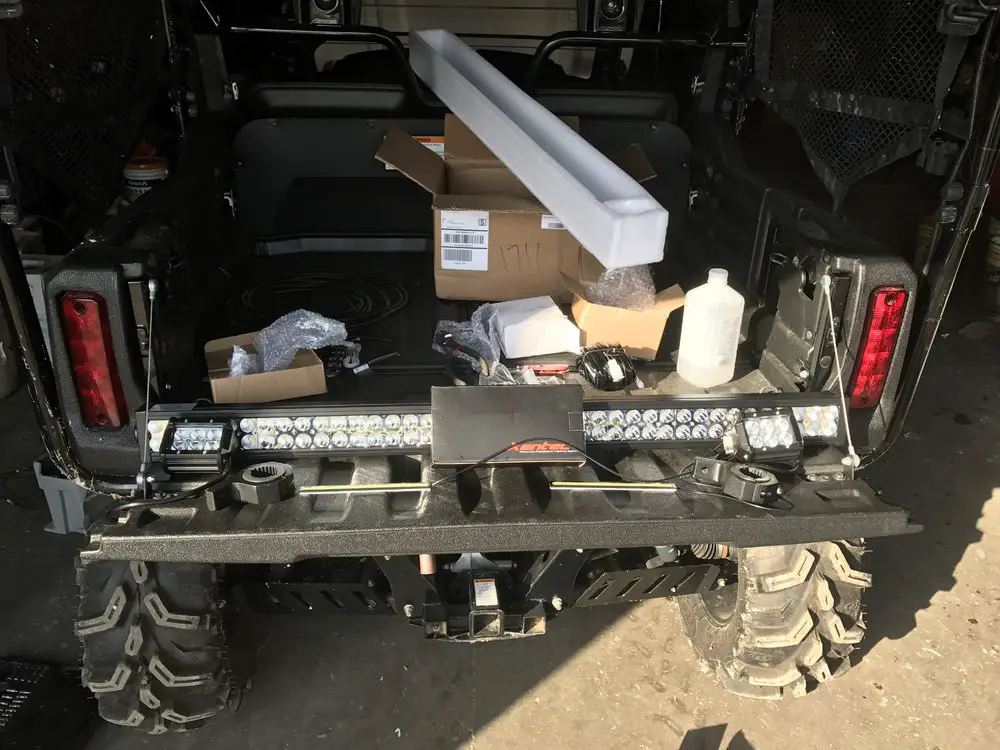

Little brown truck brought more goodies. It's says with winch mount was going to top mount hope the center plate is still in front skid.

Nice bumper! I mounted my Tera45 in the KFI mount this evening. Took about 1.5 hours by myself. My buddy tapped a stump with the skid plate Sunday, and realigning wasn't a breeze.
I hope you have a skid plate in that box. Best I could tell the factory plate is part of the bumper.

Yes it is bumper and skid.

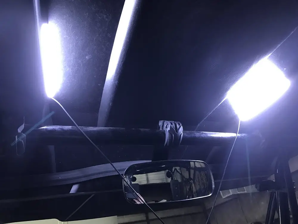

While you're wiring. I put a light up in the top corner each side of my cab. It's tucked inside so it can't get ripped off and it lights up everything beside me. It's hands down my favorite add and the last light I would give up.
