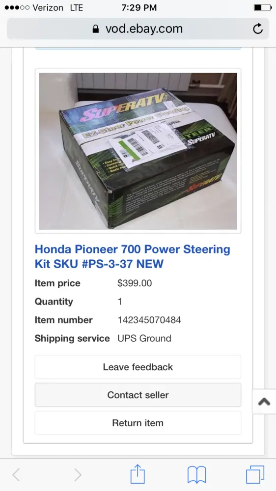

Picked this up on eBay. Anybody got any pointers before I tackle it next week?
Yes I do have a couple. First, removing the dash and steering wheel and the c-clip on the steering column is NOT NECESSARY. I only removed the drivers front fender, and some guys didn't even have to do that. Second, there is a shroud down there that I ended up removing completely. The directions don't tell you to do it, but I couldn't see how I could leave it on. Sorry if that's a bit vague, it's been almost two years since I did it. You'll see what I'm talking about when you get in it

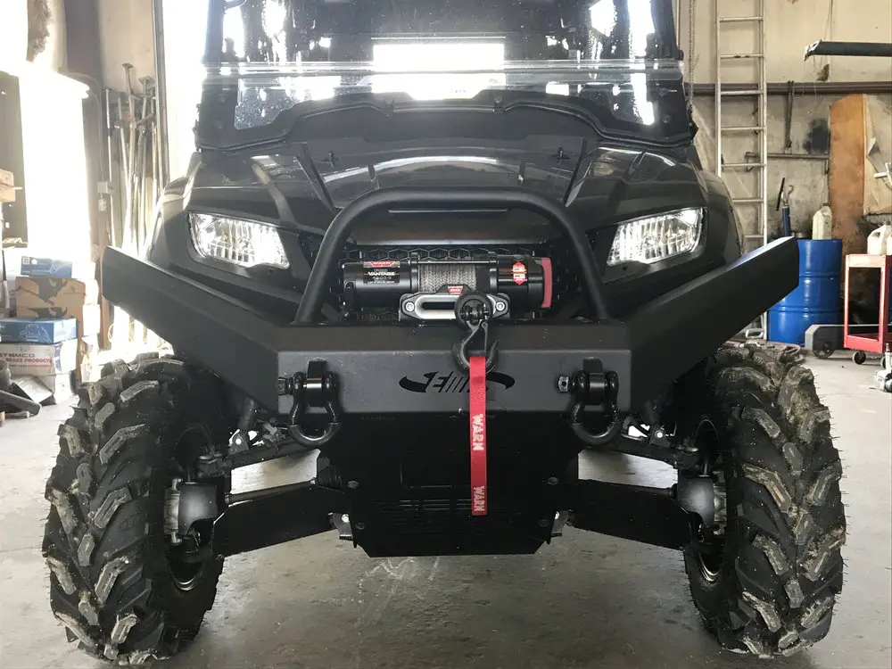

Added some shackles to the bumber
man that bumper looks really good,I like how you can see the winch.power steering is a nice touch as well.Last week I busted my hands good when I caught a small stump and it was the first time power steering entered my mind as a future add on....
Yes I peeled some skin myself. I said well power steering would be nice.

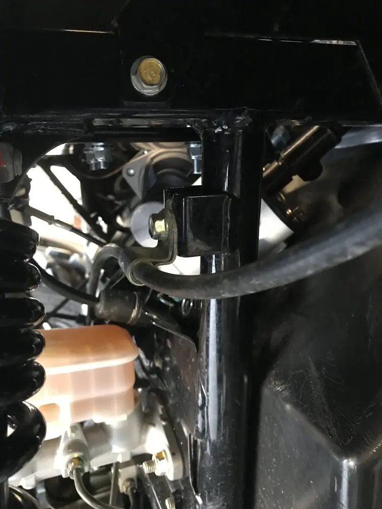

Well it's done. Took me a minute but I was able to do it without removing anything. All I had to do was cut shroud where mounting brackets sit and trim hump where pump lays which they tell you in the instructions.

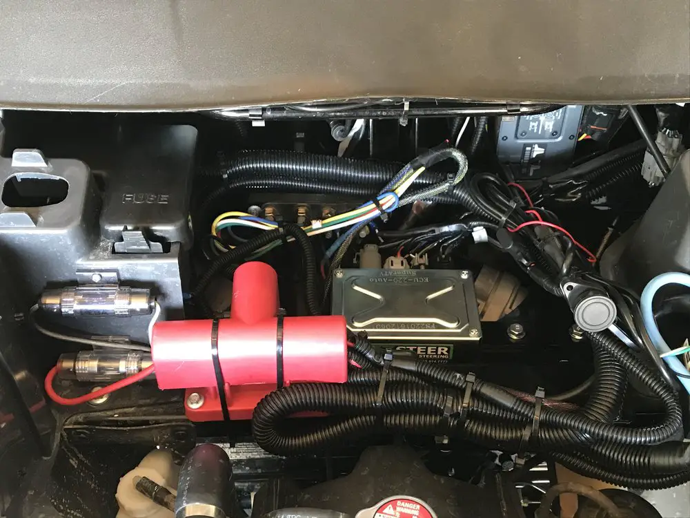

Under hood is getting full. Need to trim up some excess which wires. I think I have everything in place to just plug and play the rest of my lights. Wish I was meeting all you guys at takeover.
