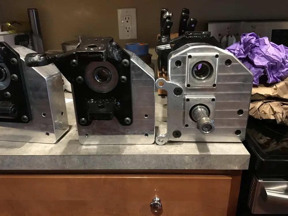

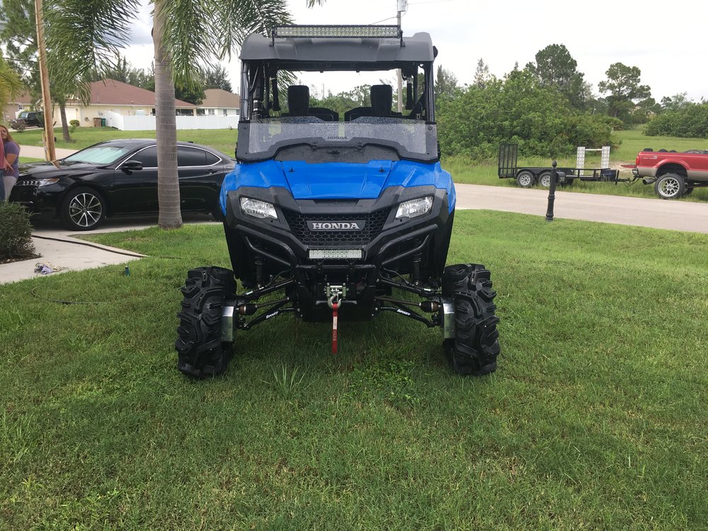

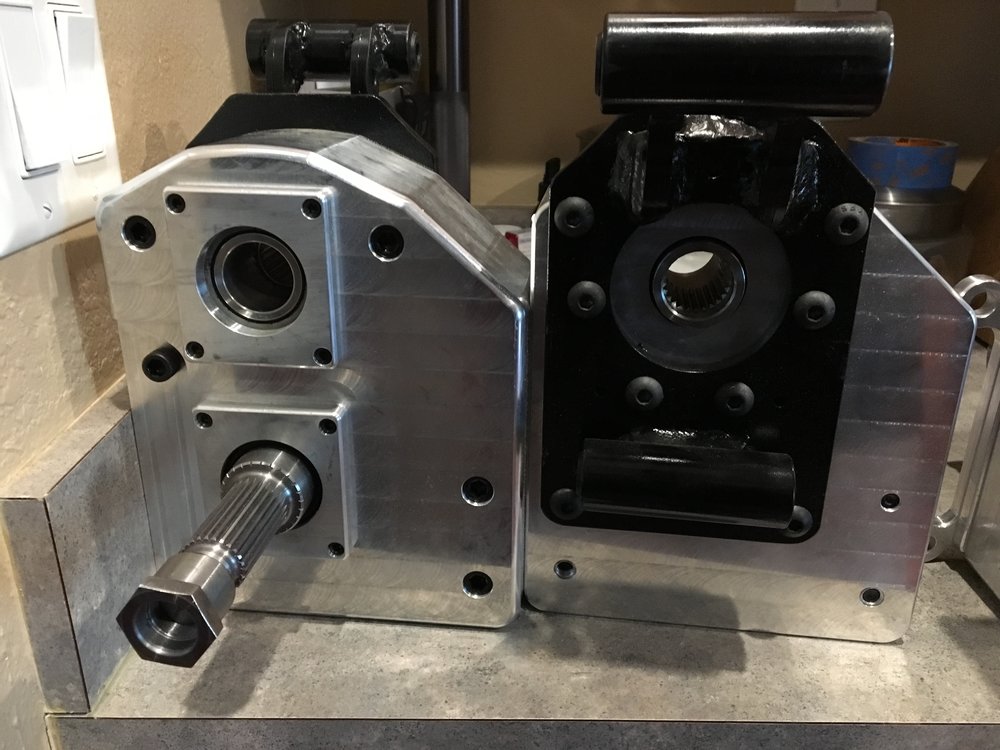

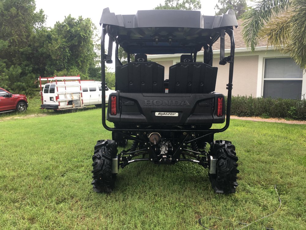

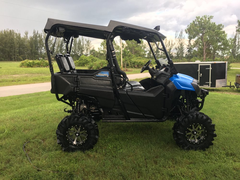

We are in the process of installing them on my buddy 700
IMG 0594 IMG 0595
39,129
I would be cautious of the A-arms mounts with those. I tore both sides on the front of my P700. Also I've seen several others out on the trail with torn a-arm mounts.
I'd hate for you guys to get stuck in the woods! At least look into beefing up the mounts.
Good luck, I cant wait to see it. The P700 really needs that extra gearing.

They make it really wide why did you have to modify it what was wrong what size tire you putting on it
N
Nick1997
Jun 10, 2017
23
24
Cape Coral fl
The upper balljoints and the 2016s changed from 11/16 to 3/4 half way threw so we had ream it to make it work and 28s

Wow. You could clear atleast a 32 on that thing!!! Did You happen to measure before and after heights?
39,129
No we didn't but is abouabout 10 1/2 inches taller than stock
Wow! so you have over 20 inches of ground clearance? Stock is 10". Just doesn't look that tall in the grass.
