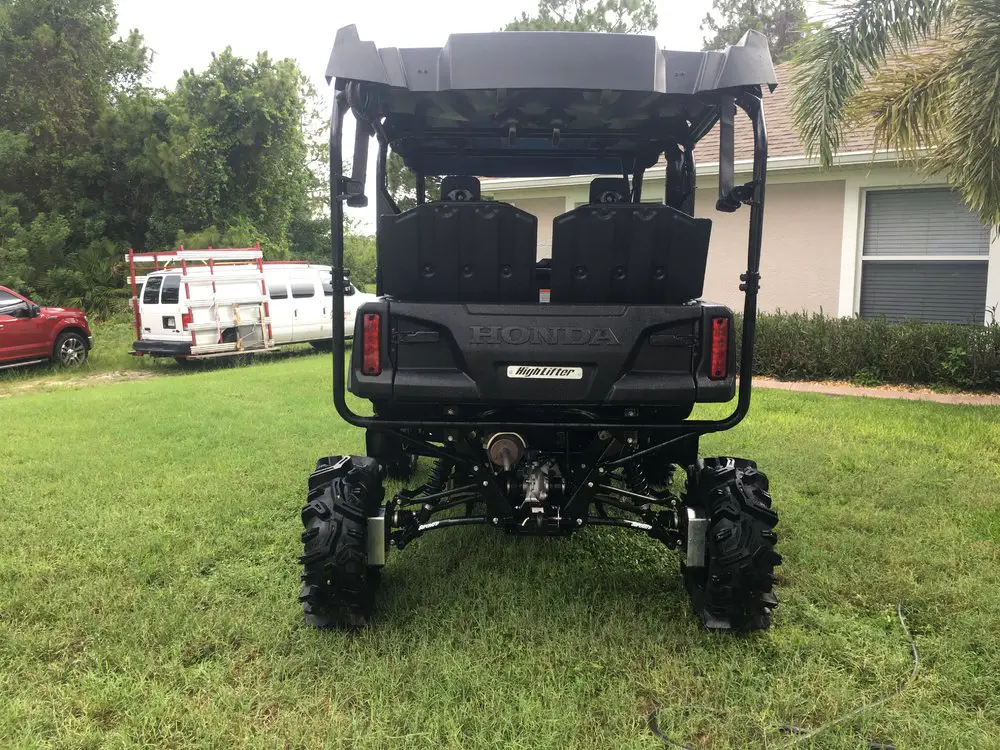

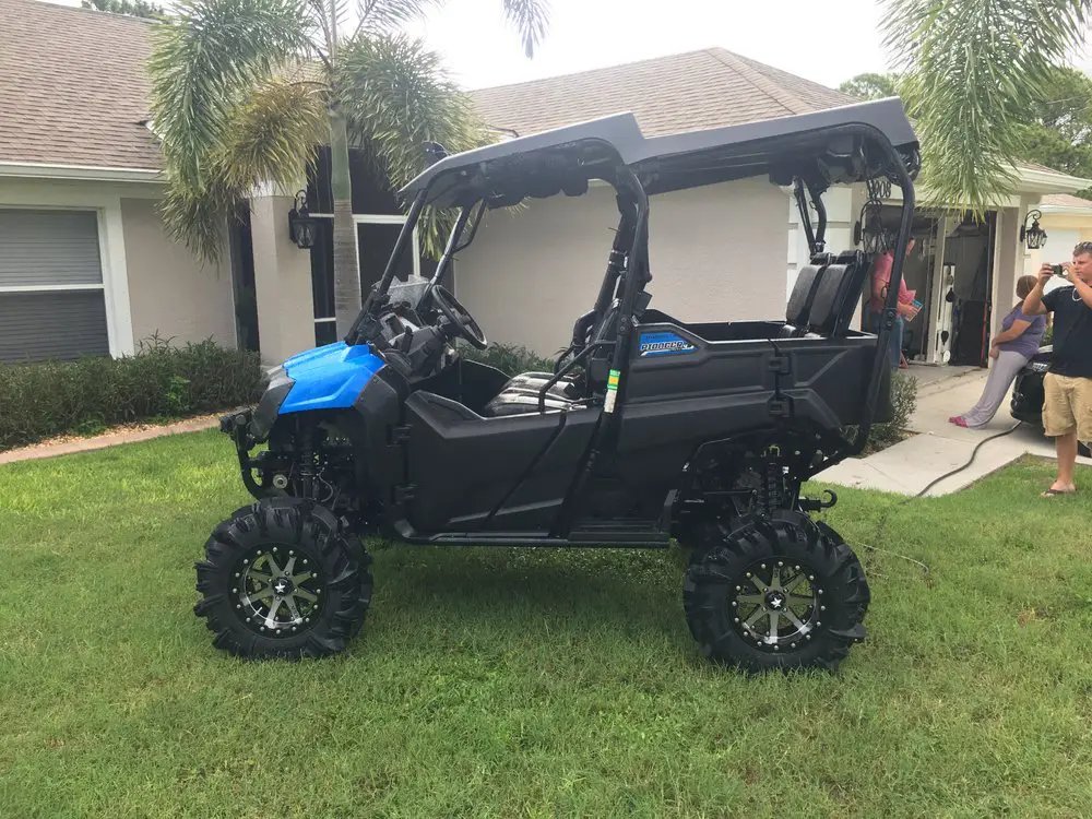

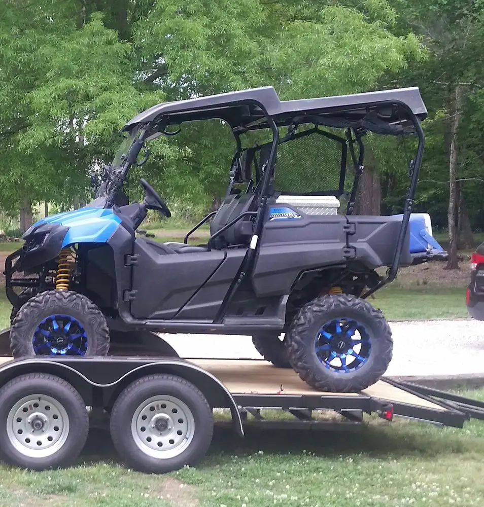

Look at his side shot vs mine. I've got the commander shocks and 28's. I don't think it's 10" maybe 6"
Yeah, that would be more realistic if he added 6" to the stock 10" and have a total of 16".
I'm curious to see how well this thing is going to pull with that gear reduction.!

Yea I'd like to ride in it. I know the 28.5s bias tires really affected mine. I've got radial 28's that are half the weight bit still has hurt it. I wish i could turbo like spyfid did.
39,129
I had 28 inch EVOs on my P700 and it really killed the power in the thick mud. It still did ok but I wouldn't want bigger tires.
Too bad there's not a way to add a gear reduction somewhere else other than making machine so wide. Damn it! Why won't Honda put a low range in these things?

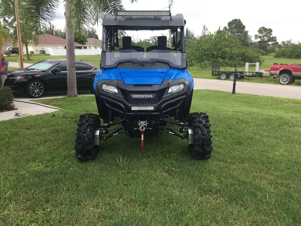

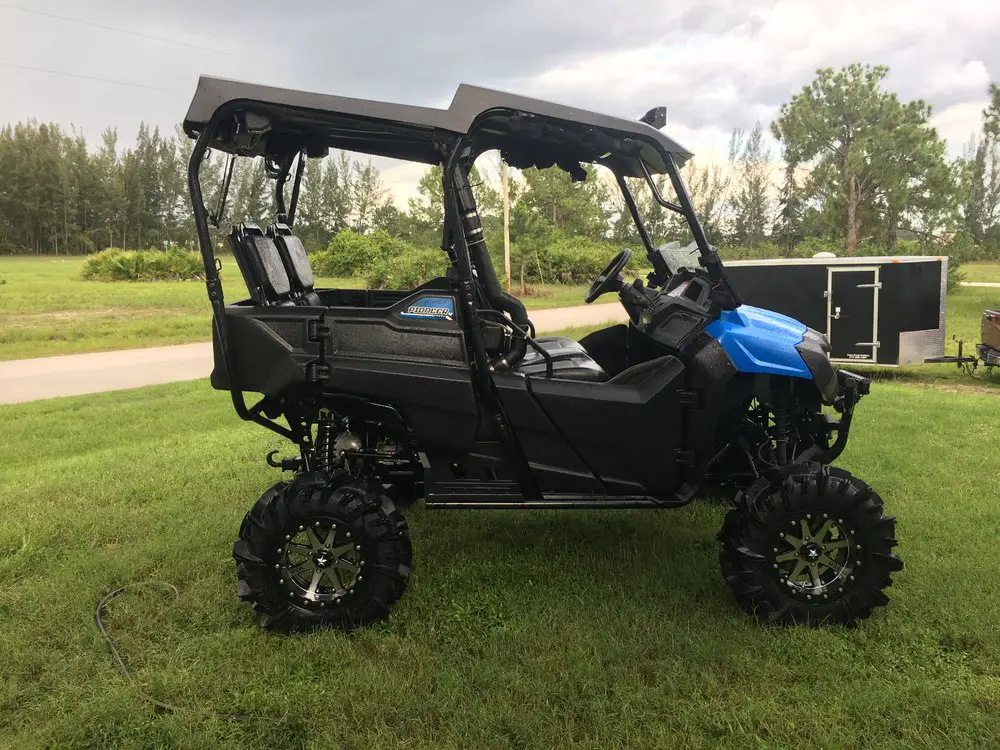

Those are RAD man! I'm wondering how they hold up and how much had to be done to fit them on the 700?
Depends on the the year they are direct bolt on for early 16 and older and the should ave a set that are for the newer models now
