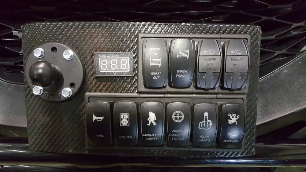

They are called momentary switches. I use one for my winch too. Just for safety though I use a winch power switch also. So I flip a power switch and then use the in/out switch. I guess the covered switch saves space though

Sounds like the sub movie Crimson Tide, just letting out the antenna cable or trolling for the big one. Glad no damage. Momentary or wireless winch switch an option? Have a wireless winch switch on order now.

Wasn't gonna bring this up...but I thought
& decided to share..shameful but could keep
...it happening to others...while coming home
From a dawn drive..decided to hit my light bar.
road was bumpy...not knowing I hit the out..on my
winch...dragging tail..for about 100 or so feet..
now looking for covered switch...glad I wasn't pulling
..into a group of riders...
Thought I'd share...
I use a 2nd rocker as a winch power cut off. It has to be switched on before the momentary rocker will work. Helps prevent accidental line discharge or over winding.
Thanks...
I'm gonna go with power toggle..
to switch I got... short on dash
