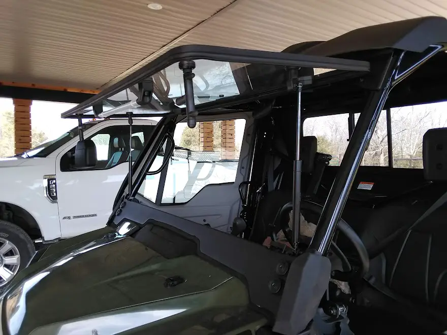

Simple to create a similar venting without resorting to the $$$ flip-up vented unit. I bought the OEM Honda Glass w/shield, then built my own braces to create sufficient venting for our AZ summers, for less than $25...
Certainly not as polished or snazzy as the ones that fully rotate up, but I'm able to get plenty of air by using the top mounting as the pivot, and using the lower mounting as the base for the strut.
To adjust airflow takes about 3 minutes, and to totally close it for winter or rain adds a few minutes longer to remove the brackets and store them in the toolbox, but the fasteners (except for the thumb screws) are the originals, and it's WAY less $$ than the high dollar alternative...
Admittedly, it's not for everyone's tastes, and you may wish to do something different. Just showing you what I did. ;)
