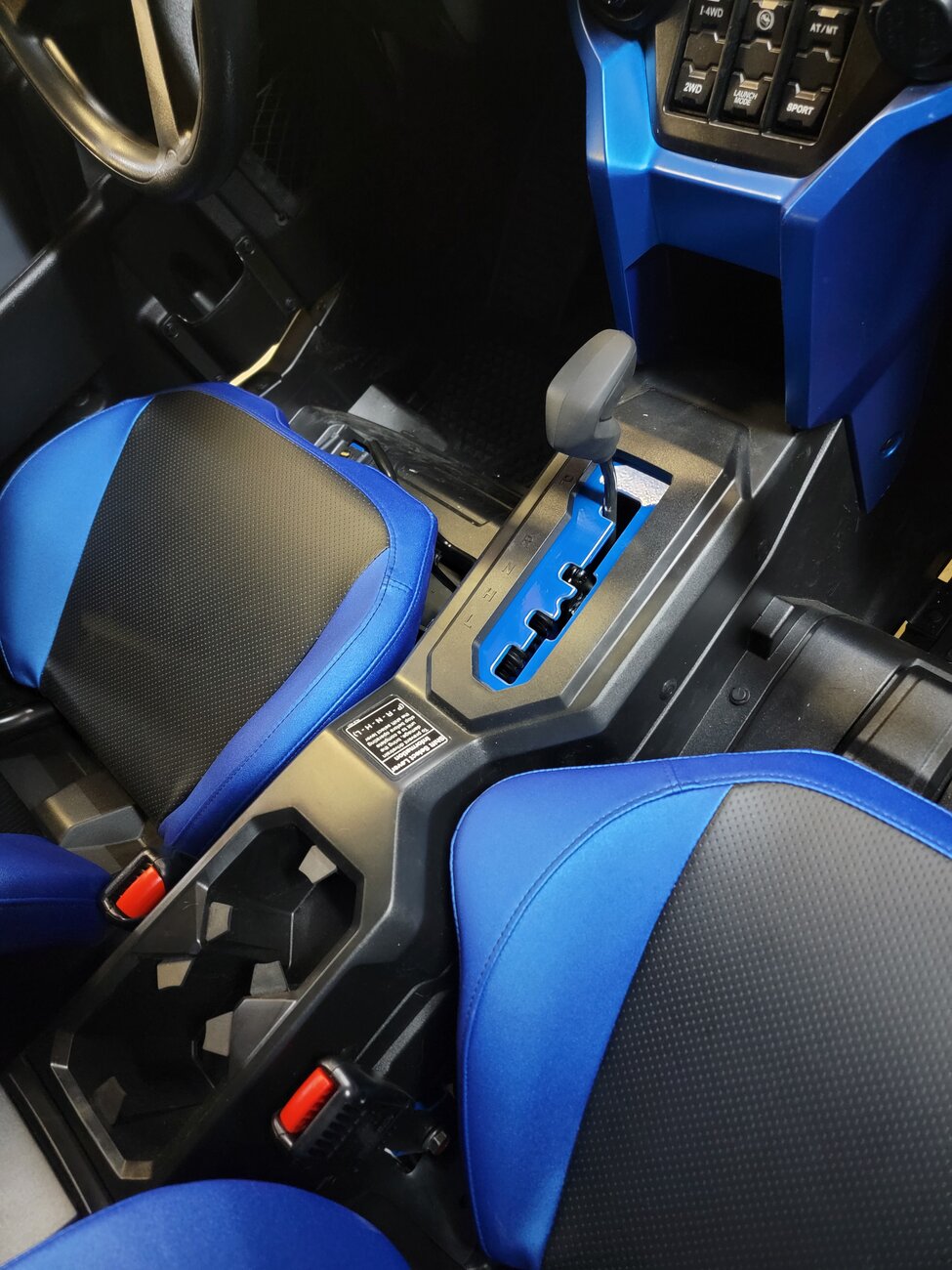

Replaced the OEM safety placard with a dash plate and the OEM plastic shifter plate with powder coated aluminum versions, both from forum vendor 10-80 Dirt Sports.
I believe mine are the first done in the 2023 lighter blue. Our best guess at matching the MAT KYANITE BLUE was Prismatic Powders RAL5010. Not perfect but not too bad, either.

Honda uses a lot of automotive paint colors in the SXS from my research. Of course no one makes those colors in powder besides Columbia Coatings and they only have the first Talon Blue, Orange and Red. So I'm left to try matching available swatches and the same color on plastic and metal differs slightly too. I work with the local powder coat guys to help with colors too.

Let me know how you like the shifter plate. I drove a stock one the other day and that was horrible after using my for 2 years.
Well, I don't have many miles on a Talon with a stock plate, so I won't have much to compare it to.
I was a bit surprised at how easily the powder coat scratched on that shifter plate. I had a few bits and pieces of aluminum laying on the shifter plate (from drilling holes in the aluminum angle I fabricated for the overhead fan installs), I *lightly* brushed them away with a cloth, and it scratched the plate. Meh. I'm sure it will see more than that but was hoping it was more durable.

I’ll have to ask the painters about that.

Thats why I got the black. Im afraid what the orange will do or Id get one. But that blue sure looks good
