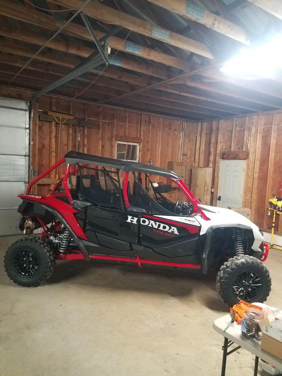

I have begun the never ending customization of my new Talon. I got a lot of ideas from this forum and others so I wanted to post some pics and parts links for anyone who might be interested.

I have installed the Tusk rear glass window. It's alright, the attachment hardware is meh and the rivets that hold the TUSK cutout have lost their black paint. Also, it doesn't make the greatest seal between the bottom of the window and the machine. Not sure there is a better option out there tough, it seems like a pretty solid window otherwise.
I have also installed the Assault Industries Glass windshield which I really like. Great mounting hardware, I love that the vents lock in the open and shut positions. Great seal all the way around. I plan to paint the vents white when I remove the windshield to do some electrical upgrades. I opted for no wipers because I have purchased the OEM Honda wiper.
I also have the Seizmik Pursuit side mirrors with red inserts (of course) The clamps work really well with the windshield.

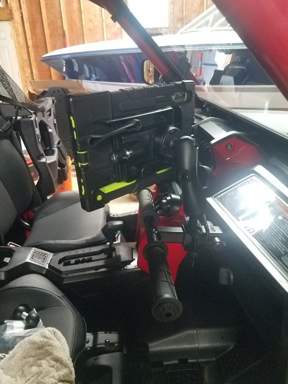

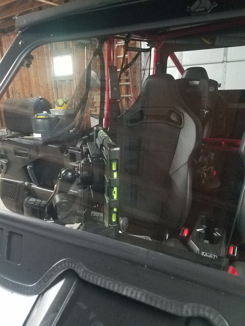

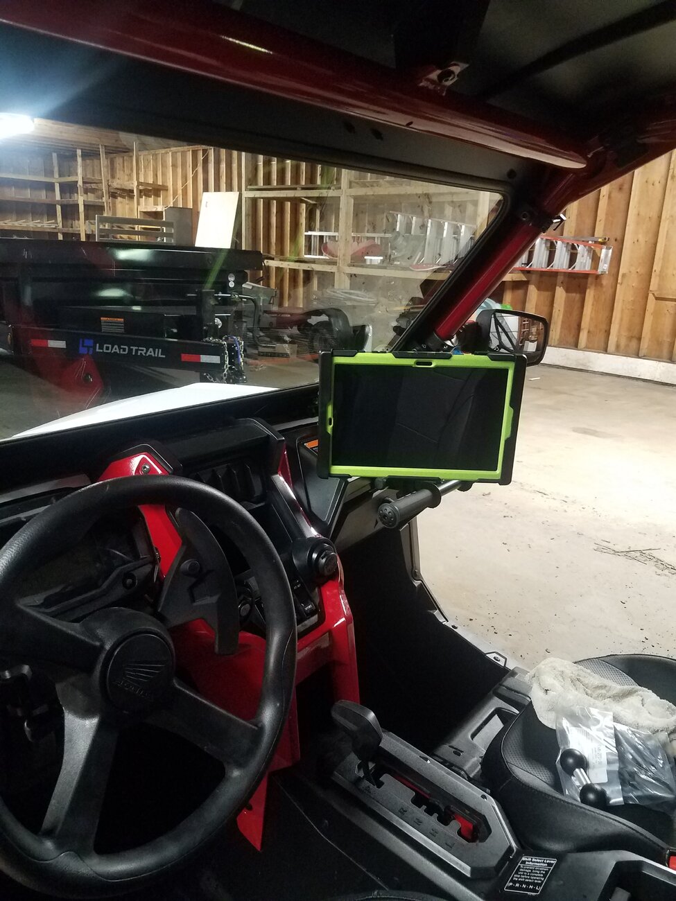

I used the RAM stuff like you did, until I found this on Amazon. I like it a lot better. The back side is solid (so it's a storage cubby), but I cut it all out so I could access my Auxbeam 8-gang switches and my GMRS radio.
1726761912441 1726761931321
1726761949254 1726761968620
Some install and mod details and pics:

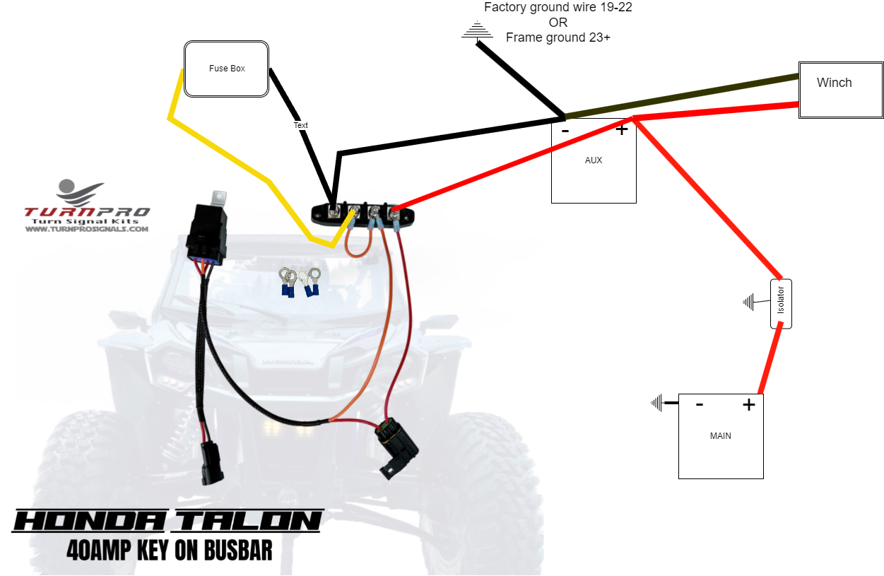

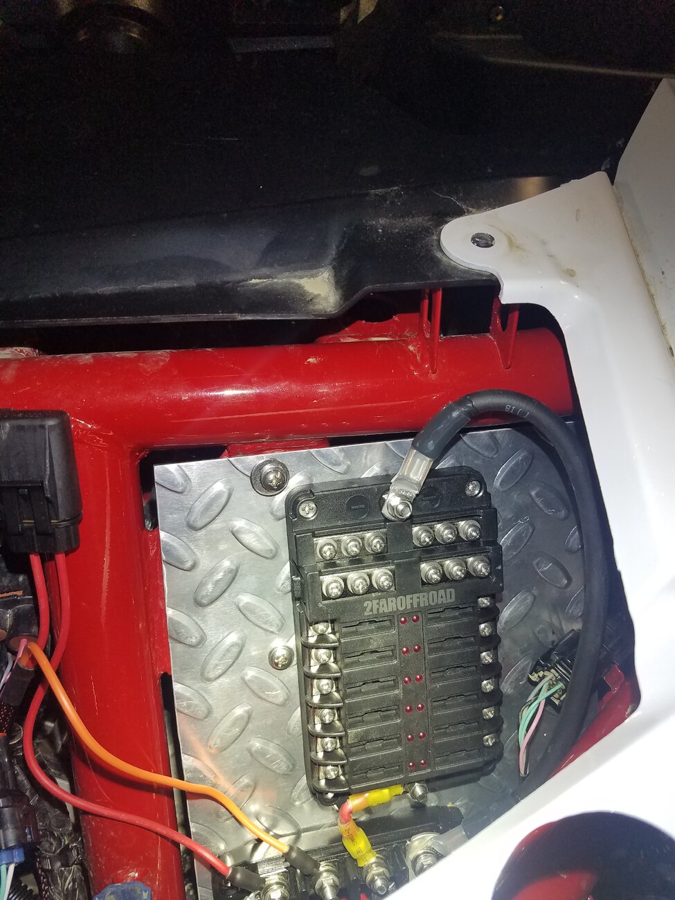

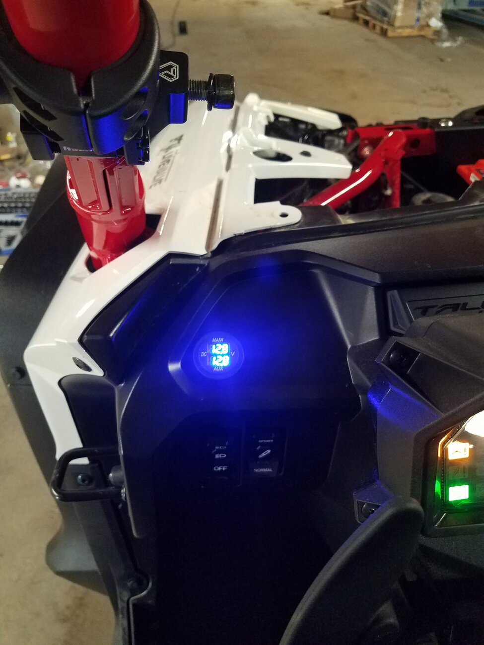

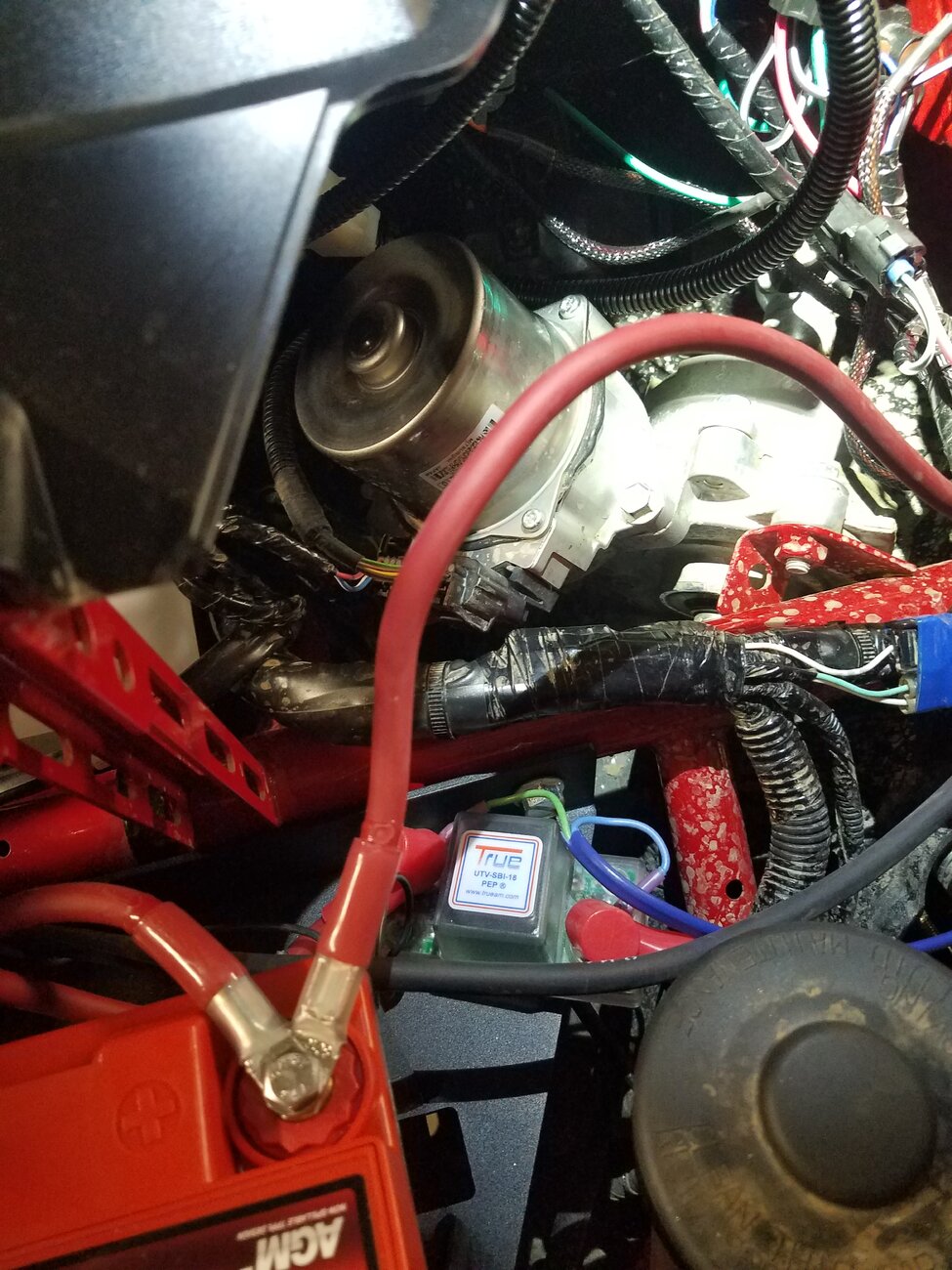

I installed a 2nd battery with True Isolator kit and fuse box from the SXS store. I also used the Honda Talon Under Hood “Keyed On” 40AMP Power Bus Bar- By TurnPro. I got a small piece of diamond plate to mount everything. My electrical skills are not great, but with a little help from this forum I was able to wire it up pretty easily. A big thank you to everyone who offered advice and took the time to draw up wiring diagrams for me. They were all helpful but this one in particular made my life much easier.
Untitled Diagramdrawio 20240928 202445 20240929 112909 20240929 112921 20240930 172945 20240930 173147
View attachment 445513 View attachment 445514 View attachment 445515 View attachment 445516
nice work
