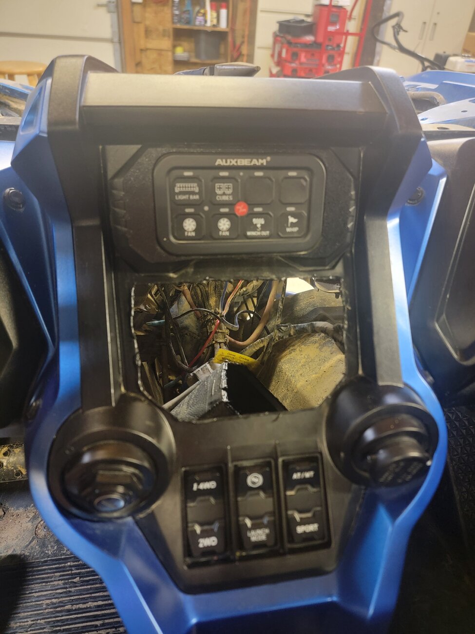

Began the long install of the Rugged Radios setup for the Talon.
Hood, upper cowl panel, and full glass windshield removed to facilitate the installation and wiring.

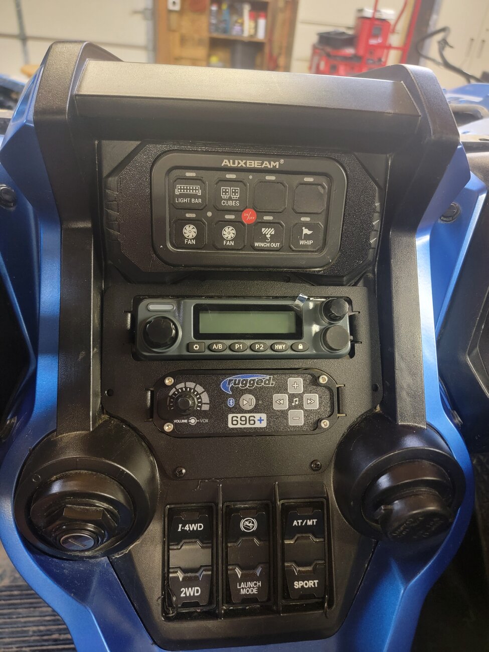

Mounting the 696+ intercom and G1 GMRS radio into the Talon mount:
2024 07 17 202828
Using a hot knife to cut the plastic is FAR cleaner and easier than using a Dremel (what I used to trim the GPS tablet mount I installed a while back). This pic is just before I cleaned up the edges with a utility knife:
2024 07 17 194526
Test fitting the radio/intercom setup. The custom Talon mount from RR covers up everything nicely:

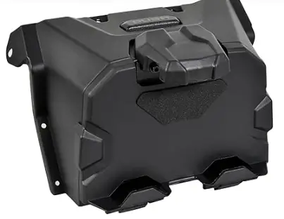

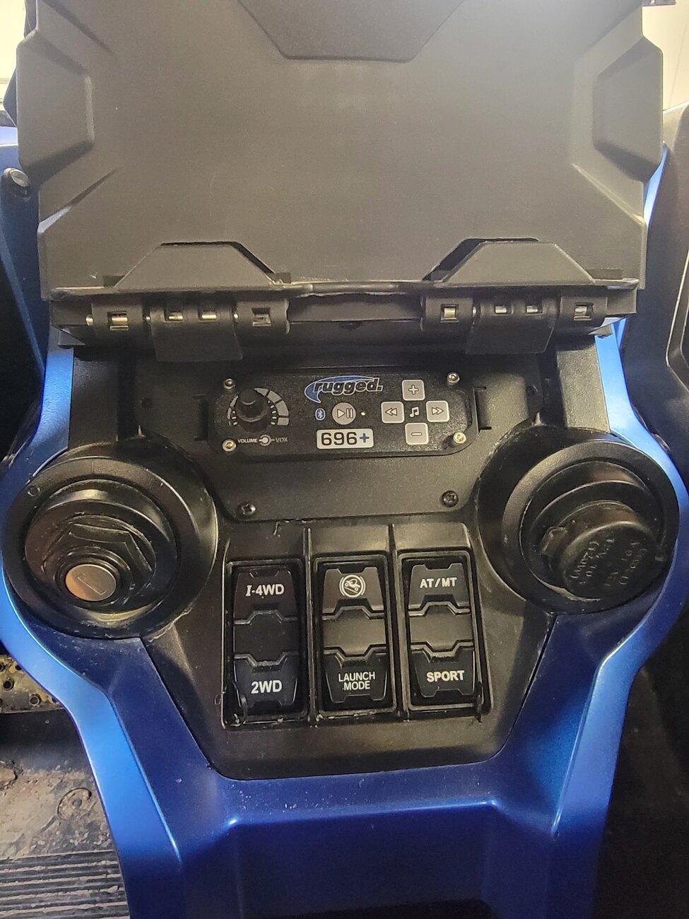

I had to recut the GPS tablet mount that I picked up from Amazon last fall so that the bottom edge did not hit the G1 radio once I reinstalled the mount. Essentially, the entire back panel is gone:
2024 07 17 202506
1721313244597
The only thing I was worried about was that bottom edge of the tablet mount. I was worried that it would line up right in front of either the intercom or the G1 radio. Luckily, that bottom edge falls exactly in between the two devices. The intercom will be fully accessible without opening the mount cubby, and the GMRS radio will be accessible simply by flipping the door open.
I like it this way because, once I set the channel we're going to be on, I won't typically need to access it for the rest of the ride/day. There is a separate on/off switch for the entire comms system that will be installing. This way, I don't have to re-adjust the volume every time we get in (volume knob on radio powers radio on/off):
2024 07 17 202306 2024 07 17 202322
So if you happen to run one of these GPS tablet mounts and were wondering if the Rugged Radios Talon mount for the intercom and radio will work together without to much effort ... the answer is 'yes'.
View attachment 437453 View attachment 437456
View attachment 437454 View attachment 437455

I had to remove the cubby to make way for the radio/intercom combo, so I had to relocate my dual voltmeter and USB power outlets.
