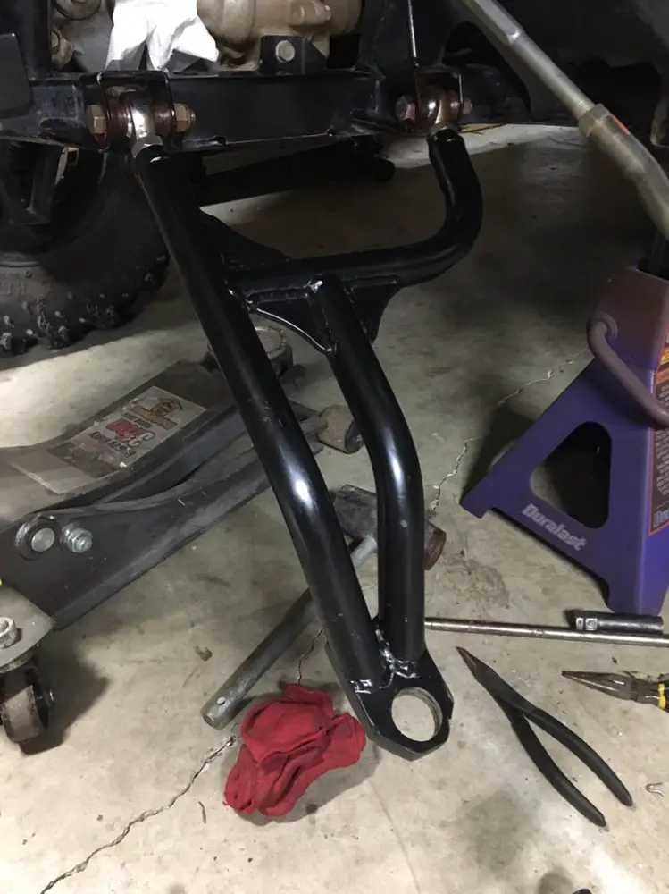

Can anyone definitively tell me what a-arms these are? I bought a used P1k-5 and the boots on my ball joints are shot. I bought new Honda OEM ball joints but they are not the right fit. I assume these take a special ball joint but I don’t know which. Let me know if you recognize these arms. 07cf582b76de0f23fa17b6356d6c40fd2ab6c43f89220b6e066749476d4881d5

Can anyone definitively tell me what a-arms these are? I bought a used P1k-5 and the boots on my ball joints are shot. I bought new Honda OEM ball joints but they are not the right fit. I assume these take a special ball joint but I don’t know which. Let me know if you recognize these arms.View attachment 132694View attachment 132695
Only to a arms that have heims joints i know of are C-Fab and Catvos.
Reactions: sharp, BWAF and JTW
39,130
Those are CATVOS. I love the front arms.

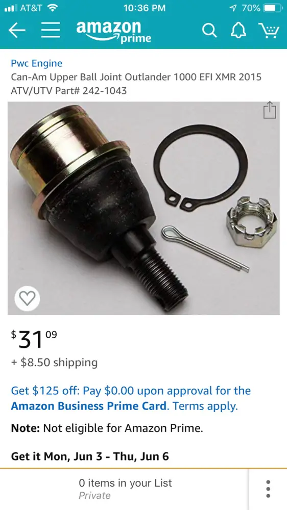

It takes a CanAm joint and a Honda Joint. When I’m back in the shop tomorrow I’ll send you the info on which one is lower and upper.

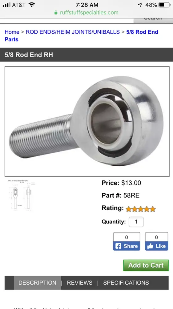

Get a better HEIM joint like Ruffstuff because the stock ones that CATVOS uses are junk.
Here’s an Amazon item I found in my past orders. This is the CanAm ball joint you can buy.

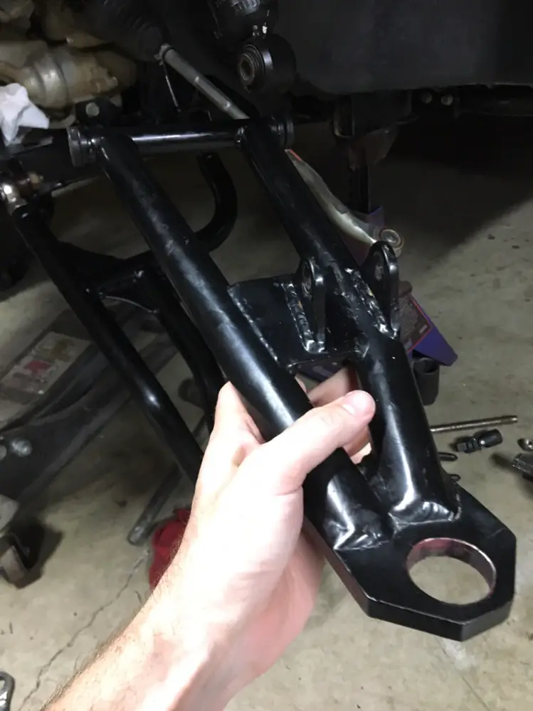

They did that so they don’t have to make so many different outers for the a-arms. That big hunk of steel at the end is a common part for them and it’s welded to many arms for different brands of SXSs.

Here’s the part number for the joint. Don’t forget the jam nuts. These are reliable and cheap. You could find better and more expensive but I wouldn’t worry with it. The CATVOS heims would last me about 300 miles. These are coming up on 1000 and still good.

The Can-Am ball joint that I referenced above is for the lower a-arm. The upper a-arm uses a Honda OEM upper a arm ball joint.
So, for my front and rears, do I need 8 in total? Are they all RH?

This is getting interesting....I emailed those pictures to CATVOS to confirm before I ordered the wrong parts again. They're telling me those are not their a-arms. What the heck?
They did say that they look really similar but there are several distinct differences. I'm wondering if maybe their design has changed and these are new guys that don't recognize the old design.

It is their arms. I have their older design as well. They did not sell many of them before making some changes.
I wouldn’t worry about talking with them much. The only thing you need is to know where to get replacement joints for each end and you should be good to go forever.
I have talked to them about the bushings they use in the upper a arm. I have not sourced those from another company. So if you need that you will need to contact them.
Here’s a picture of the arms when I was installing them:

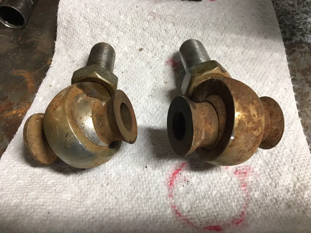

Gotcha. Man, I wish the last guy had taken as good of care of these as you obviously do. They’re so rough. No grease anywhere and dirty as can be. I managed to pull the sleeve and bushings out but it was a beating.
Surely I can get at least another 1k miles out of these

Big thanks to @joeymt33 for all his wise input. I got it all back together and took it for a spin yesterday evening. It’s buttery smooth now with zero noise. I love it. What a difference those new joints make.
