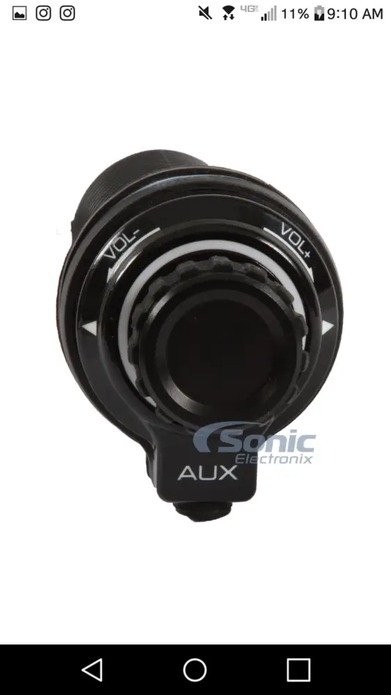

I got this sweet little Hifonics tps-bt1 bluetooth controller for my stereo system im putting in my pioneer 1000. I won't be putting it in for a few weeks. And I'm wondering what it controls and does it have an on/off or source function.
It says it has a "skip" function. I ONLY listen to music with Pandora Premium. So will it actually skip a song through my Pandora app? Or do I still have to fumble with my phone for that feature?
Does it have a "source" or on/off function or do I still need a rocker switch? I So,inot believe so but can't find a definite answer. I'm running it direct to 12+power but if it has an on/off function then I can skip the rocker switch.

Do you have a link to the manufacturer? I'm sure the wiring instructions will give us a hint.

No rocker switch needed.
It does look like it needs to be hooked to an amp to operate.

Thank you, thank you. It didn't come with any instructions for some reason. And yes. Im hooking it to an amp. Its been a while since I have done this. Do you know where the blue remote output wire goes to?

Run it to the amp with your rca's. It is the signal that turns on the amp.
Amp will have 12v+, ground, and remote in. Blue goes to remote in.
Hook up rca's, speaker wires and you should be good to go.

Great. So helpful. I read that on the photo you posted but I didn't understand it. Its been 20yrs since ive hooked up anything like this.
