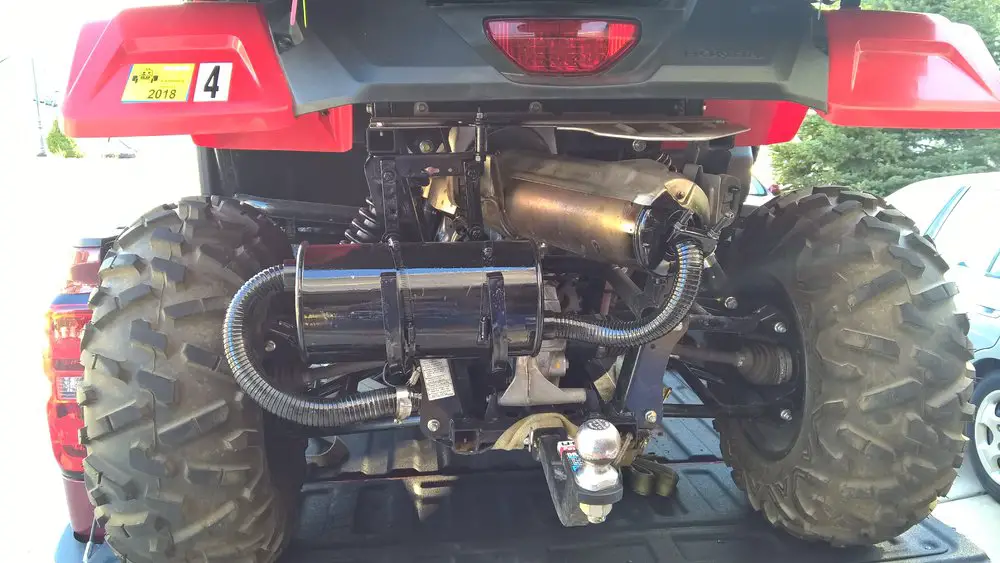

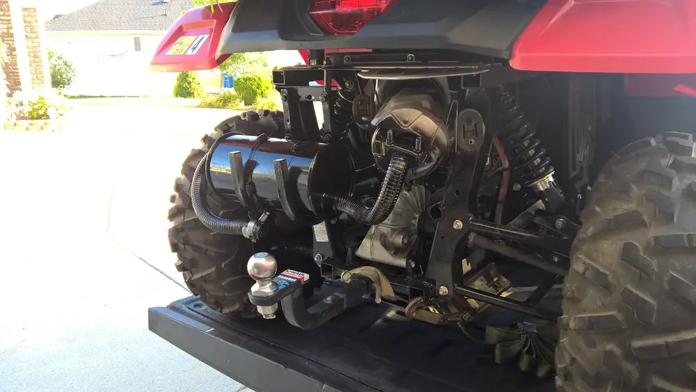

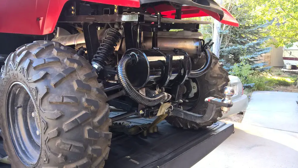

Walker Muffler, some flex pipe and ladder hooks & some scrounged up hardware yields a very quiet P500. Total spent in parts house was $38.00. At idle about 1/3 as loud, at full throttle maybe 1/2 as loud as stock. Really kills the pop-pop-pop noise typical of a single cylinder engine. The archery hunt is almost here!!! Did the project with the P5 sitting in the back of my GMC Dually so I didn't have to bend over doing the work. Much easier. One more coat of black paint and I'm done!!!

Walker SFX Muffler # 18424
Flex Pipe is 1 1/4" OD # 40001 - I used 2' of it
I shortened the inlet & outlet of the muffler a bit over an inch each. Then I slit and cut the cut off pieces about 1/4", rolled them smaller, and used them as bushings to make the flex pipe a snug fit into the muffler. Put a baby tack weld at muffler entry and exit just to keep flex from walking out if it tried. I put a bit of RTV in the edge of the flex pipe where it clamped to the muffler to fill the holes where the flex wrinkled since I was clamping 1 1/4" down to 1 1/8"(Muffler OD). I hope this helps!

After 350 tough miles on a month long archery hunt in the Utah mountains....Worked perfectly. No power issues. VERY QUIET-the deer would let me ride right by them without spooking. My friends could not hear me coming-could sneak right up on them....Nothing came loose or vibrated...Verdict: Successful Project if quiet is your game!!!

I have a trailer ball on a receiver insert in the 1 1/2" frame hole as you can see. It sticks out plenty to protect the muffler and very rarely does the insert touch any obstacle or anything else when off roading. Also, if something were to hit the muffler (assuming no trailer insert) it would have already hit the rear rack, both fenders and the top center cover. Just my $0.02

All I have done in 4 years is replace the flex pipe 2 times for $20 total due to normal flexing wear but at least the extra muffler is not hanging on the oem muffler and the head studs. Any RTV works but the hi temp red fits the usage best. Even the flex does not hit ANYTHING!!! If you will snorkle the airbox inlet pipe and run it up to the roof the interior noise will go waaaay down as well. I use a real primary air filter up there and it helps protect my regular air filter from the really dusty riding days. Shop vac 2 1/2" hose kit $20 @ Lowes) works for this - connect to airbox pipe with a "Fernco" coupler. The plumbing section knows what they are. Seal all joints with Sikaflex urethane caulking.(Lowes also).

I cut the intake pipe just downstream from the resonator. The fernco may have had 2 different sizes. Measure the pipe where the cut is to be made. I suspect it is 2"m OD-if so you'd need a 2" x 2.5" fernco. Be sure to assemble the intake using liberal amounts of sikafIex. I described how I connected the flex pipe in detail - please read it carefully again.
