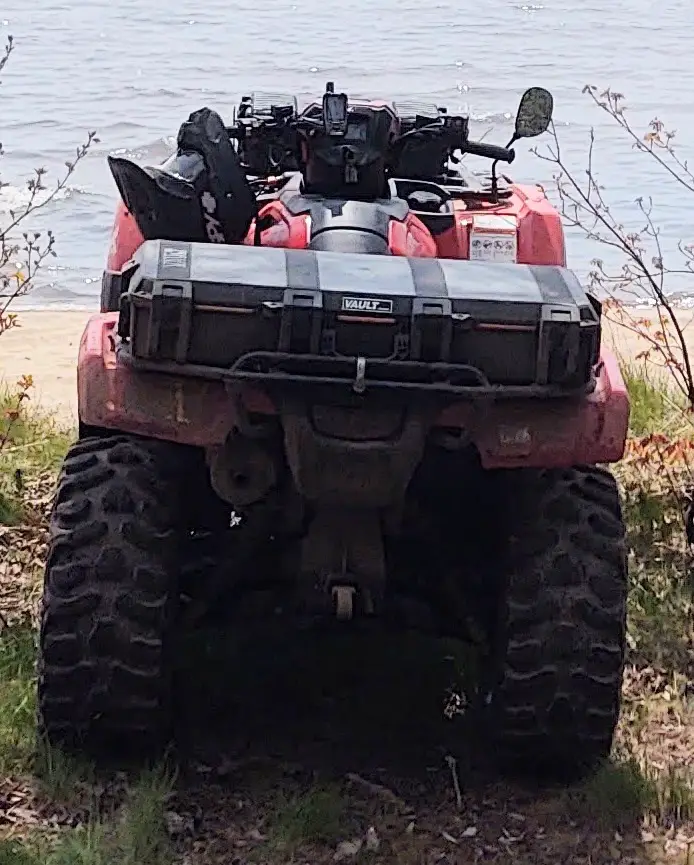

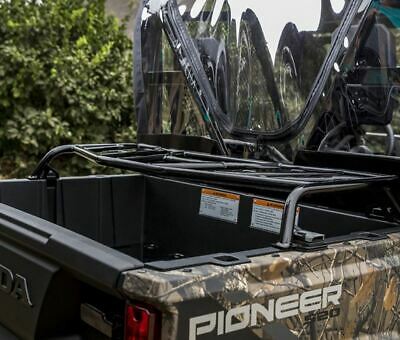

Has anyone ordered or installed the Honda bed rack? (pic below). Or, does anyone have any idea what the dimensions of it are. I would like to mount the same box that I use on my Honda Rubicon but it’s an expensive trial and error. Thanks for your help.

Mine came in yesterday. The width is 40.5 inches and the depth is 14 inches. It’s expensive for what it is but I’m happy with it. It’s rated to hold up to 100lbs.
