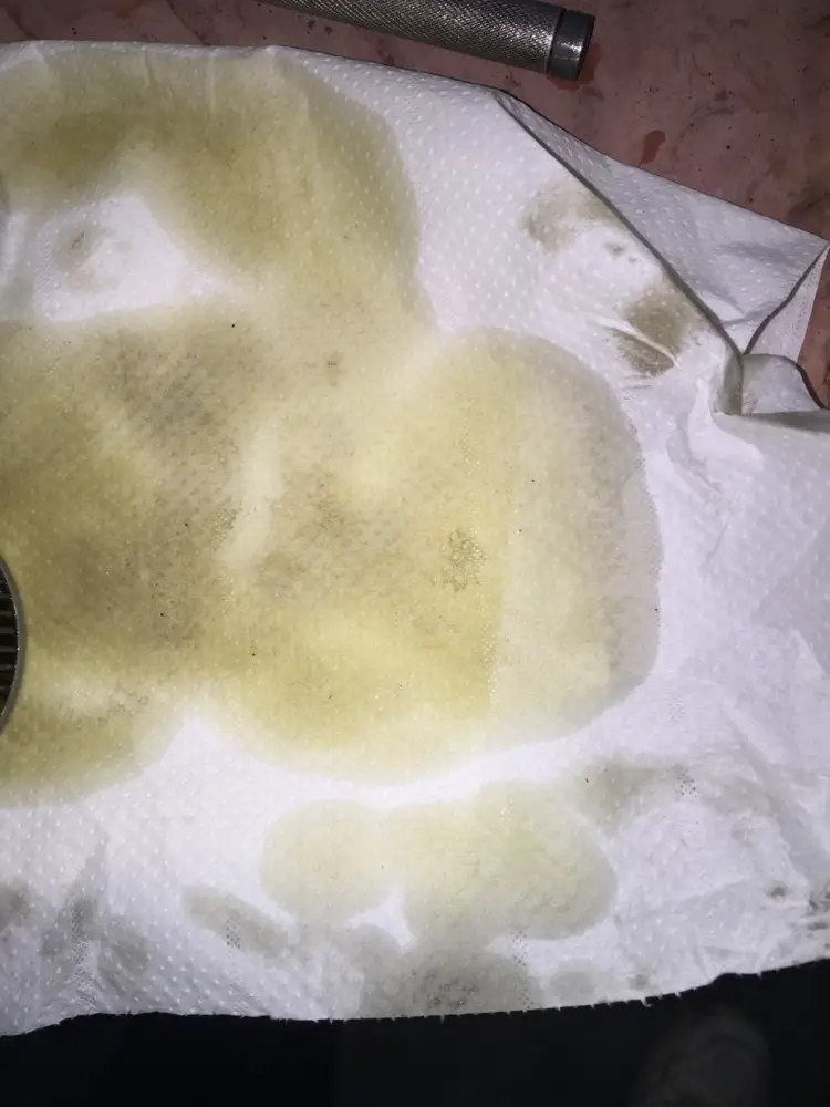

I was just curious cause I changed my oil and it looks dark in a clear glass but looks great on a paper towel

oil on left is out of my machine just over 100 miles looks clean in towel looks dirty in glass on the right is new honda synthetic
Thats how mine looked too. I think its just a result of the break-in - not special oil they put in.
