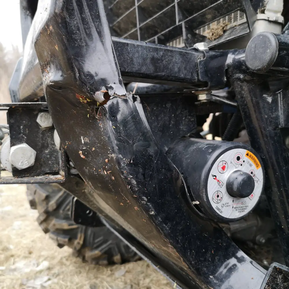

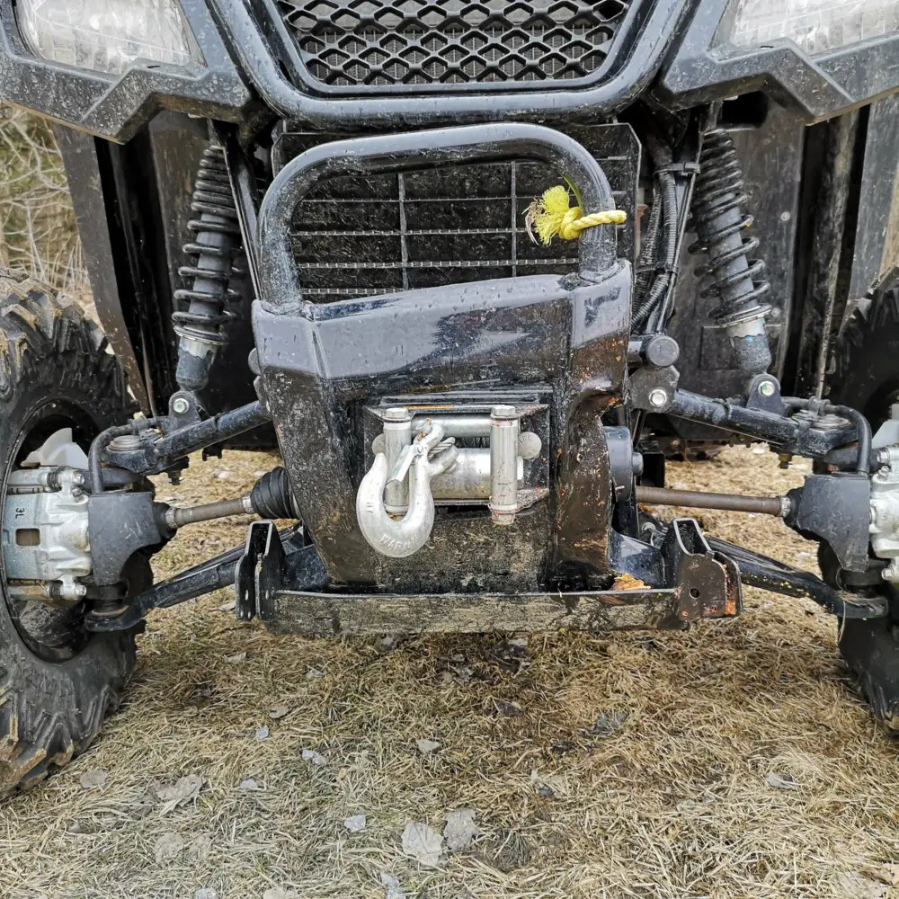

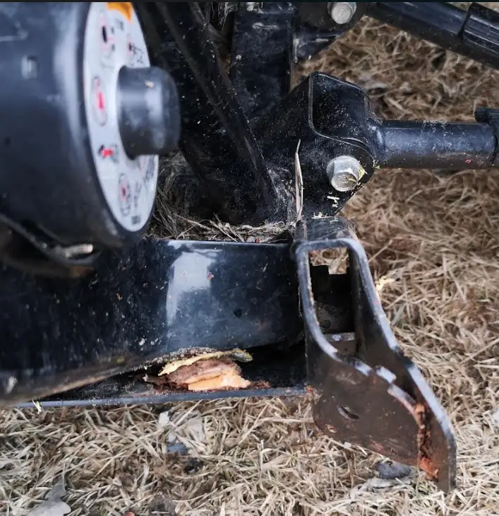

Hello,
Today I lost control going around a corner and smoked a tree pretty good. I have broken my bumper and damaged my plow mount. I have the following questions and would appreciate any input.
Can I repair this bumper? I can get it to a welder (its torn on the side ) but how will I bend it back in to place etc...
If I replace the bumper, what models are compatible with a front mount warn plow and warn winch?
I should have no issues bending the forks from the plow back but do you have any tips?
Lastly, should I be inspecting other parts for damage considering the attached photos?

The bumper is toast. They can be had all day, I have one sitting in the garage now. The plow bracket took a hit but probably saved other stuff from getting bashed. I'd use a torch, heat, bang, pry and torque it back to straight.
This ^^^^
Replace the bumper, it's not worth messing with. I'd pull the plow bracket, stick it in a vise and heat with a torch to straighten. If you don't have access to torches find a welder or auto repair shop and have them straighten it out. Clean it up and repaint when done.

Decent 'minor' hit. Once all the damaged pieces are off inspect closely. If it was still tracking correctly on the ride home your probably fine. Winch mount adds rigidity to the front which may have helped. Was more curious if you were wearing seatbelts and whether they actually worked at whatever speed you were going???
