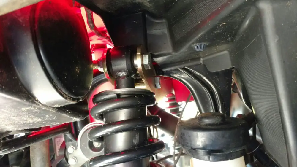

I'll be the first to admit I see no real benefit to the increased clearance. I smashed the crap out of my skid this weekend. The real advantage is the improved ride quality. My thinking is the plates securing the 2 shock mounts together up front is what's helping. Wouldn't be hard at all to fab up those supports minus the lift. I know I could tell the difference with the strut tower braces on my old SRT4. Same principle. Ties them together but still leaves each corner independent as far as suspension goes.
plates securing the shock mounts together??? is this an aftermarket part that I'm not aware of?
The HL lift kit braces the shock mounts together on the front. And it reinforces the mounting points on the rear.
man, it might be worth ordering that kit just for the reinforcements... I'm ordering the Walker Evans shocks for all 4 corners later this week and may want to install these high lifter reinforcements at the same time... I WANT TO GO FAST RICKY BOBBY!!!lol
