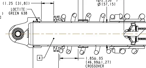

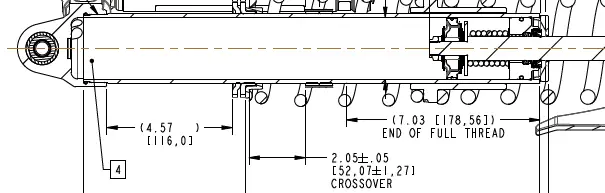

@PaulF
Could you share the specs for the R? I e-mailed them a few days ago and haven't heard anything back.
Front...

Rear...
