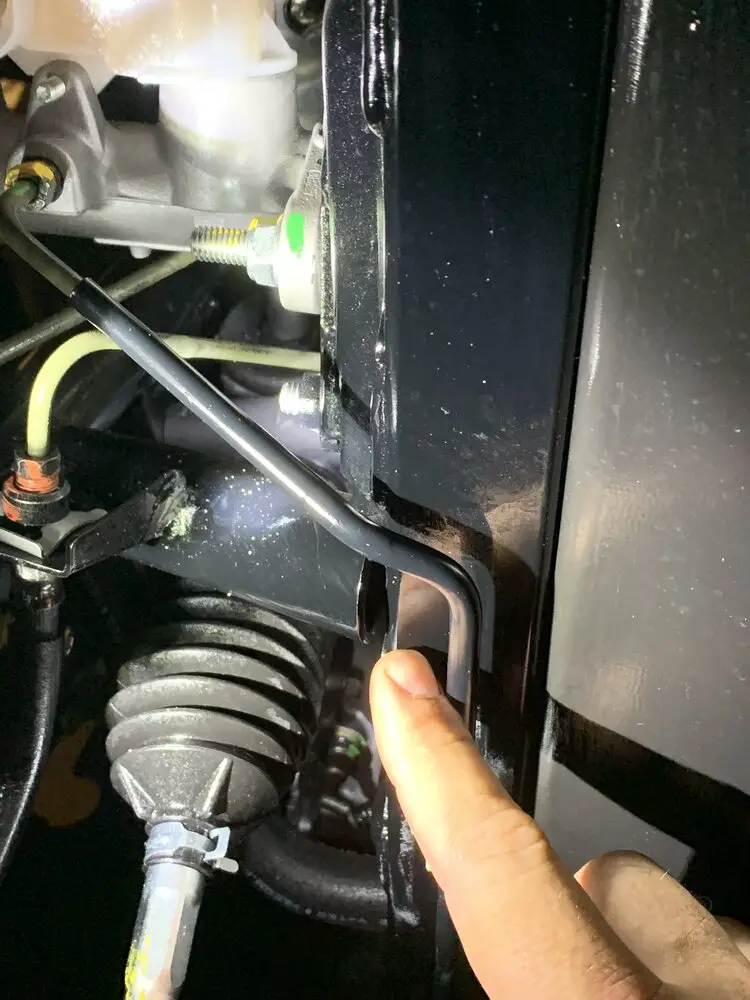

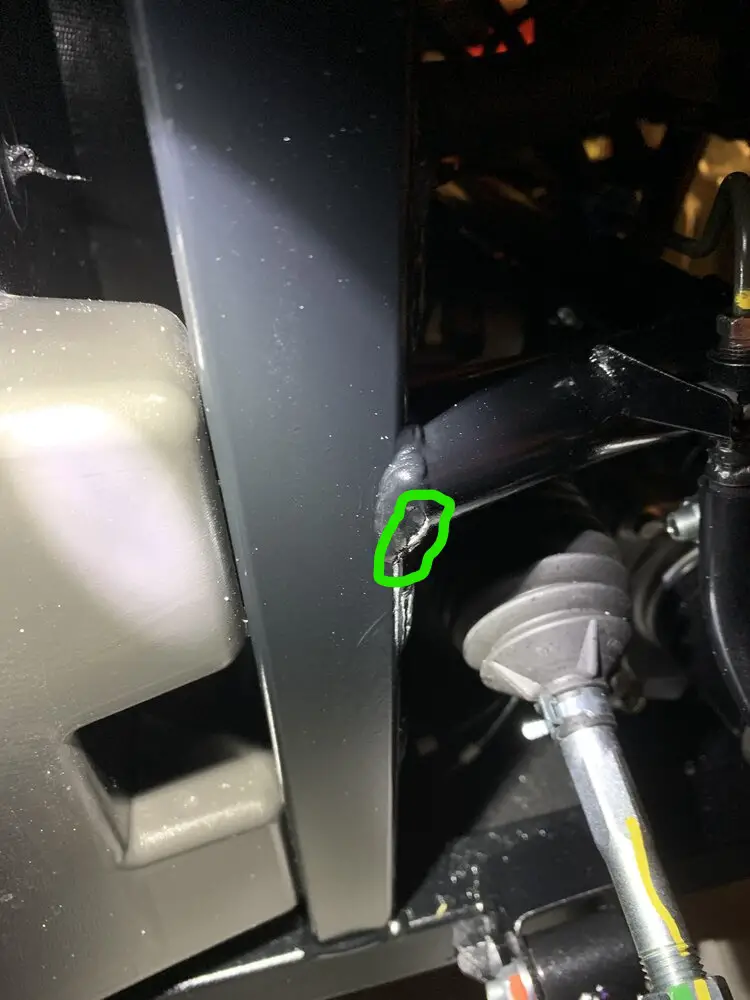

2020 500. Just got it two weeks ago. Drivers side frame where the upper control arms bolts up looks like there is a weld missing?? The other side is welded all the way around. Drivers side is just barely welded on top of the tube leaving a huge open gap. How are y’alls??View attachment 232363
Is it bent also?
35,445
208,731
Thanks. Dealer is sending pics to Honda. We’ll see. I can this being a long process. Have about three miles on it 🤦🏻‍♂️🤦🏻‍♂️
I bet Honda issues a stop ride on your buggy? I wouldn't be surprised if they don't replace the frame?
Mines welded both sides. I don’t see why it wouldn’t be. That certainly don’t look structurally sound.
Good luck with the dealer and Honda.
I really don’t want a new frame. I don’t trust anyone to get it all back together as it was from the factory. In the perfect world I’d get a new unit. But doubt that’ll happen. Sad to say but wish I had forked the extra money for Can Am Trail 800

Make sure you check the other side really good with a flashlight. You may have something more major wrong. It could be a shadow or dirt line, but that looks cracked to me.

Dealer is coming to pick it up tomorrow. They are 2.5 hours away so good on them. Honda already said they want to swap the frame or send a welder. I don’t “want” either. We shall see.
I'd take a SKILLED welder l-o-o-o-o-o-o-o-n-g before I'd want a frame replacement. I just got my outfitted Talon back from the dealer and the craftsmanship is sadly lacking. :oops: I'd never trust anyone with a frame replacement, too many places for things to go wrong.

Well after a week and a half they decided they want to.......give me the option of frame replacement or weld it. Told them I’m not happy with that and I want neither. Never should have left the factory this way. They made two mistakes, not welding it and QA not catching it and I will be the one taking the hit caused by their mistake. I’m not rolling over that easy. The saga continues.
