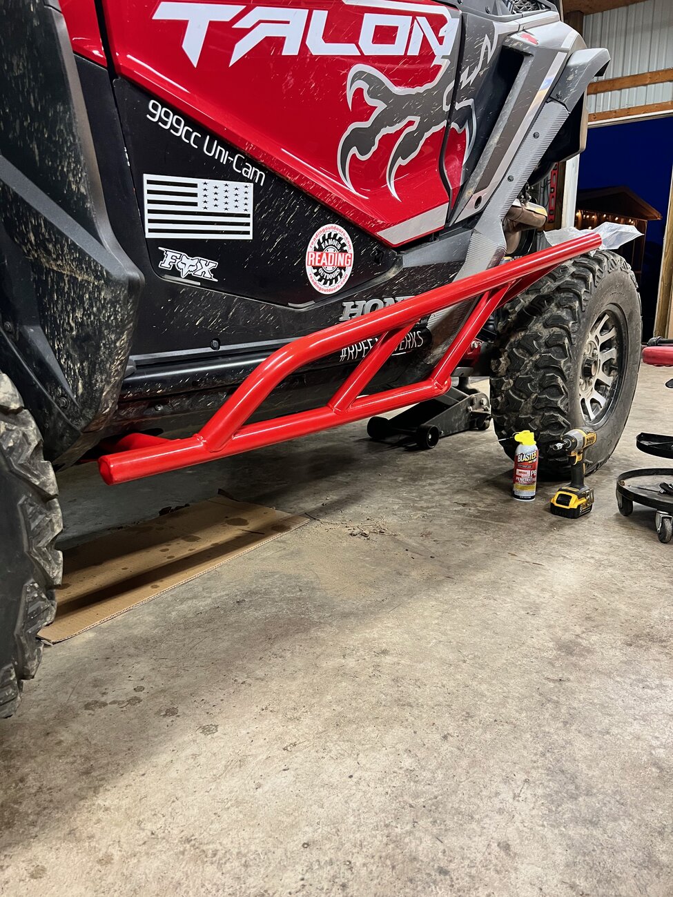

im pretty confident my homemade tree kickers can support a lift - overbuilt .120"x1.75"........lol

im pretty confident my homemade tree kickers can support a lift - overbuilt .120"x1.75"........lolView attachment 372682
Yes sir! Yours are built like tank bars. No issues there fo sho!

Those tree kickers look awesome
