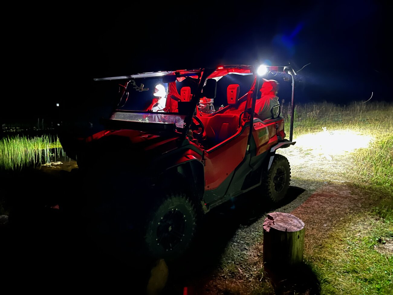

When I did my second battery and accessory lighting installs, I installed led strips on the center overhead roll bar, one facing the front seat and one facing the bed or rear seats if they are flipped up. Wanted to have "dome and cargo" lighting. They are actually super handy. I also put red led strips in the front footwell area and on the diagonal brace bars in front of the rear seats. Sort of like interior lighting. I'll see if I can get some pics here. Cant help with the plug and harness question, mines a 2020....

I used cheap strip lights from Amazon. They work ok so far. 2strips in front and 2 in rear. These plug into a USB for power and mine is plugged into my amp which is overhead.
Thanks for sharing. I had read that colored lighting is easier on the eyes while providing illumination. Hmmmm?
