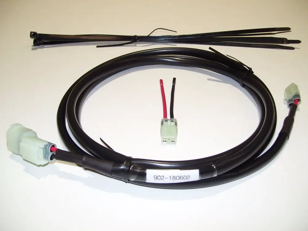

StratosMicro here, we are a supporting Vendor and we do sell a turn key harness kit for the Pioneer 1000. This kit is designed just for the back up light install without needing to splice or hunt for the proper connectors.
Follow the link to our eBay store listing: HONDA PIONEER 1000 3P/5P, ACC OR BACKUP LIGHT WIRING HARNESS, 6 FT, PLUG & PLAY | eBay

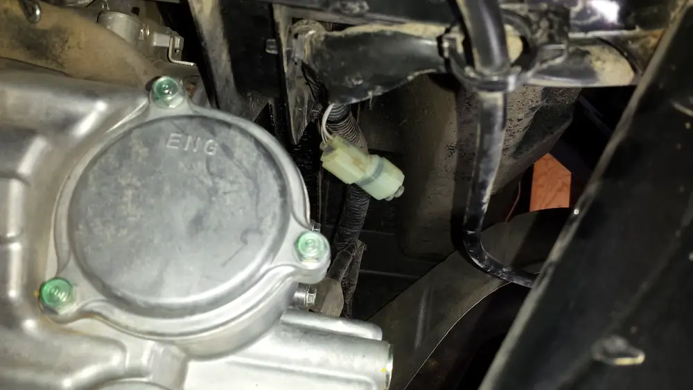

Ken, I am not sure which clip you are referring to. If you are talking about the filler plug located at the rear of the engine (see attachment) simply lift up the ear to the female connector and pull the filler straight out.

No, the clip we're referring to is on the main wiring harness immediately after the fuse box
