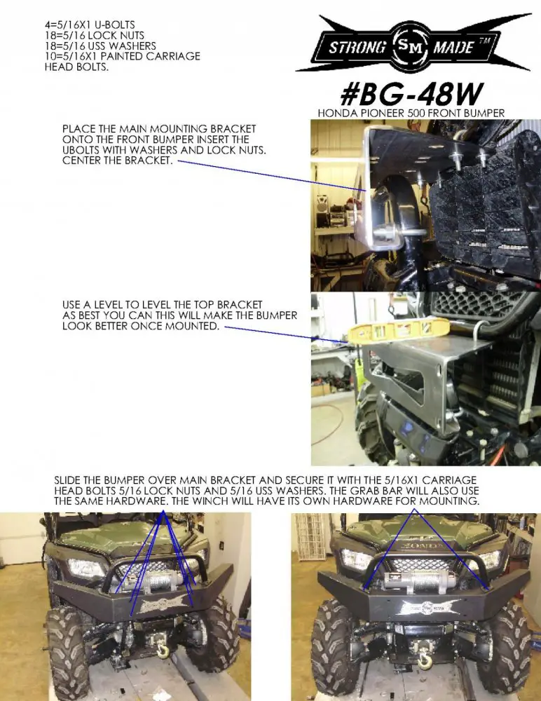

Sure do, KFI3500 winch on Strong Made Bumper you will need longer bolts to go through the 3 layers of steel before it screws into the winch base. (Top Pic)
However you can buy the HONDA Winch mount kit and it will mount down low on the OEM bumper opening. Like the bottom Pic (Not Mine)

Removed... Wrong info.
But see instructions.

UPDATE...
No, the Strong Made front bumper for the Pioneer 500 will NOT work with the KFI mount as it comes.
See. Also refer to StrongMade instructions above.
