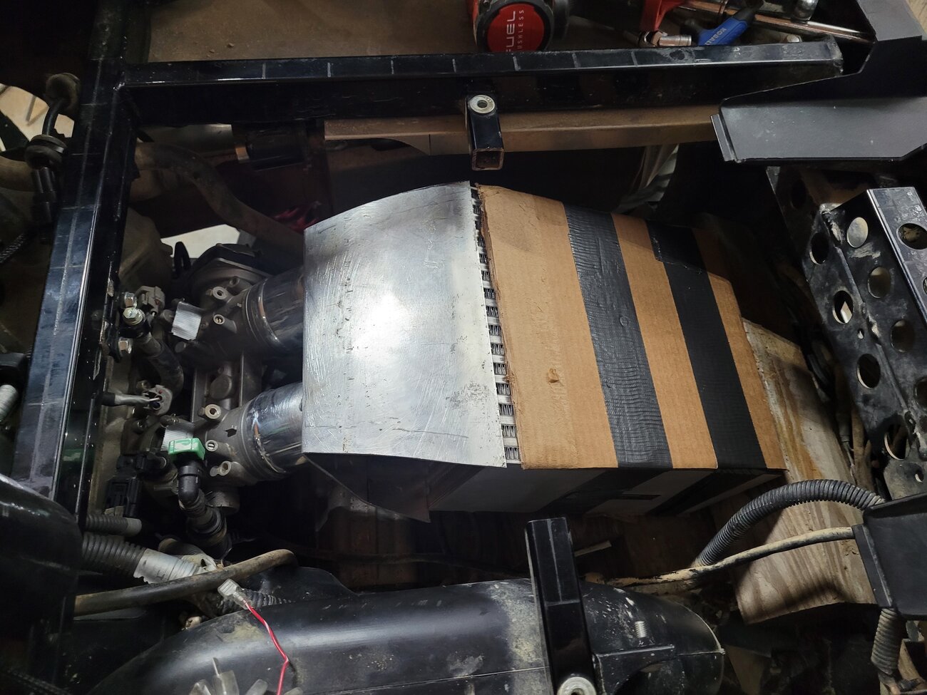

Same thing I was thinking. What the eff you doing over there @snuffnwhisky?? You should be about done with that bottle by now and have that thing together!
I'm like a drunk cat with someone with a laser pointer. Got to many projects to do to it haha.

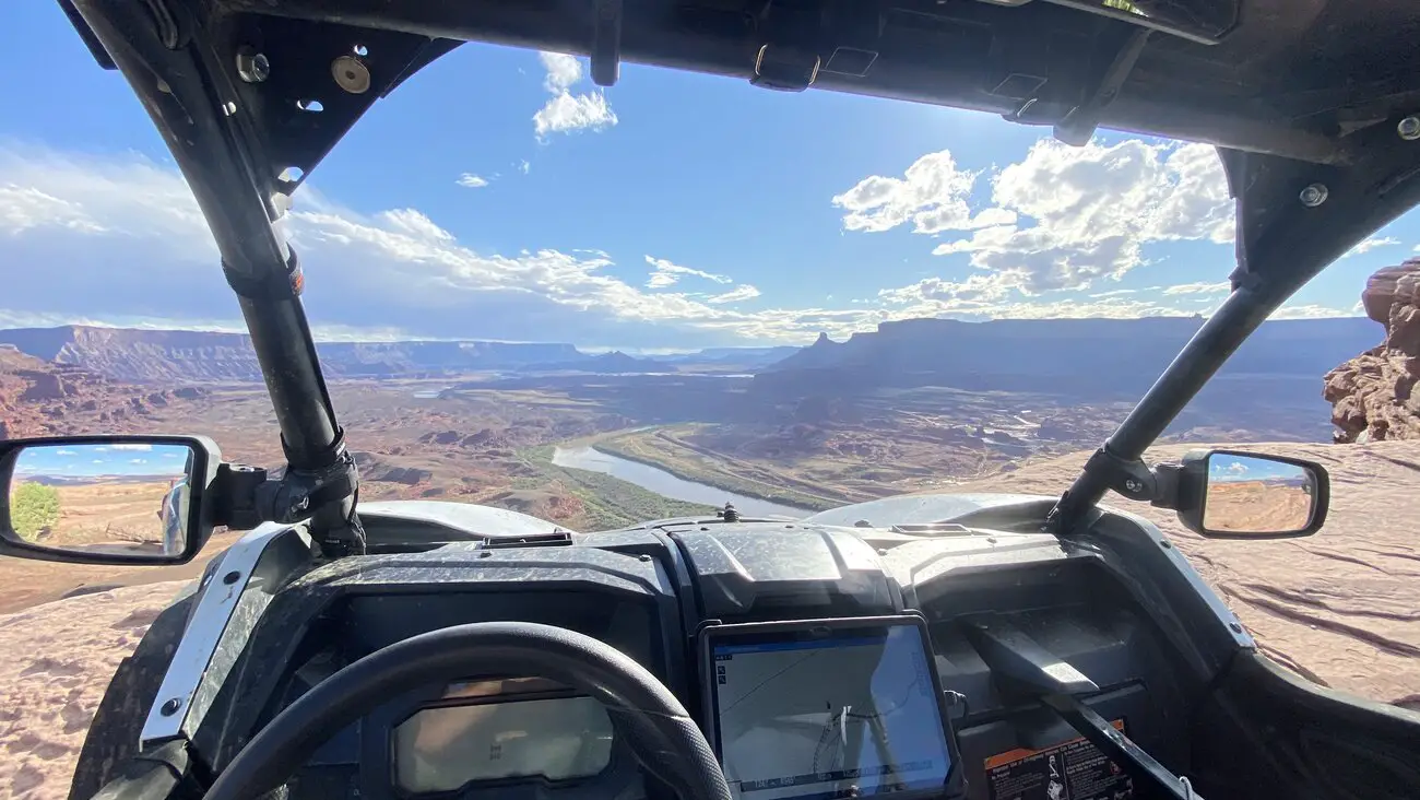

Ok.. so a quick update on miles and issues. (This is JTW for you queers that don’t know)
I had a lot of comments about the “rubber band machine” and “wait until you get some miles on that KRX, and tell us how good it is”.
So... here I am telling all.
3000 miles now in a year and a half and I haven’t had to do anything up until this point. I’ve honestly been tickled with it.
*Bushings were just replaced with Garage products $170
*inner tie rods were shot which caused some bushing wear in the rack (the stock boots allow water intrusion wearing the inner ball) $40
*steering rack has taken a beating with the 35’s and it’s still pushing on, however I’m replacing bushings and doing a rebuild kit in it $130 (kit comes with better softer boots, I would suggest this from new)
*Couple flat tires
*Finally broke the drive shaft.. I was honestly expecting that long before now. Kilo had a spare from his machine.
*The aftermarket dalton clutch weights are junk. Like seriously not impressed at all with them. Don’t buy them!!
*slight oil seep around the shift-linkage (needs a new o-ring I’m guessing)
Outside of the hand full of items above, I don’t think I’m missing anything. Changed plugs and oils a few times... other than that she’s been really good to me for what I’ve put her through. I’ve had ZERO issues with the belt. Low is amazing in these things. Waiting for the updated clutch from Kawi to address the weight grooving issue. I’m told it’s in the works and should be soon. I had 2000+ miles on the stock weights and decided to go with the daltons as a “preventative” measure and that was a bad choice as they grooved in less than 1000. Poor metallurgy is my theory.
So, that about sums it up. I haven’t had to wrench at all on it up until recently. It’s been amazing just riding and washing it. I’ve added and changed a few accessories and setups. I’m now running headsets which was absolutely amazing in Moab this trip. I’m still glad I considered a KRX! It’s really been nothing short of awesome and I’ve had more fun in it. The ride is fantastic and if you’re looking for a 2 seat machine... this thing should be at the very top of your list!
