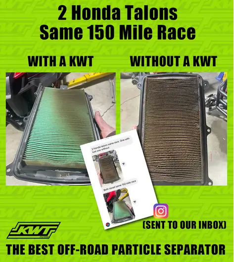

Have you looked into the 10-80 filter setup? @highpocket74
1648736378507
He posted a similar picture to this, side by side. And well, his "with" filter appeared much cleaner than the KWT.
Just a thought. You may have other reasons for the KWT.

I just remember his "with" filter was much cleaner than the one shown.
Found the images.
Screenshot from his website.

I should be getting some more pictures soon after our Texas ride last weekend. It was DUSTY!! I had to run the front as navigator on this trip but by friend Micah was running about 5th or 6th out of 12 bikes. I'm interested in seeing his stock filter conditions while running the pre-filter. We won't have a "with and without" comparison because all 3 Talons were running my pre-filter setup. The third Talon was running in 12th position so I really need pics of that filter, which is think is an R2C. The pre-filters looked fine after the ride. Not even close to being caked up with dust. One benefit of running a dry filter is that a lot of dirt falls off during riding. It doesn't stick like an oiled filter.
I've sold a few of these to guys from Arizona where they tell me 150 miles out of an OEM air filter is great. I"m sure after a few rides they will be posting, good or bad, about my pre-filter. With 44 sold so far, I've yet to hear any complaints about poor results. A large reason for success is simply getting cleaner air from ABOVE the fender in the first place.

Everything is a give and take.
The KWT is easy to clean but, it costs more, doesn't do as good of a job so you will still be replacing OEM filters, can get in the way and I personally think it is ugly.
A prefilter is cheaper, works better (Hondabob has 30K+ miles on his OEM filter) and looks better but is a little more work to maintain.
I built a BVC prefilter knockoff (the one hidden inside the fender) and keep a spare clean filter and outerwear in my trailer for an easy 5 minute swap. Even though it is located in the fender (where the stock snorkel is) I am surprised that it has lasted 500 miles without cleaning so far and 250 of those miles were in Arizona, Nevada and Utah dust. I think it may go up to 1,000 miles between cleanings.
This is coming from someone that used to swear by a particle separator. Although they do work very well, the S&B was always in my line of sight and even it was somewhat ugly to me.
