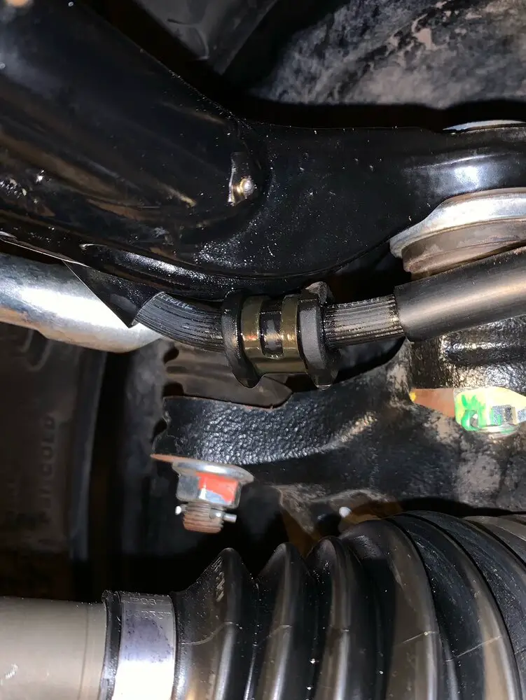

I took my machine for a 10 mile ride a couple weeks ago and then parked it in the garage. Today I noticed a big fluid spot on the floor - on the inside of the front diver's side tire. I haven't had time to pull the wheel and get a better look but it appears like the leak is in the brake line at the spring clamp shown in the center of the attached photo. Anyone else run into this? I have an extended warranty but don't think this is covered.

First I've seen

Mine did same front shock was leaking.

Do the brakes feel spongy or weak?
Warranty should have no problem covering that if it is infact leaking. Doesnt look like anything has hit the line. I havent ever seen any brake line issues, except for wrecks.
