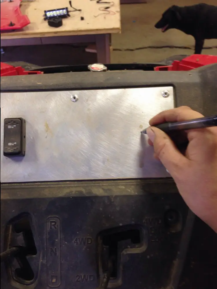

View attachment 6239 First thing was to mark where the switch will go on my switch plate.
I picked up my 700 on friday and have already ordered lights. Can you tell me where you got your switch plate? Excellent location on the light-- that will serve 2 purposes - light and may prevent a stick from getting into the radiator.
Thanks in advance for the help.
PM @mystic1219 here on the forum. fair price and great guy to deal with.
Like Tramgauge said Mystic makes really nice pates, lots of members have them. I made the one you see myself out of 20 gauge aluminum sheet. If you have a rivet gun, Dremel tool (for cutting out switch holes), and a way to cut the plate to size (I think I used a plasma but something as simple as tin snips could work for light ga. Al.) it's pretty easy to do.
