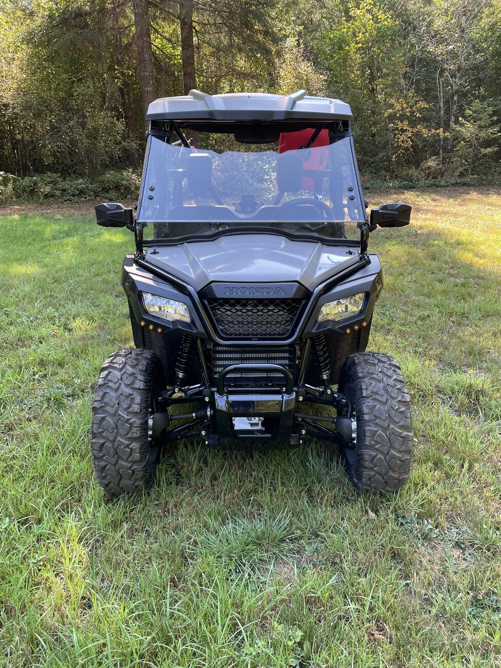

I mounted SUNF 27x9’s on all four corners on mine. They rubbed on the frame until I air’d down to about 6 lbs. I added 1” spacers, which moved the tire away from the frame, but now they “barely”rub the fender. Best fit and ride seems to be around 10 lbs. I should be okay once the tires wear about an 1/8”. In retrospect, I should have only gone up to 26”.View attachment 330707View attachment 330708
That's the spot I was talking about in an earlier post. The slight rub at full turn gets worse when the suspension is compressed. I was tolerant of it too until I had the plow on and was in reverse. It grabbed ahold of my rock slider and bent it downward, then it couldn't be tolerated.
That’s good to know, Trigger. I plan to keep plowing with my 420 Rancher, but I’ll keep a close eye on that fender rub for any adverse effects.

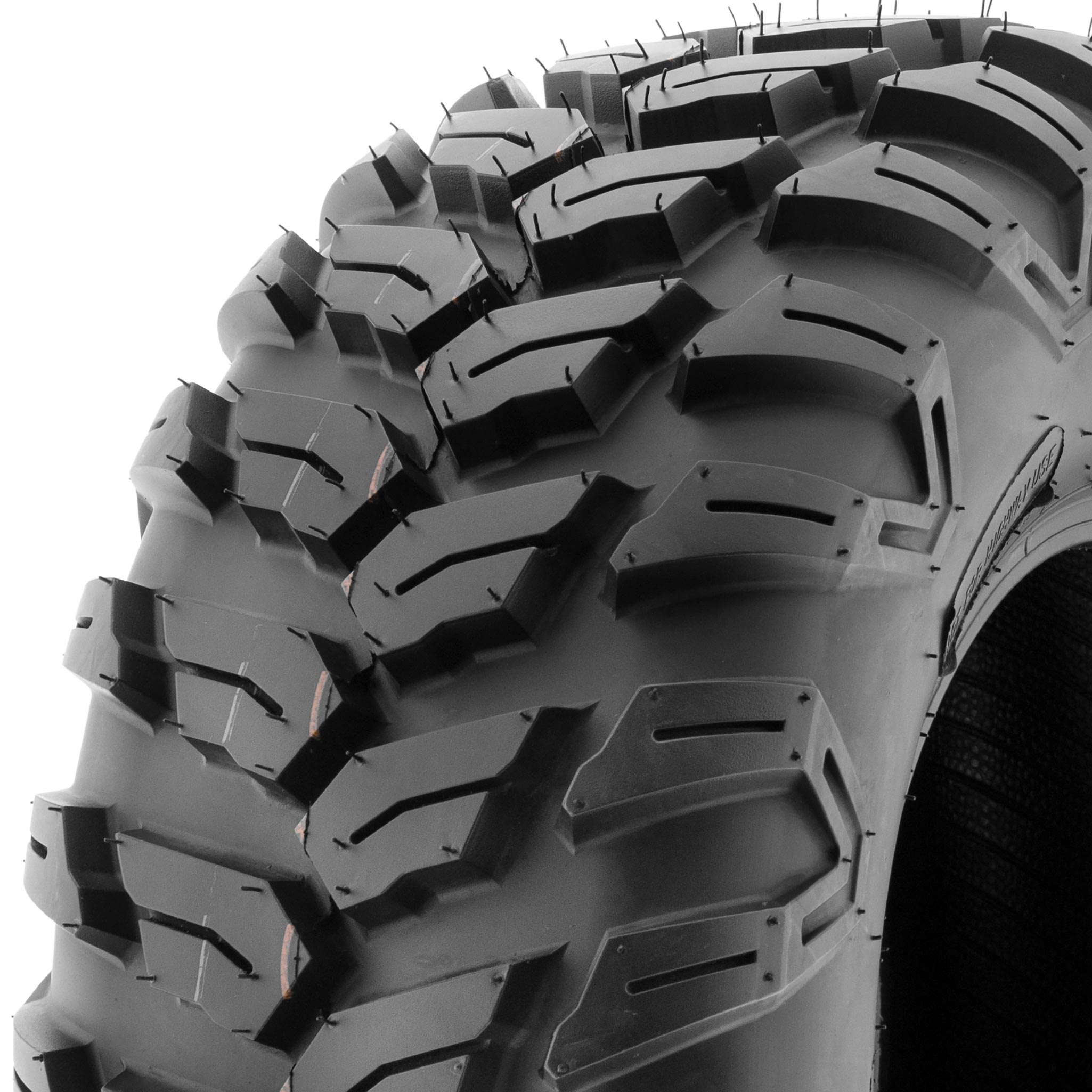

Maybe some aren't but the SunF tires I'm ordering are radials....A similar pattern to Terrabites...I had these on a atv and they were awesome for both pavement and offroad.
