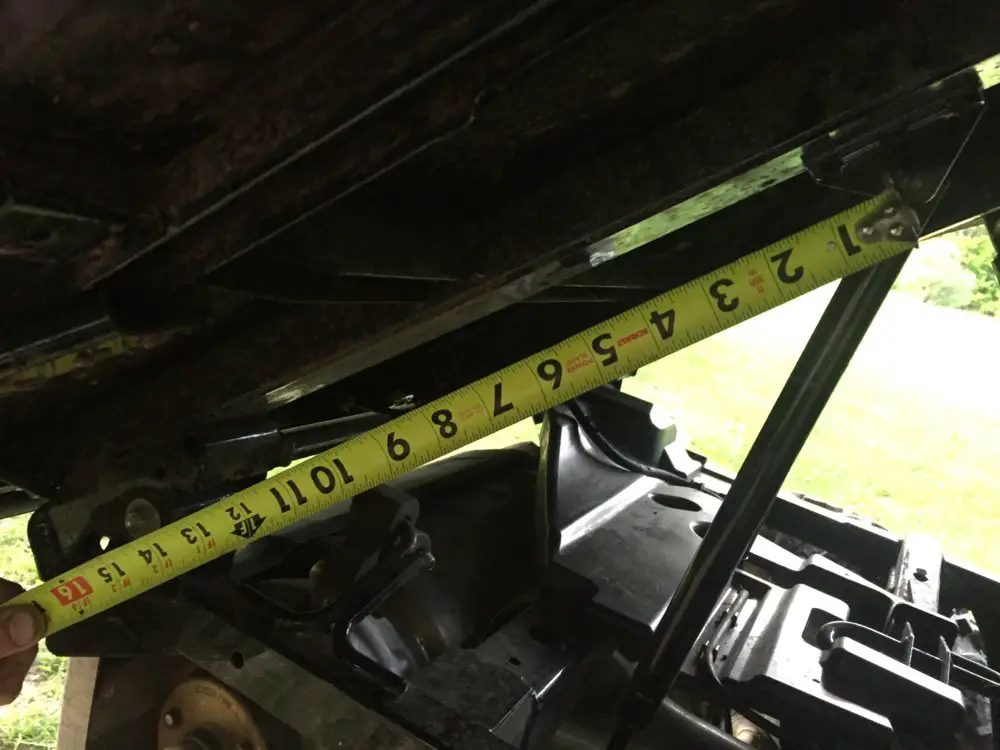

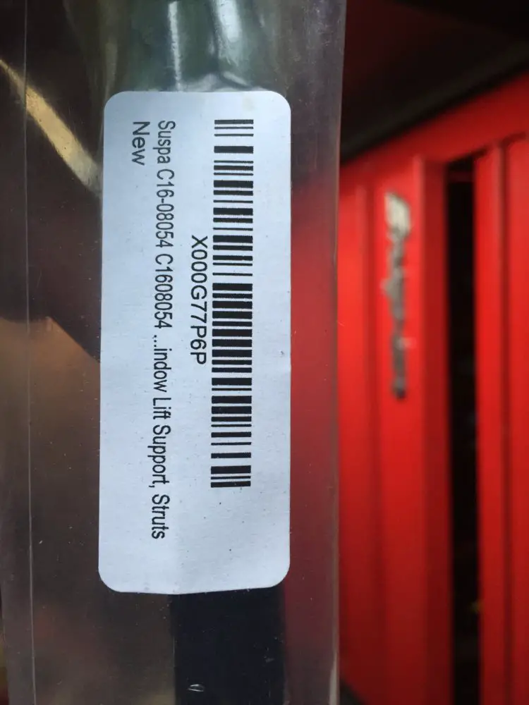

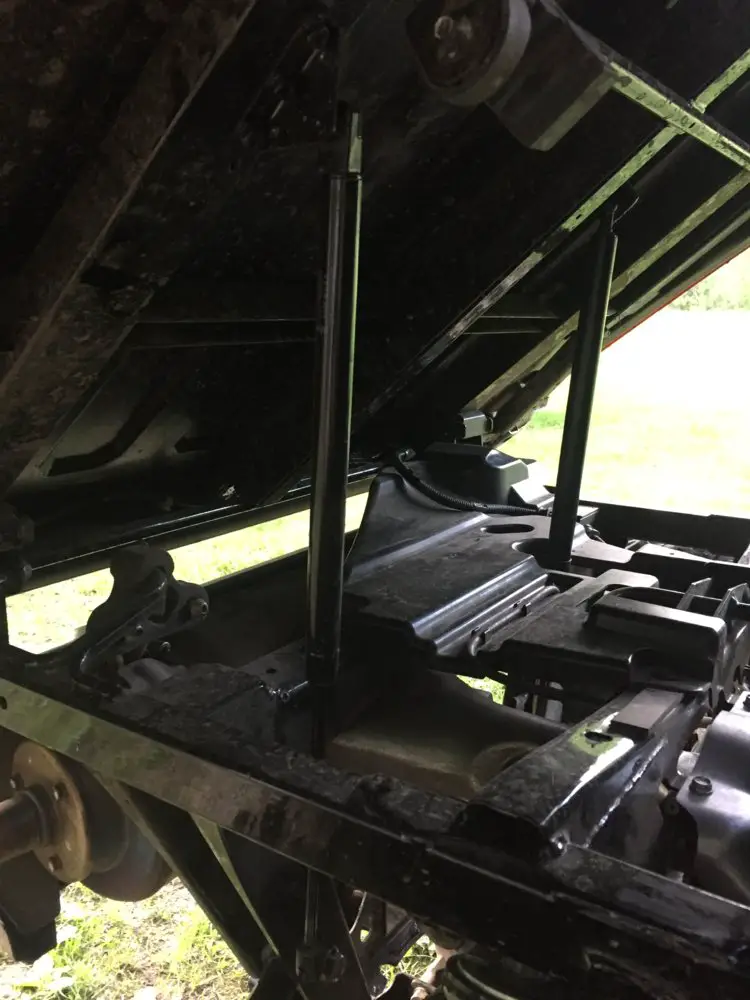

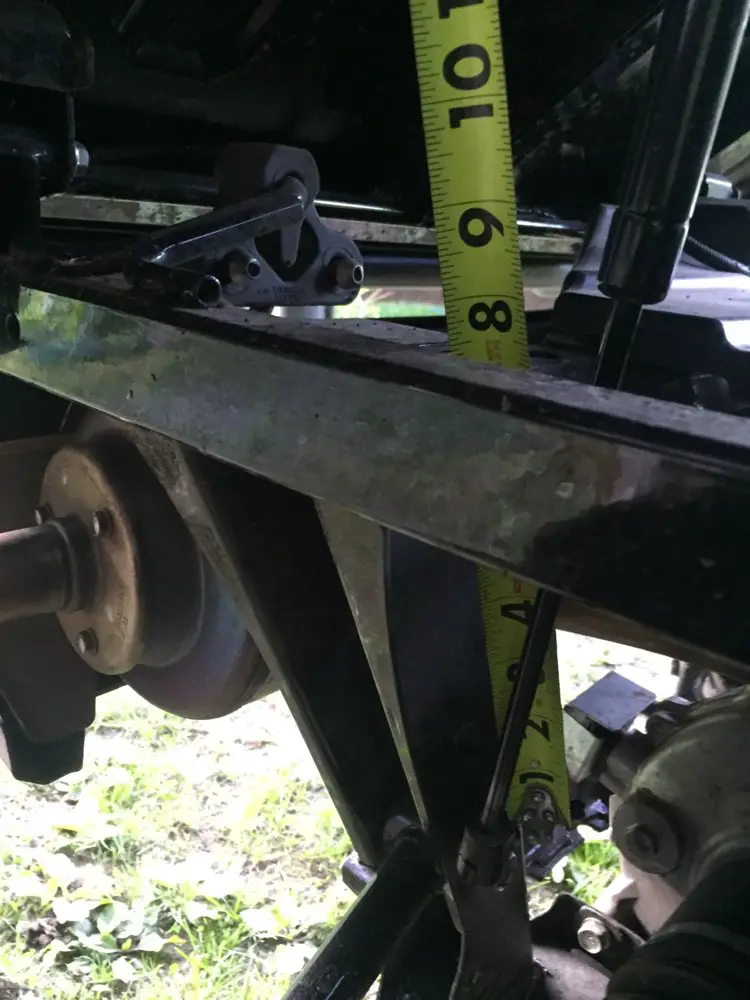

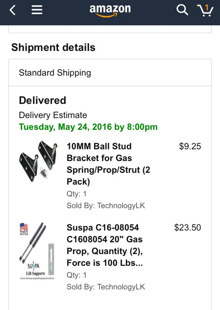

Not sure how much the OE support was rated at. But adding the additional 100# support helped drastically. Here's some pics of what I did. I don't have the brackets part number. But they are for a 10mm socket. Got the brackets and a set of two supports from Amazon for about $40 with shipping. Image Image

It pushes down I little harder but not bad if you have a little weight in it already. If the box is empty there's is a bit more pressure. But it's not like you have to stand on it lol. Like I said I have a small wood box that holds my husqvarna saw, some gas and a ammo box with supplies so it closes fine. Way better than not being able to hold its self like before.

Thanks for the info! Next time you're on Amazon, please snap a screenshot of the items you purchased.

Had to drill a couple 1/4 inch holes in the frame for the lower arm bracket. For the top I used large self tapping screws. You could drill the frame at the top and bolt it. I plan on doing that soon just because it would be a little better for the long haul.

Not sure how much the OE support was rated at. But adding the additional 100# support helped drastically. Here's some pics of what I did. I don't have the brackets part number. But they are for a 10mm socket. Got the brackets and a set of two supports from Amazon for about $40 with shipping. View attachment 16322 View attachment 16323
