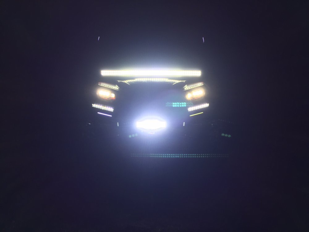

Image Image The light from mine wasn't that broken up. Like I said they weren't as nice a pattern as the stockies but a lot more light! You could see pretty good. I'll look around and see if I still have photos of them. For the money it's worth a try we run HID in everything we own you can't go back after you've had them. It does seem people have different luck with them that's why I stick to the same ones. You could always return them if it's not for you. this was the only photo showing pattern

That light pattern looks a whole lot better than what I had on my P700.

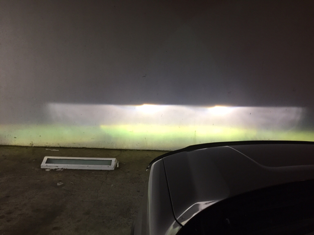

I have HID lights on my truck. 4300k in the headlights and 3000k in the fog lights. In my opinion, this is what it should look like when the bulb is built specifically for the housing. No glare and scattered light. When I flip the bright light switch, the pattern changes from low and cut to full distance bright light.

I absolutely agree that's what they should look like especially on the road. I've put projectors from Audi in housings to get that cutoff but the factory headlights in that machine don't do that so obviously hids installed can't either. If someone put projectors in they could but I think to add a 26 dollar item they work pretty good. Beyond adding that to the headlights led bars are the way to go. The first thing we did to the 700 was hids as with other rigs in my opinion it's a major upgrade and most people would be happy doing it. We have hids in everything from the dirt bikes to our sleds. Even had a 75watt hid flashlight (led better as you know as the draw from that was good for an hour was all) The Xentec seemed fine way better pattern the what was showed. It was scattered a bit but it really was drastically better more depth and better flood. For the average person working on a budget they would be great and anyone else even with good LED lighting they are better and now match the led. To each his own I think for this kind of money it's worth a try and just return if not no harm no foul. I'm sure you'd agree with me on that. Most people don't expect a cutoff in the light for under 30$ with only a 20 minute install. Ive noticed the bigger the stock housing the better they work. In a projector they are incredible! However I wouldn't want a cutoff for off road the would suck over anything rough you'd lose your beam a lot. That's the only reason I didn't do it to the 700. I might just say screw it and redo the headlights on the 1000 just to show how it's done but I know it's more work then its worth it but I know that going in. A projector for low beam with 35hid and replacement LEDs for high would do the trick

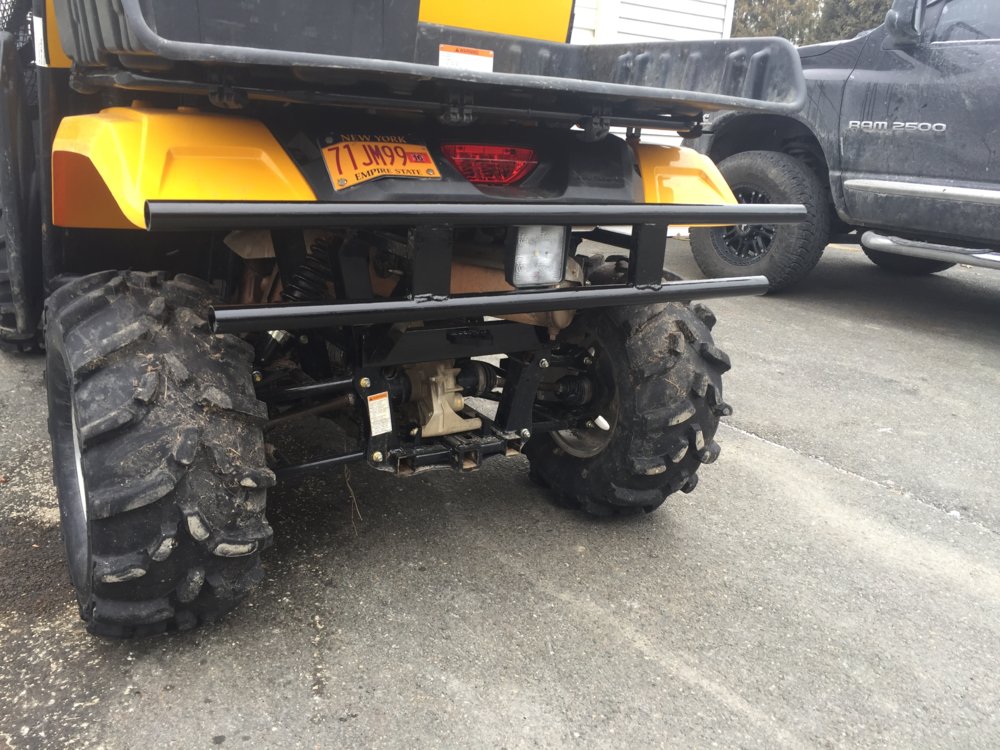

Led is the way to go if u ask me I run a 22" bar it's 200w up front and a 4x4 on the rear for back up and it's all I need I never use the head lights anymore

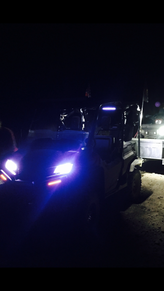

I think I'd agree with you maybe you didn't read the whole thread all we were talking was updating headlights which for 26 bucks you can at least have your headlights match your LED and actually help if you see attached photo you'll see I believe in LED as well. But you might as well fill those yellow holes with something you can see by Image
