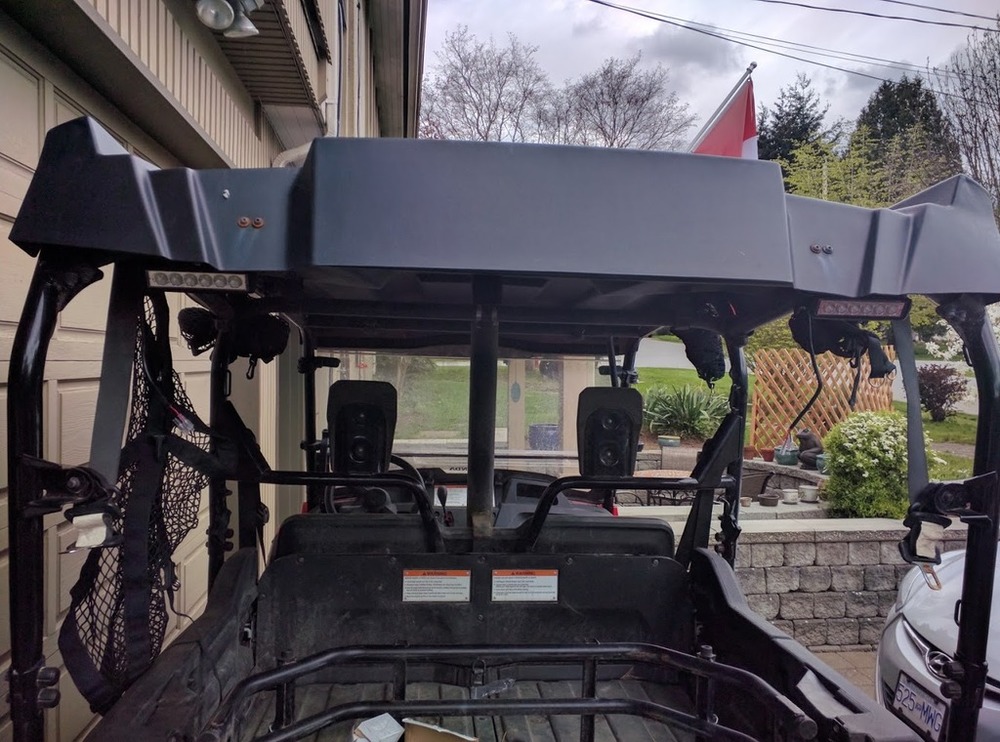

Definitely, now to decide where to install. I was thinking down low, as it would be easiest to wire, but i don't really trust the waterproofing on the cheap China camera and suspect the first water crossing and it'd be pooched. Also I'm about to embark on building an exhaust silencer, and if i didn't waterlog it, pretty sure i'd melt it with the additional exhaust heat. So that leave up on the ROPS, which will be a super big pain to fish in new wire, but not seeing much other options, now to track down some decent quality RCA coax, and some thinner power wires to get everything back there.

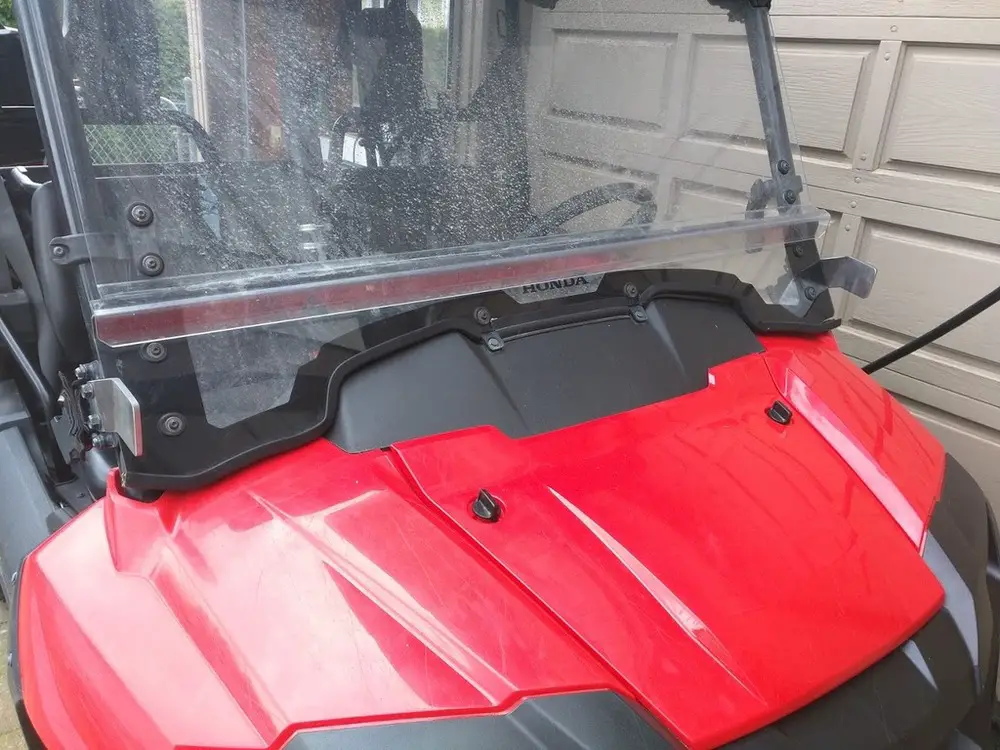

I don't see how you managed to tighten the bolts holding on your switch panel unless you had help.. I would recommend pop rivets next time you have it off
*MAGIC*
LOL, I removed the windshield, and am 6'6" tall, was able to do it just fine on my own. Though, there was MUCH cursing lol. Pop rivets might be an option, but I'd still need to get behind to put a washer for the pop rivet to bite on to, that plastic in that area of the dashboard is anemic at best.

That had to been challenging... yeah I agree the plastic is weak but the larger pop rivets have worked well for me with no washers. Although I'm about to be drilling them out to add more lights and switches to my rig

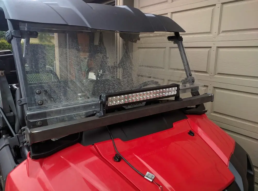

Well I finally got the new mount for my light bar built, and all the lights mountedl Took some pics for reference.

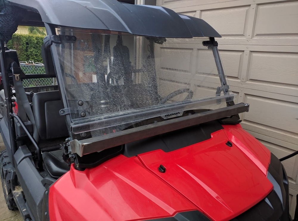

Started with a cardboard template, then cut these 2 plates out of some 1/4" mild steel plate with the bandsaw and grinder, then drilled.
Took a chunk of 2x2x3/32 square tubing and tacked between the brackets, here's a fit up test before welding and drilling for the light.
Light mounted. still can open the front window a bit, and can still add on a front rack later on if i want.
Rear floods mounted.
