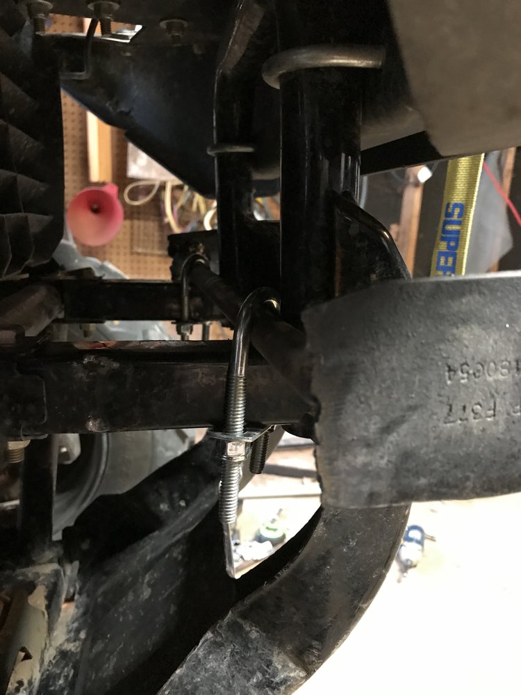

@lil_country Great work. did you use a plow mount or make you own connection? could you post some close up pics?

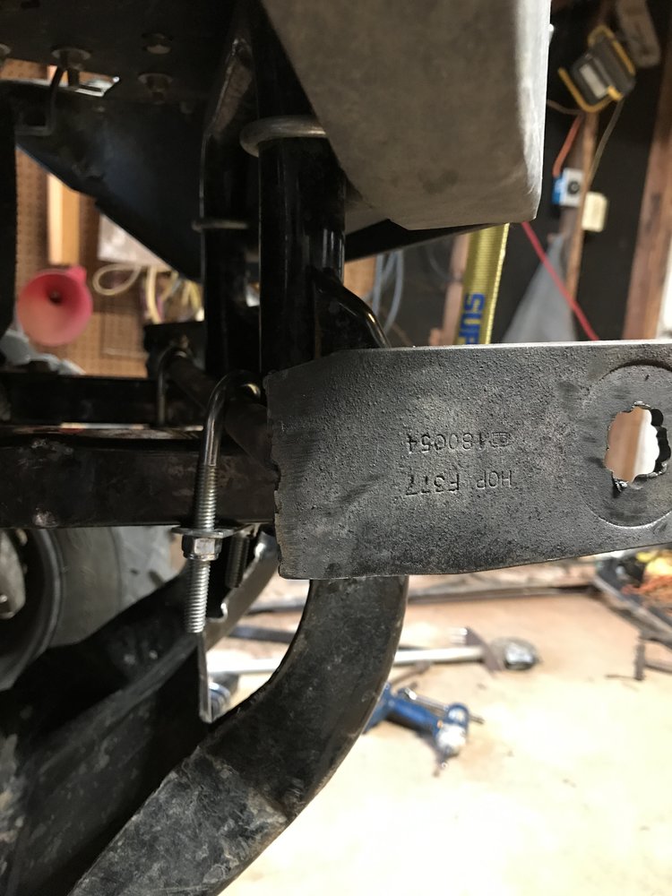

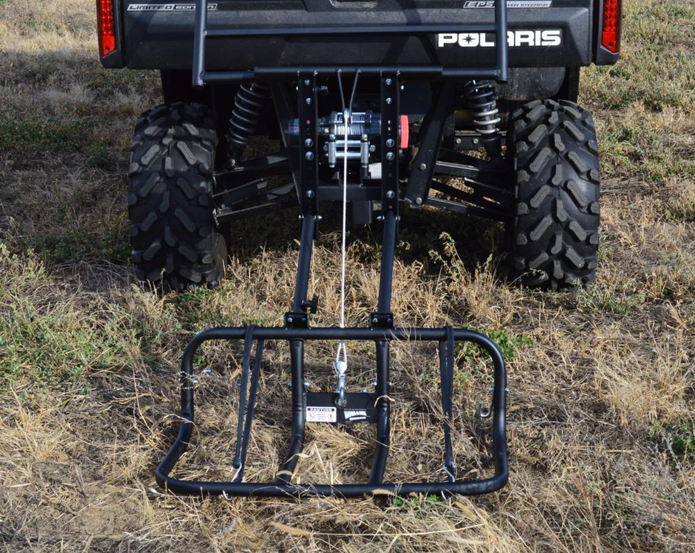

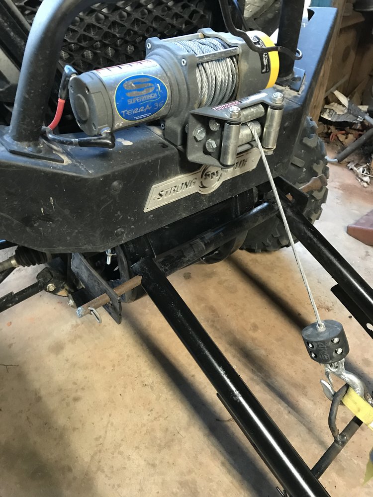

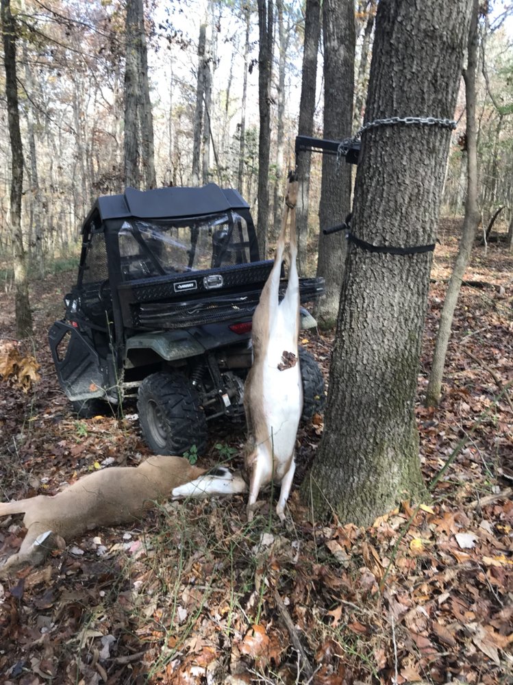

I made my own. It's an 18" piece of sucker rod with a flat piece of metal welded on each end. (I used old mower blades.) It's clamped to the Honda bumper frame with U- bolts.
IMG 4340 IMG 4341

Could probably be done by attaching to the receiver hitch and using a pulley attached to the rear of the cage.

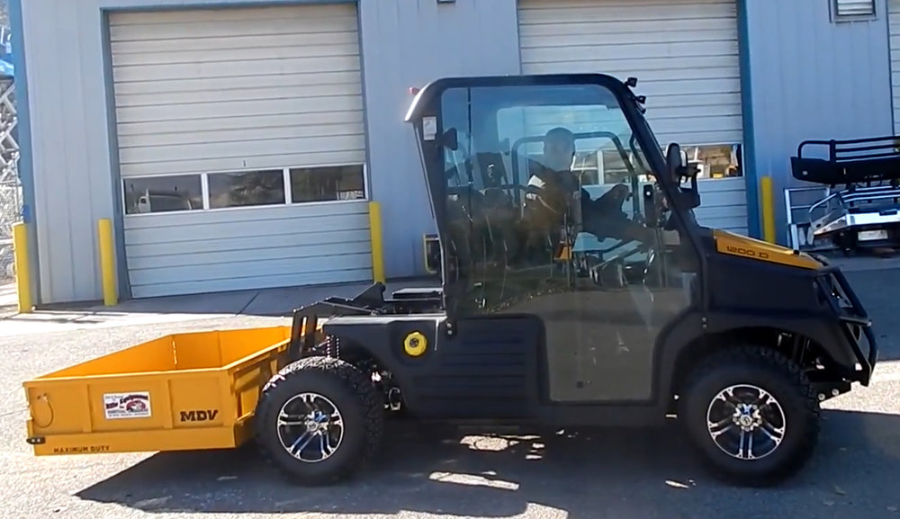

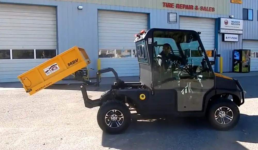

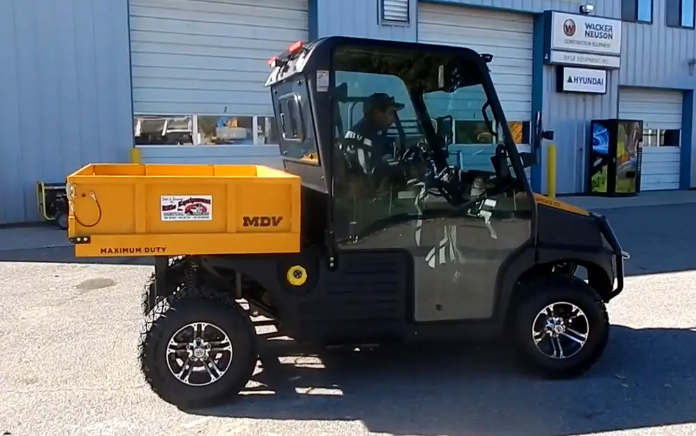

Thanks for details, inventive skills. FYI. New Hustler MDV has a radical lift/dump cart, Kinda looks like a P500 ready for a wheelie. Reminds me of a “Rube Golberg mousetrap”. $$20k

I shot one last year and was by myself. I have a 700-4. I tied the doe's legs together and made a butterfly knot. Then I ran my winch cable (synthetic) across the top of all the roll bars. Hooked it in and winched her up till I could just push her into the bed then lowered her. Worked slick.
