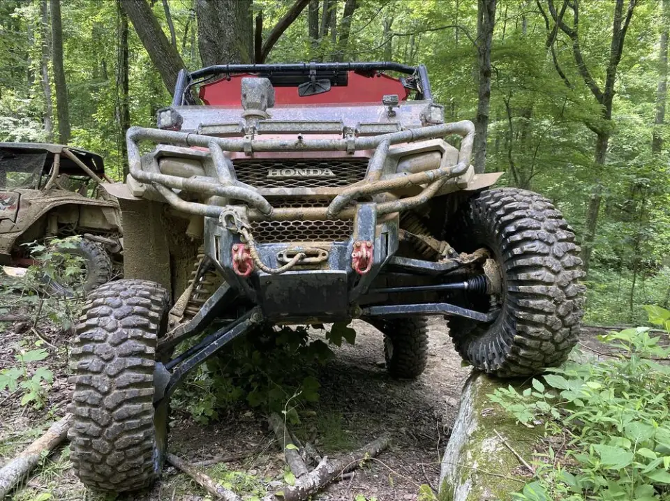

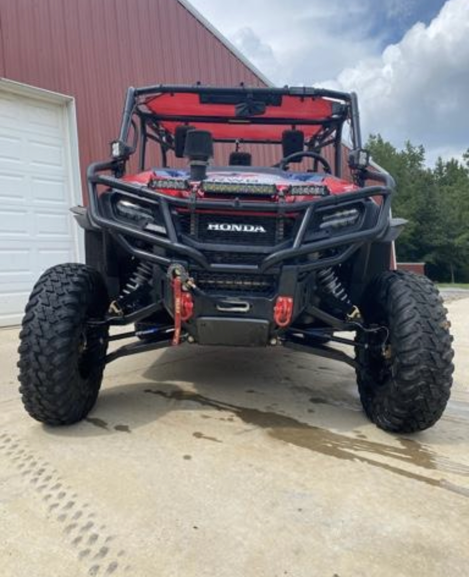

Here's a little before and after. I love the TTC long travel kit. I did manage to break the arms twice but I'm probably harder on it then anyone. No problems getting them warrantied. I ended up upgrading to 3/16 Dom tubing for the main tubes. I modified it so it would sit lower but still have a longer shock then factory. Only 2.5" longer then the pioneer shock. 72" width is great in the rocks and on the trails. I slightly miss the narrow track width of the pioneer however I dont miss the ride lol.
