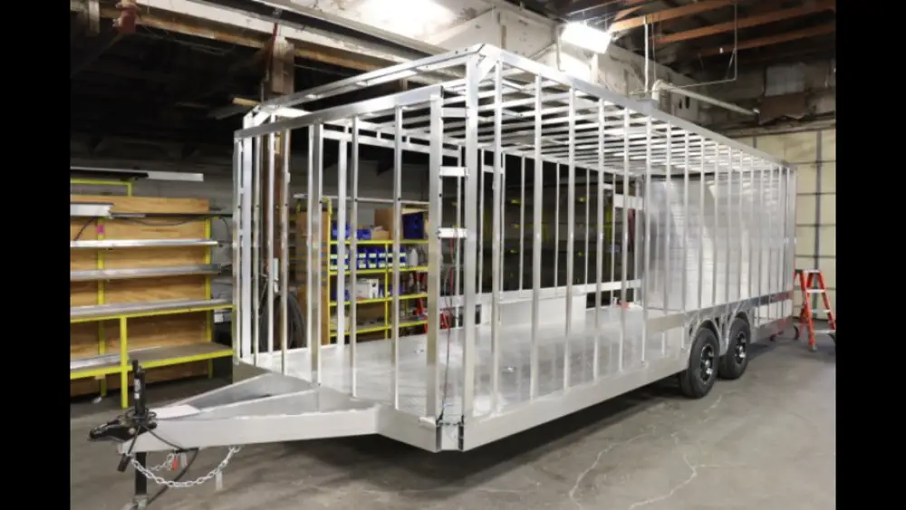

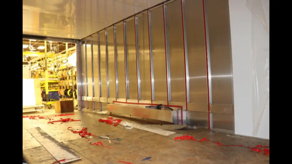

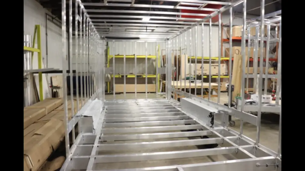

Did some measuring and I’m at 22’ 8” from the stud to stud I’d prefer to use. But looking at the pics I have from the build I’m wondering now how they attach. Do they tap into the horizontal brace at the top and bottom or do they screw t the upright braces?

Vertical braces. There’s screw holes up the arms. then like said you need the fabric channel that screws across the top and fabric slides into to.
