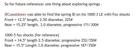

I’ll take a pic of my receipt unless @Ragnar406 or @GlockMeister bas it handy
Here was the spring rates of the stock fox shocks
Upload 2019 12 5 12 33 14
