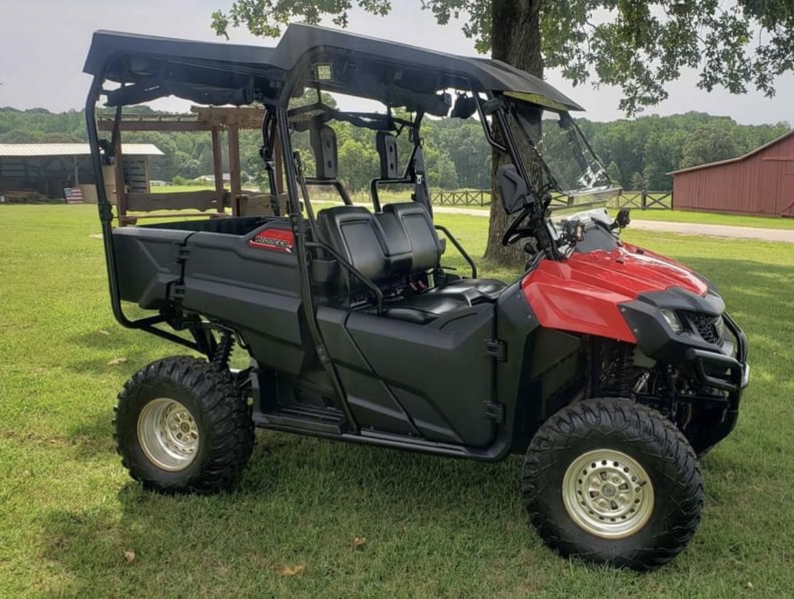

Why on earth do u want to lower a SXS besides the obvious your handicapped or starring on little people big world or going full out GDog? My suggestion would be to slow down!
Business is first, when u join/first post we need pics of your rig to be sure u are not a PooPoo infiltrator. After all you joined Thursday and posted this thread 8 min later and havent been back🧐
PICS OR IT DIDNT HAPPEN!

Thanks for all of the good advice. Will try disconnecting sway bar and see if it helps. Current tires are 27”, going back to stock should help to.
Great question about why I want it lowered! Bought the machine in order to access my boat dock on Lake Hartwell. It’s a US Army Corp lake and they are super strict on paths connecting lake lots to the water. Paths have to follow topo and can’t excavate to flatten it out. Almost flipped a golf cart on path during a test ride. The Pioneer does it ok but still fills tippy.

Thats a clean rig.
