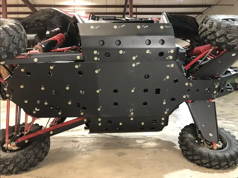

Some aftermarket kickers aren't any more substantial than our ROPS which is only suited for supporting the roof and one gentle tipover. I'd want at least .125" wall thickness.
I like the 1/2" Trail Armor skid assembly which wraps up the sides pretty far.
Trail Armor's photo. They sure are proud of them tho. $$$ :eek:
Besides price, it's gotta add a lot of weight!
Reactions: Blownzuki
I ride in the ROCKY Mountains, a 1/2" skid is mandatory so the weight is unavoidable. I've seen some of the damage these guys have done to their Pioneer frames without adequate protection :oops: and I don't want to follow in their shoes. I did hurt myself carrying the box into the garage tho. 😊

Other issue I just noticed on this skid plate is that the engine and trans. oil drain holes do not look as large as te factory plate.

Other issue I just noticed on this skid plate is that the engine and trans. oil drain holes do not look as large as the factory plate.
They aren't, it's a tight fit but doable. I've done several oil changes now and found 'most' of the oil finds its way into the drain pan. The messiest opening drain is aimed horizontally (17mm on a Talon). If I ever take the skid off, and remember, I might try to widen it BUT I tried with the skid in place and couldn't even nick the material, it's some tough, abrasion resistant material.
