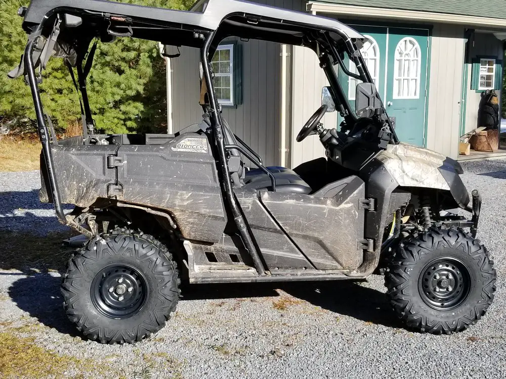

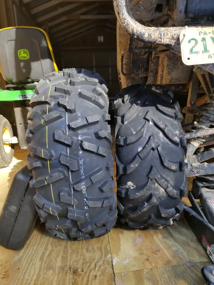

Hi guys, I finally pulled the trigger on the Maxxis Bighorn 2.0s. Just wanted to show you some pics. I haven't had a chance to run them except for a quick trip around the property, so I can't comment on them yet. I will say, I measured my ground clearance before and after, and I gained almost 1.5 inches, which was a little more than I expected.
View attachment 71064 View attachment 71065
More is better!!!!!

Looking good! I love mine!
Great looking tires. I was looking at the same tire combination for my P500 (the 500 and 700 use the same wheels). I am impressed by the increased ground clearance you got. I will need to add spacers on the P5 to keep it from falling over.
When I did my research i found that the fronts (27 x 9 x 12) are 4 ply and the rears (27 x 11 x 12) are 6 ply. It looks like these are OEM tires for some Can Am models and are not part of the Maxxis aftermarket line. I am curious if yours are 6 ply front and rear? Maybe Maxxis has changed their lineup since i looked at it last. How are the tires working out for you?

I thought they were all 6 ply, front and rear. But after reading your post, I checked back on Rocky Mt ATV, and you are correct, the fronts are 4 ply, which disappoints me. That was one of the main reasons I went with this tire. But looking at the description of the fronts (27x9-12), it states "6-ply rating on all tires except the 27x9-12 tire it is a 4-ply". That seems odd that they'd make them all 6 ply except 1 particular size.
The tires are working fine for me. I don't don't much extreme riding, just trails and roads.

Great looking tires and should do extremely well on the trails..
