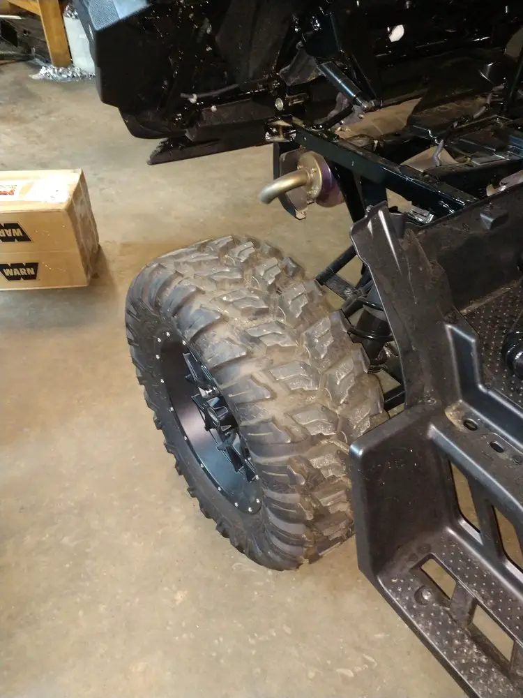

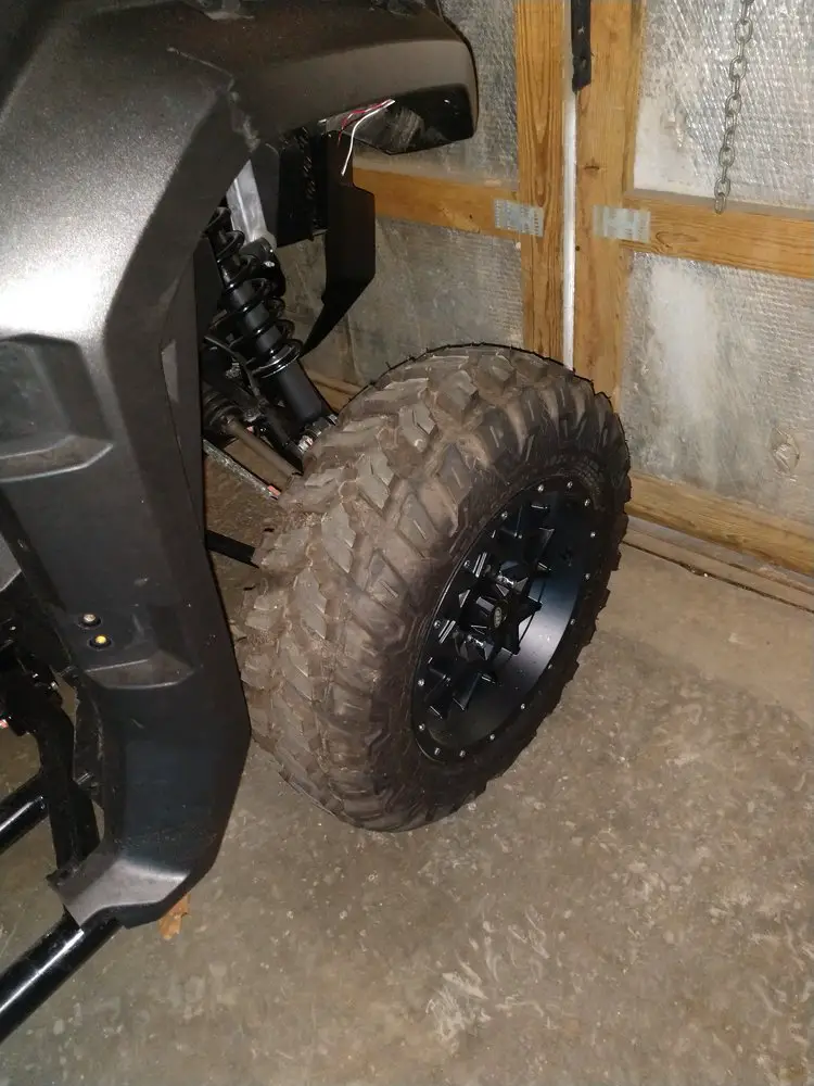

We put a 27x9 front and a 27x11 rear on the same 7 inch wheels on the rescue rig. Looks great and performance is the same .
View attachment 90599 View attachment 90600
Davey do you notice a height difference front to rear? Any chance I could get you to snag a measurement on height next time you are close? My main concern is that it will mess up my 4wd if they are too far off front to back. I'm very conservative with using it (must be sliding all over) so I know I'm likely being OCD about it, but it sounds expensive if I did mess it up.
Also, what offset are those wheels? Thanks!
Reactions: CumminsPusher
You will not notice a difference in height between the front and rear. Trust me :DI'm running 29" Big Horns on an HD4 7" wheel 5"+2" offset on all four corners. 9" tire in front 11" in rear, completely stock machine,has never rubbed anywhere, not even loaded with gear in the mountains. You'll be fine. The 1000 looks so much better when you fill up some of that extra fender well space with tire.;)
Reactions: dnjones161
