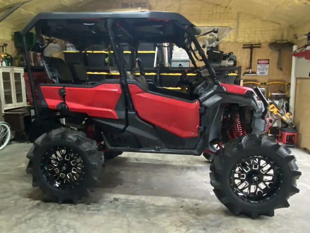

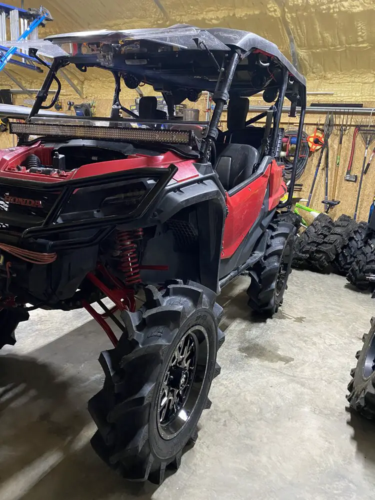

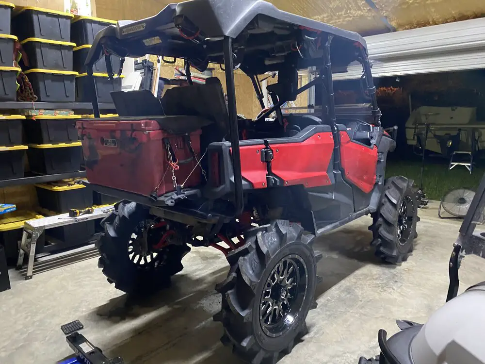

I have migraine but my buddy is in the shop playing with my Honda. I could actually run it like this with some scrubbing at full lock but he’s currently taking it apart in preparation for new lift setup. Thanks @Pellicer96

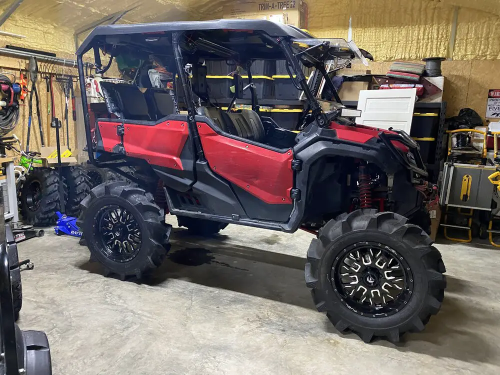

  2. 1000-3
Looks like it may be too high with the quick coupler but not sure. I know I can take some meat off the rear of first adapter but don’t know if that will be enough or not until I get stock stuff off. Sorry my shop is a mess, kinda have too many things going on right now.

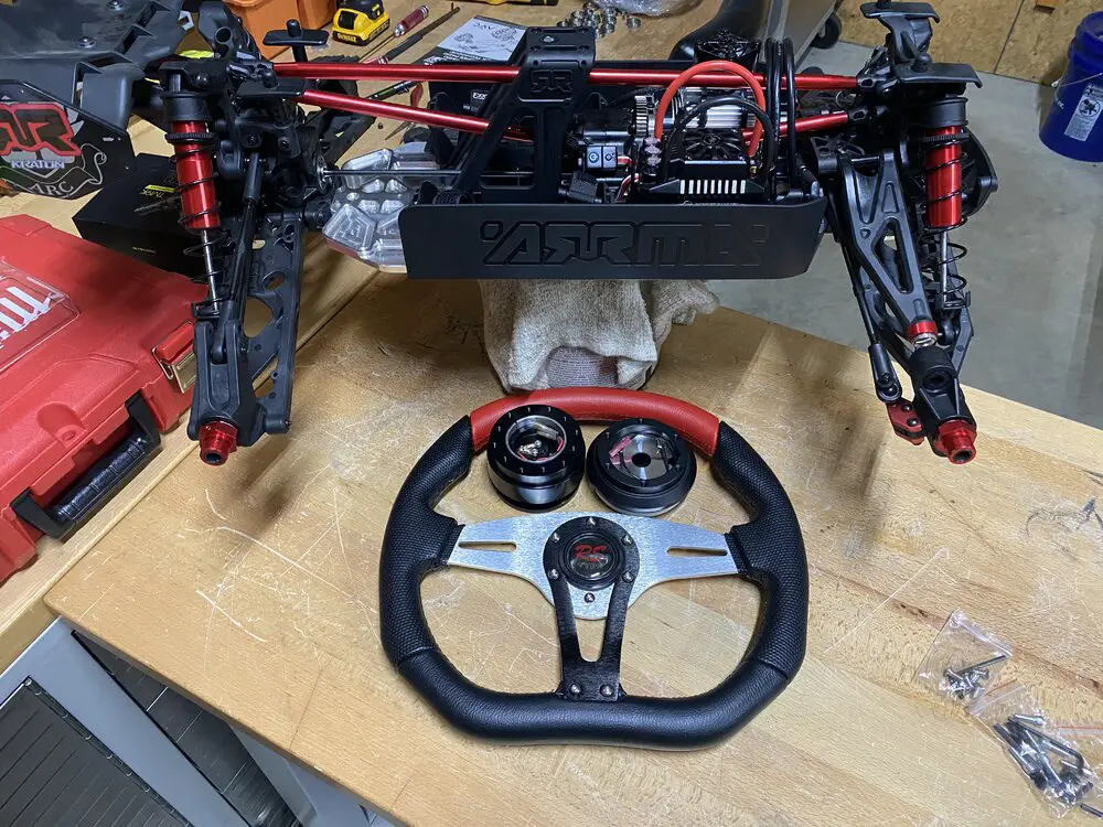

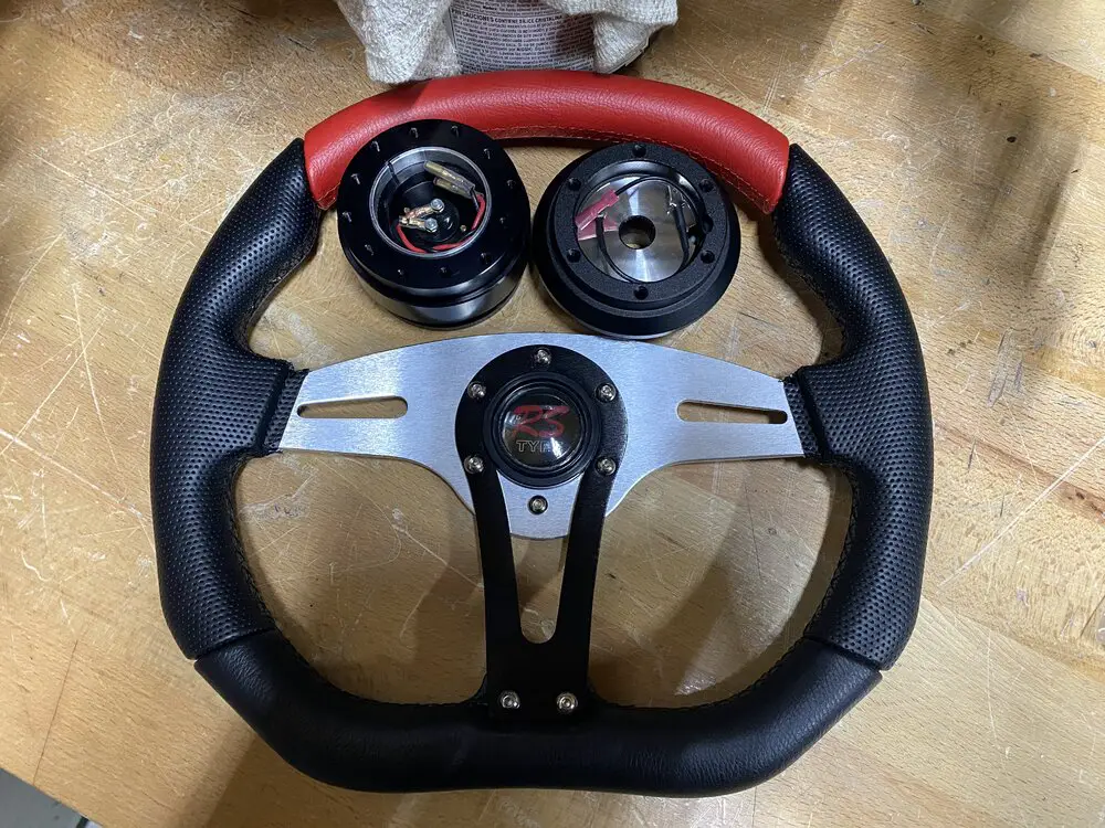

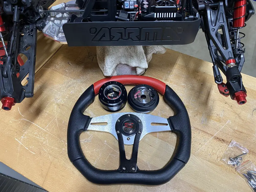

I'm late to the party, but could you give me the info on the steering wheel mod please?
Reactions: JenElio and Isaiah
aauman88
aauman88
Feb 19, 2019
1,091
2,846
@CumminsPusher has all the good write ups I believe.
Used just the outer cover from this one
Kyostar 110H Steering Wheel Short... https://www.amazon.com/dp/B0829P79WW?tag=sxsweb24-20
Used that adapter.
Black Aftermarket Aluminium Steering Wheel Hub Boss Kit steering wheel Adapter Spacer 13mm/0.5inch Amazon.com: Black Aftermarket Aluminium Steering Wheel Hub Boss Kit steering wheel Adapter Spacer 13mm/0.5inch: Automotive
And that extension. The backside of adapter I ground down flush and needed the extension so didn’t have to modify steering shaft any.

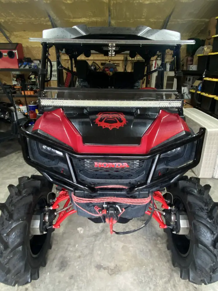

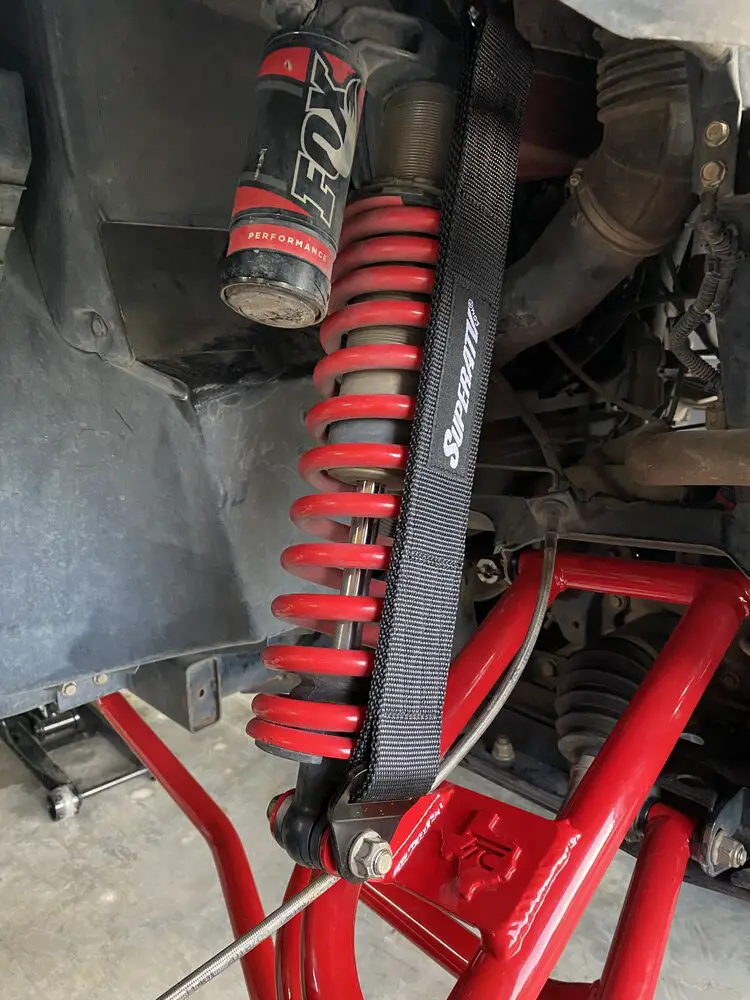

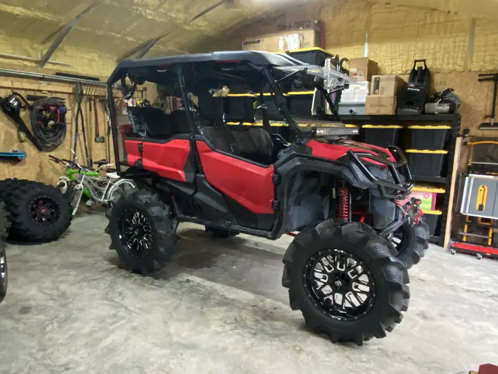

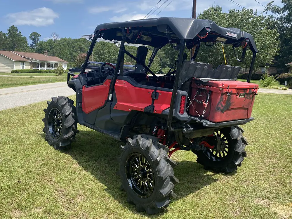

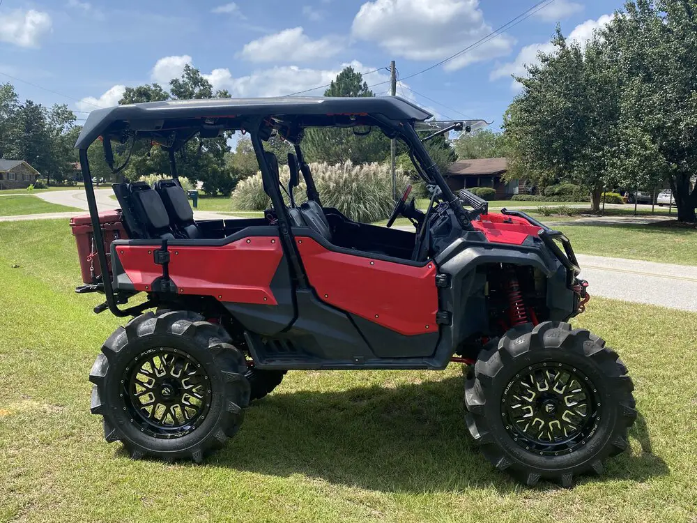

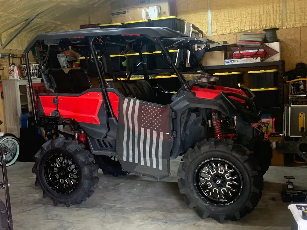

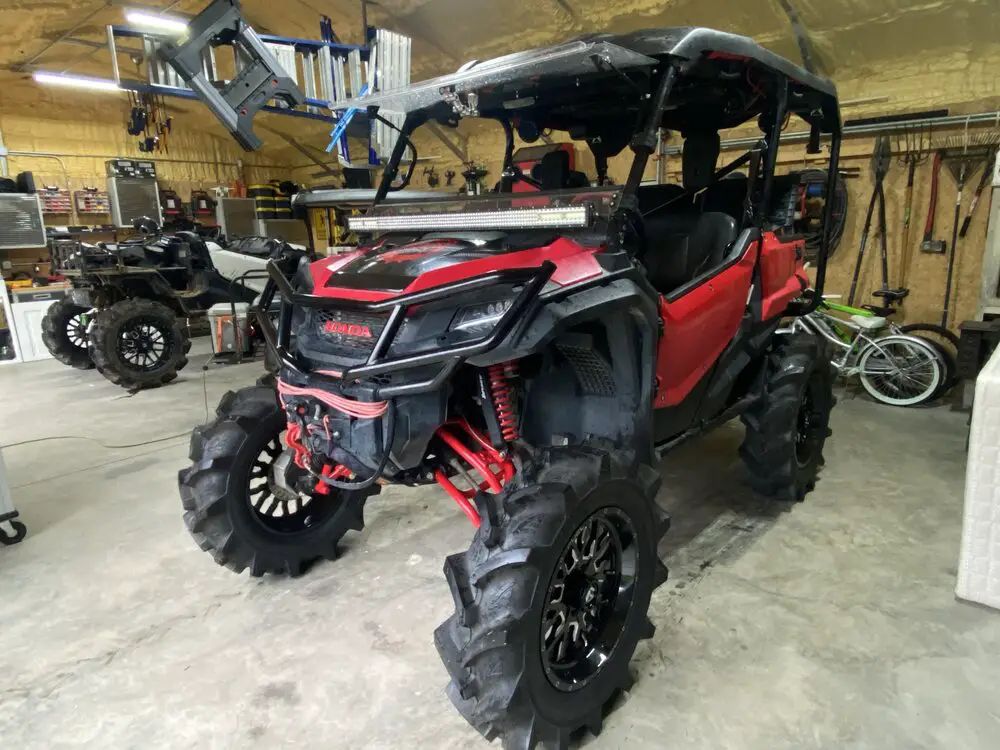

Getting there. Look close at the two side shots. The one with flag was old setup and look how close the tires are to scrubbing. The other one is the new suspension with the same amount of lift but longer wheelbase. Look at those tires now 😎😎

Definitely will. I know it’s not the popular setup but I’m very impressed with actual arms. Few small things to work out but very happy so far. The price of this setup is what keeps everyone away but the added offset front and rear is a game changer to me

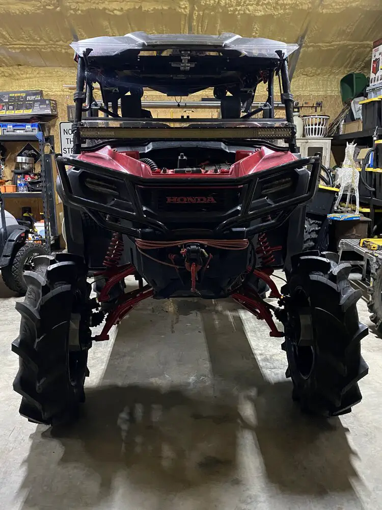

Finally got it out for test today. Still have some camber/toe issues to adjust out so my beak lines aren’t secured yet. Rides great and I can’t make it scrub at full lock even driving through the ditch. And yes I have to order some boots for tie rods. I have ordered two sets and can’t make either work 😤

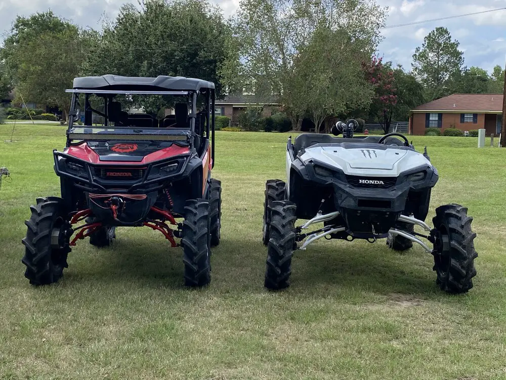

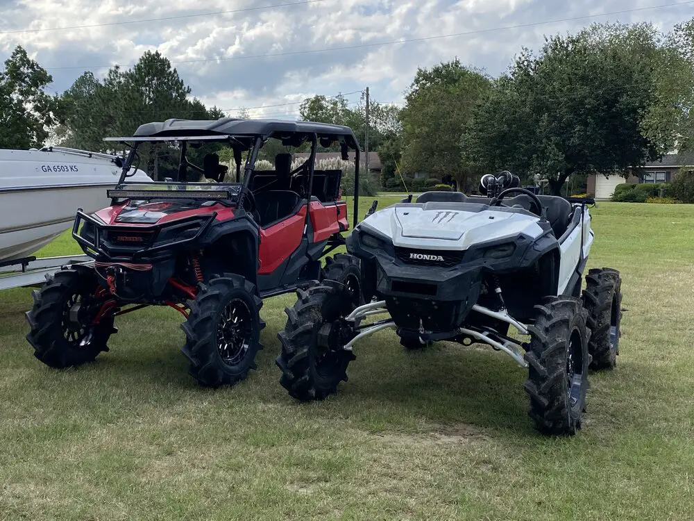

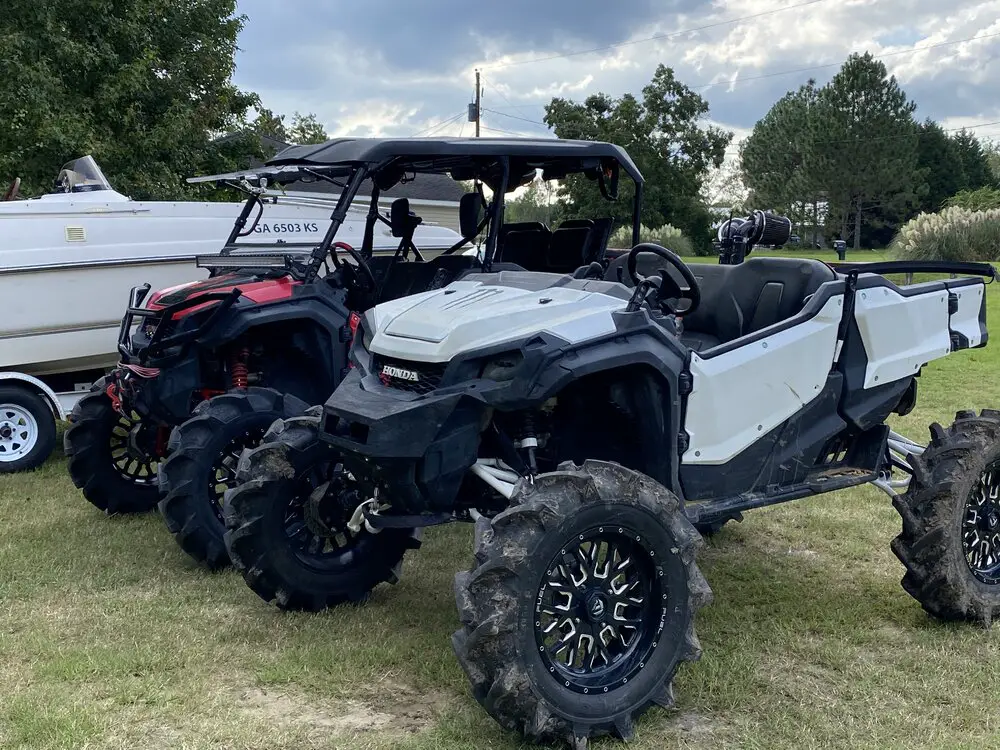

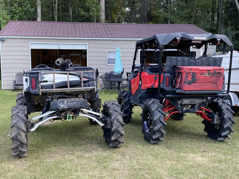

And my buddies that we are still working on. He got the 6” long travel and is a foot wider than me but we are the same height because of my Fox shocks to his stock.

Who makes the long travel kit?
Reactions: Isaiah and JenElio
aauman88
aauman88
Feb 19, 2019
1,091
2,846
Both kits are made by Jared Doster at Texas Tough Customs.

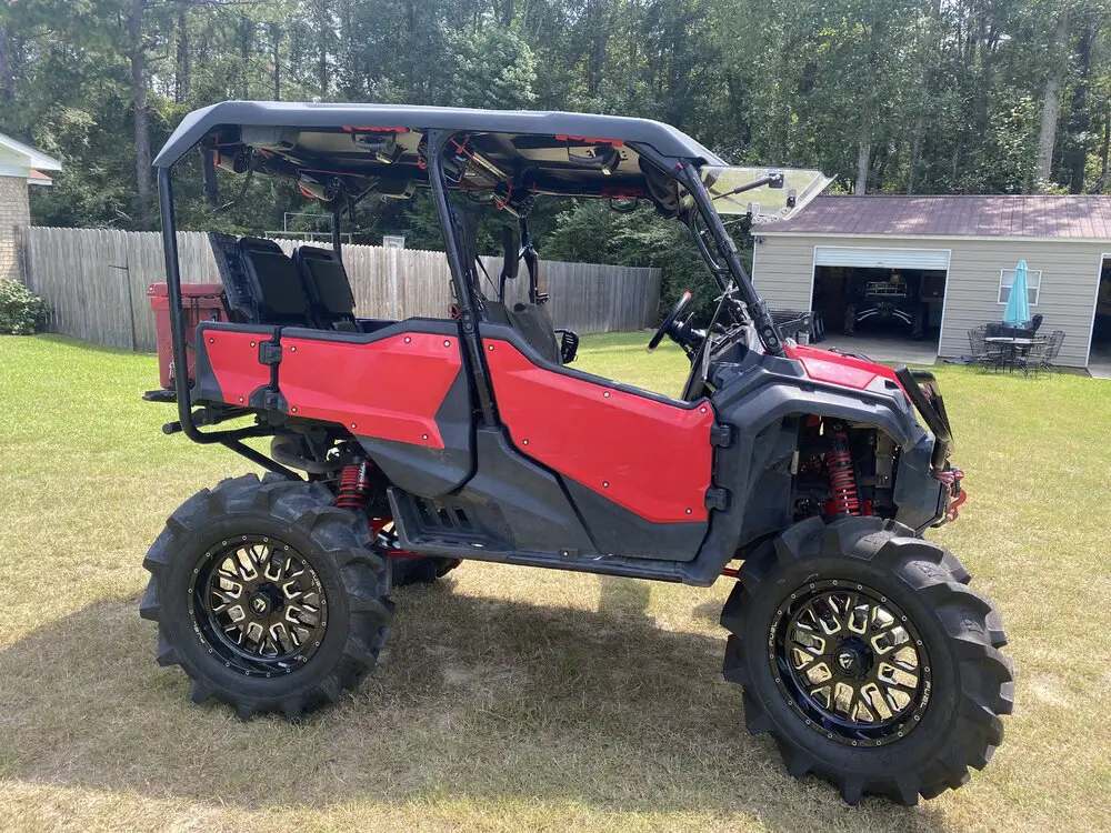

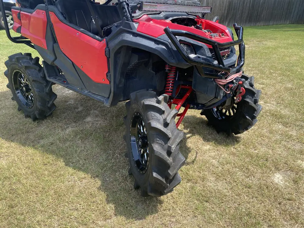

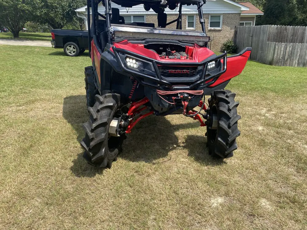

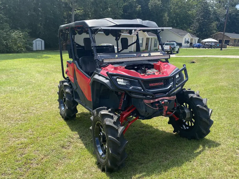

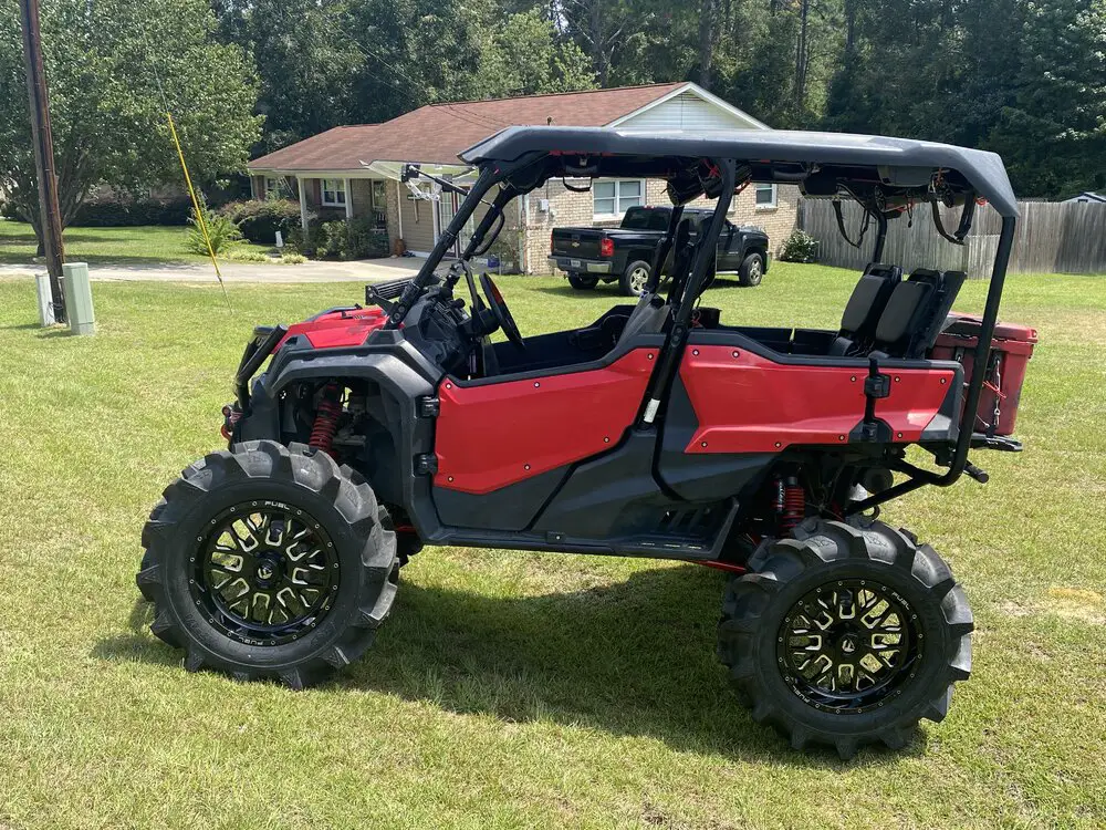

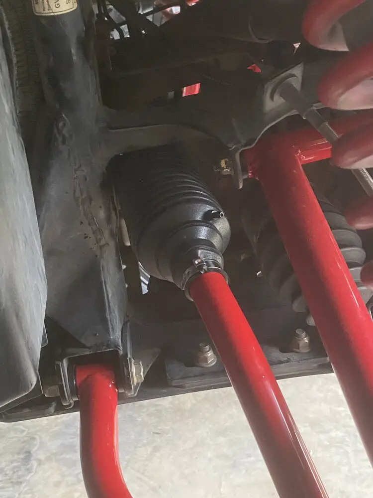

Finally got camber and toe all adjusted. Got steering boots on and left vent up on purpose. Going to fill with marine grease and have a vacuum cap to go on it so can check/fill it periodically. Run it around for few just to check it. Still hit 55mph no problem on gps. Have to dig up instructions to adjust my speedo corrector and add 20% to it
