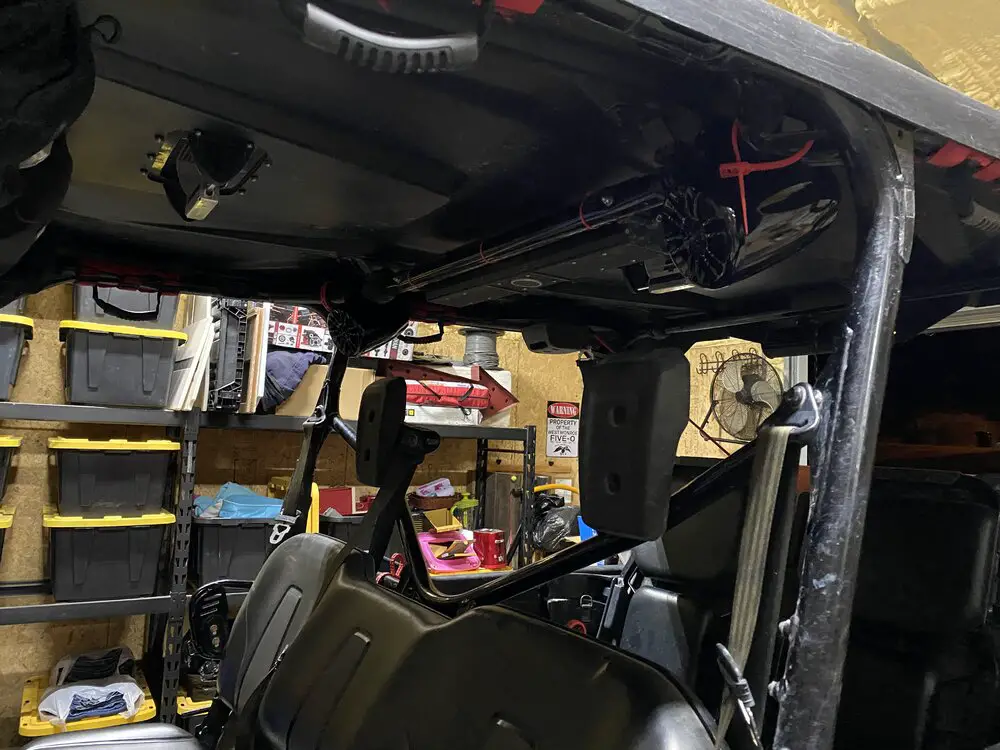

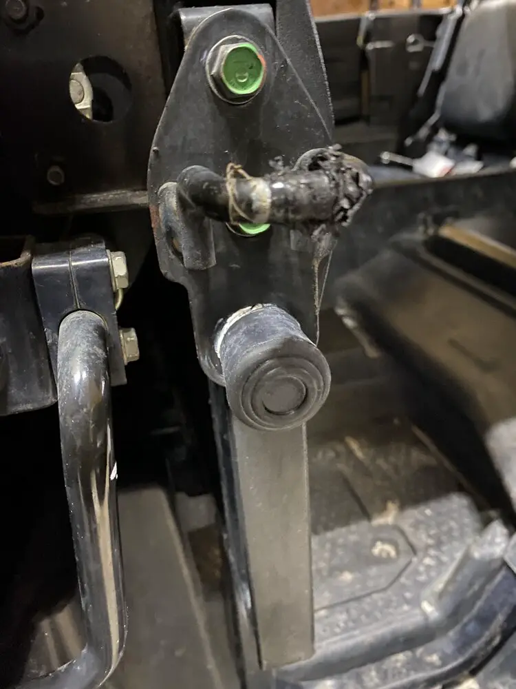

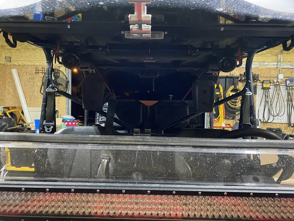

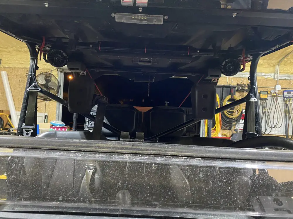

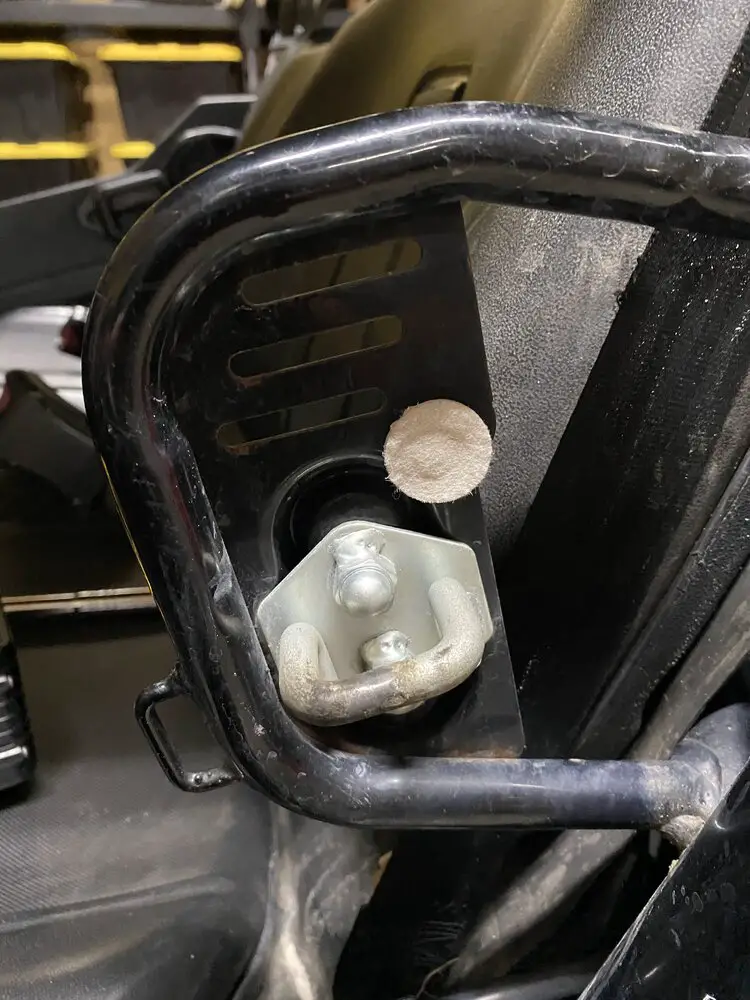

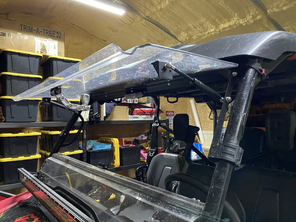

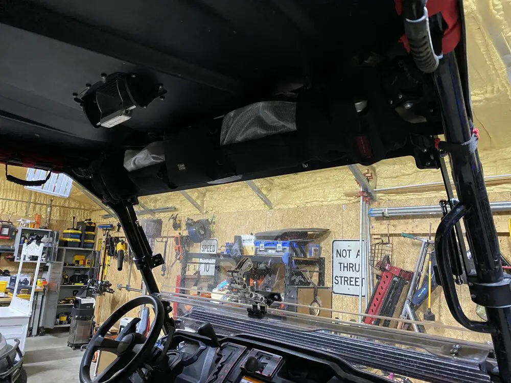

Added felt dot to front doors where rubber stop isn’t quite long enough. Rear doors added a rubber cap over the stop to give it more reach. All doors shut tight now. Moved overhead organizer to front above windshield. The bottom of it is flush with top brace of windshield so not in way at all. That made room for front tower speakers. Rear tower speakers will go on rear upright where the nets attached. Will grind tab off and mount there. Got new skid plate in but have to run my wires for radio and subs first. Waiting on some wire and RCA cables to come for that.

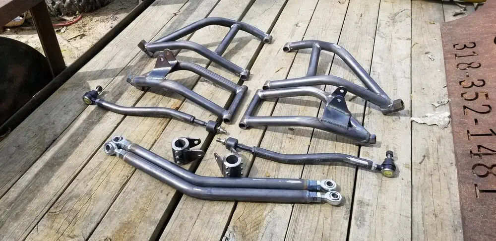

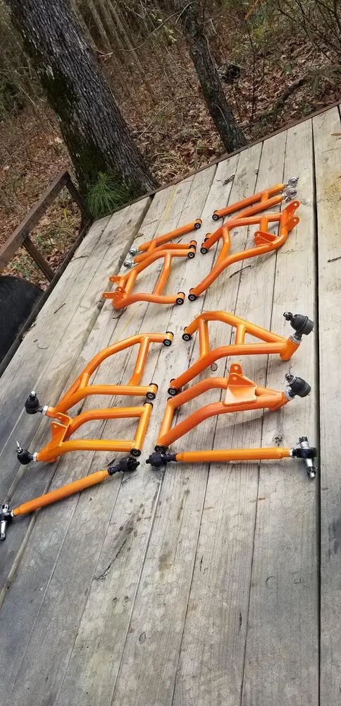

Texas Tough Customs 3” lift, HD tie rods and front link bars ordered all powdered Honda red. Will replace my HL arms and HL bracket lift as well as the SATV HD tie rods. Upgrading wheels and tires as well. Not sure if I will go 35 or 37’s. This is what I will be getting if you haven’t seen it before.
Do you have any specs for these rubber caps? Are they staying on nice and snug? Mine are backed out as far as I'm comfortable with and could still use a litte more.
aauman88
aauman88
Feb 19, 2019
1,091
2,846
It was pack of 4 bought at WM. Put some gorilla glue in it before sticking on adjustable stop so it’s not coming off but can still unscrew stop to remove. Door rattles were non-existent at our last ride.
