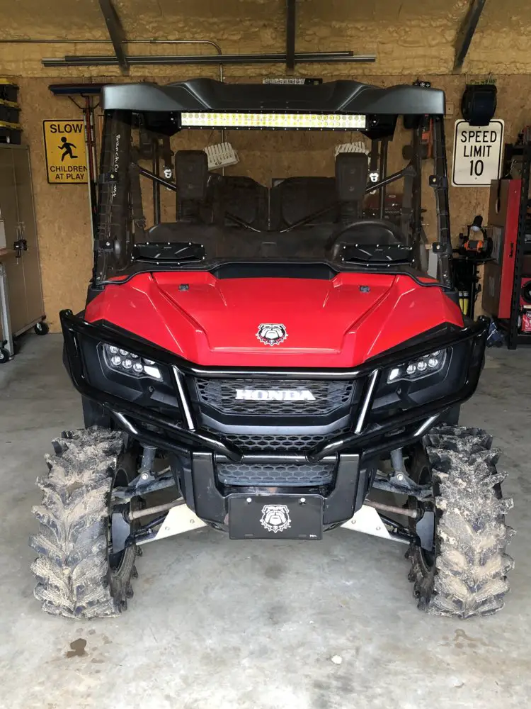

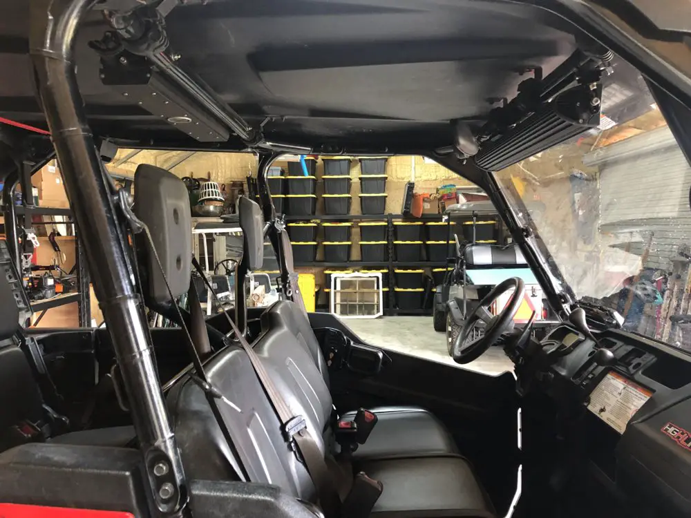

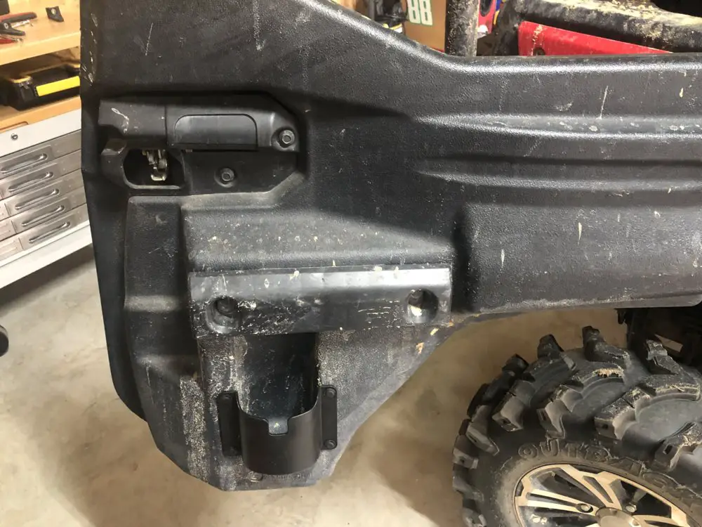

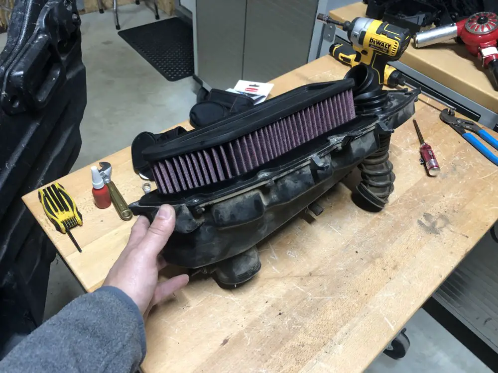

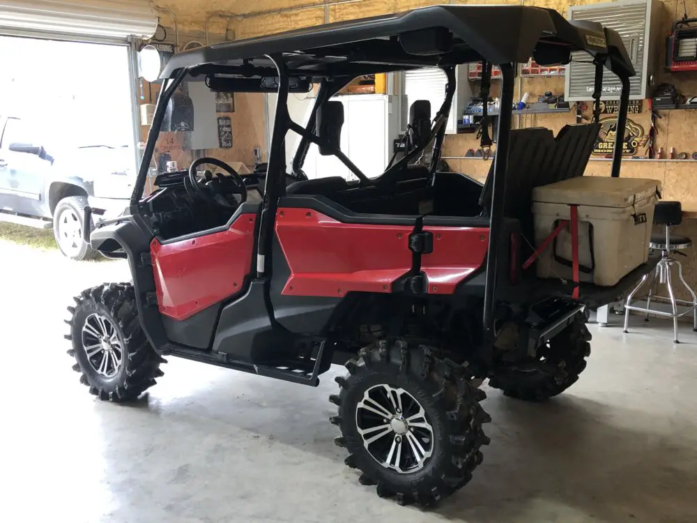

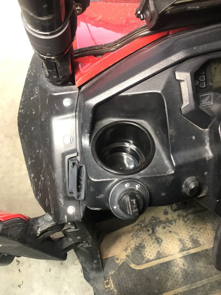

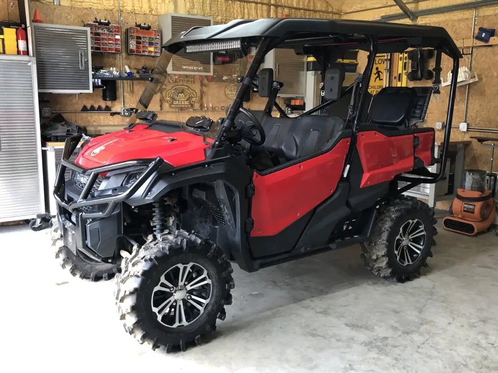

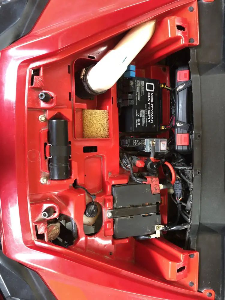

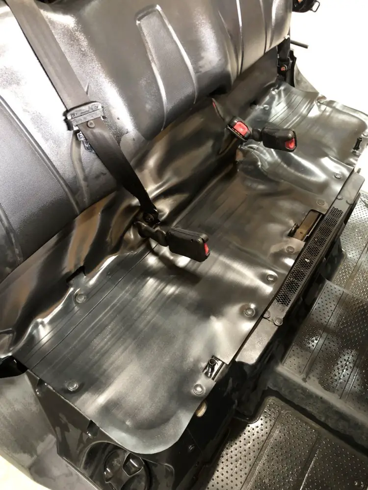

Have had the Honda for a month this week. It’s a 2016 1000-5 Deluxe with HL 2.5” lift and 28x10” Outback Max tires with 1.5” spacers in rear. Added bilge fans under seat and 60mil heat shield from front of bottom seat to top of front seat back with switch in glove box for fans. Dual battery setup with True isolator. Wiring is temporary so I was ready for big ride this weekend, will do total rewire with fuse block over winter. Full front windshield with directional vents. 30” double row light bar and adjustable rear view mirror. Powerbass XL800 sound bar. K&N air filter installed and both injector plugs have been changed. Snorkeled and all vent lines extended. LE front bumper, added Cupholders to all doors and made dash one much bigger.
So far I’m very happy with it but this weekend will be the test
View attachment 113882 View attachment 113883 View attachment 113884 View attachment 113885 View attachment 113886 View attachment 113887 View attachment 113888 View attachment 113889 View attachment 113890 View attachment 113891 View attachment 113892 View attachment 113893
Did the windshield come with the vents? Can you get the vents separate and where did you get it from?

That light bar INSIDE the windshield. That doesn't glare off it and blind you when it's on? I've been trying to find a good spot for mine. Your way would be the easiest but I would have thought the glare back into the cab would be a deal breaker.
aauman88
aauman88
Feb 19, 2019
1,091
2,846
It doesn’t glare back on your face at all. It kind of works as a dome light really. I don’t use it much as the headlights are fine to me but have had no issue driving it at night when my headlights are caked in mud. When I get it back I can show some pics at night with it lit
