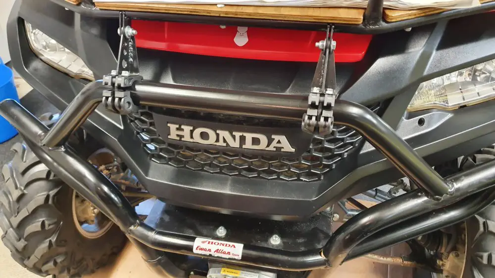

Additional photos:
20200228 083237 resized
20200228 083251 resized
As this is a 2014 model bike I decided to add another cross-member to the bull bar. I note that the new machines (2020 onwards) there is a similar bar already.
20200228 082645 resized

That front rack is a damn fine idea. Is it hinged? I want to do a dual battery set up on the 700 so I'd need to be able to get in there easily. I can see a speed goat tied up there.

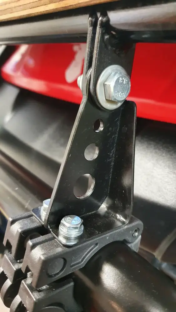

Yep, the front carrier is hinged at the rear attachment points so you can simply unclip the front attachment points and lift it up out of the way. Literally a 5 second job. If you manufacture the rear attachment points with rodends and pip-pins then removing the carrier completely is a 15 second job.
