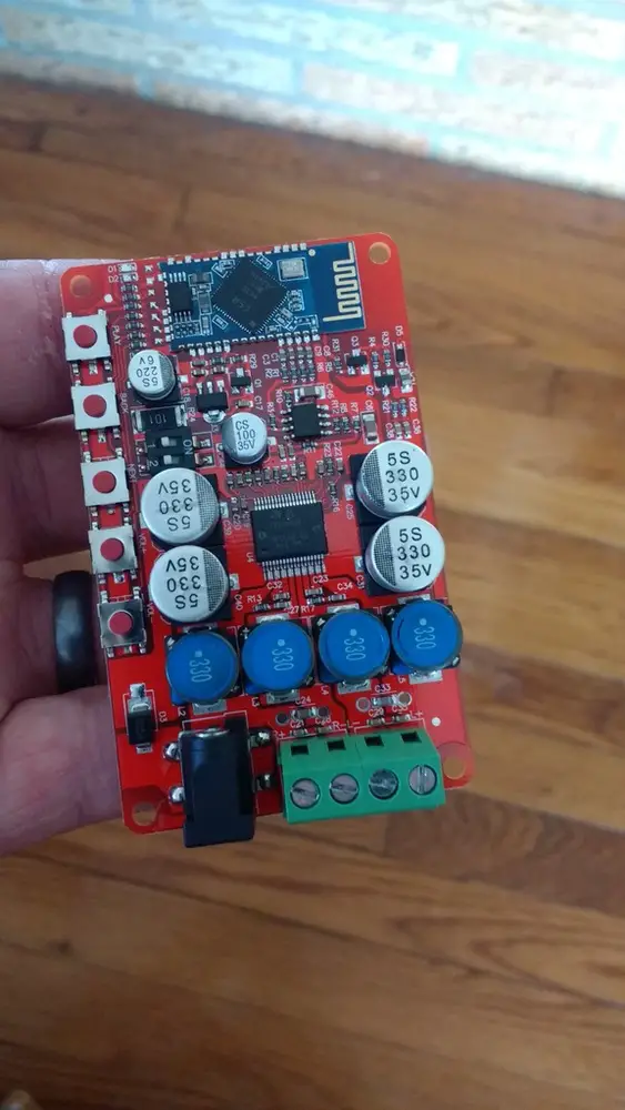

So, I started looking at options on Ebay. I found that there exists a tiny amplifier circuit card with built in bluetooth that supposedly would do what I wanted it to do so I ordered one and kept my expectations low.
It arrived.
IMG 20170211 103545299
The TDA7492P with bluetooth! They claim 50W x 2... I hope we all know better and can just move along, after all this aint no classic Kraco! (Ok, that is sarcasm)
This thing has control buttons, bluetooth and a built in 2 channel amp and can be had for around $10 +/- depending on how long you want to wait for it. I paid $14 cause I was in a hurry and being a "High roller" I had that much cash sitting around....

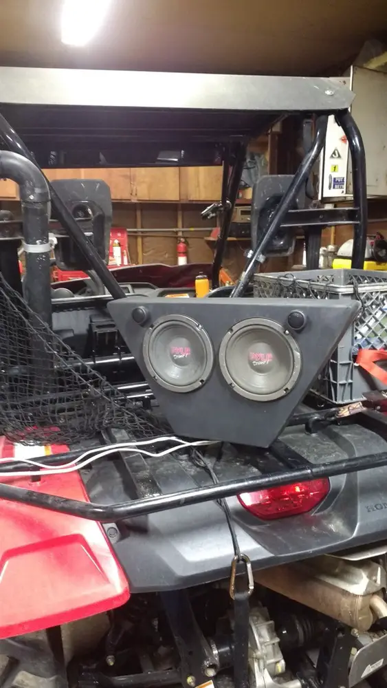

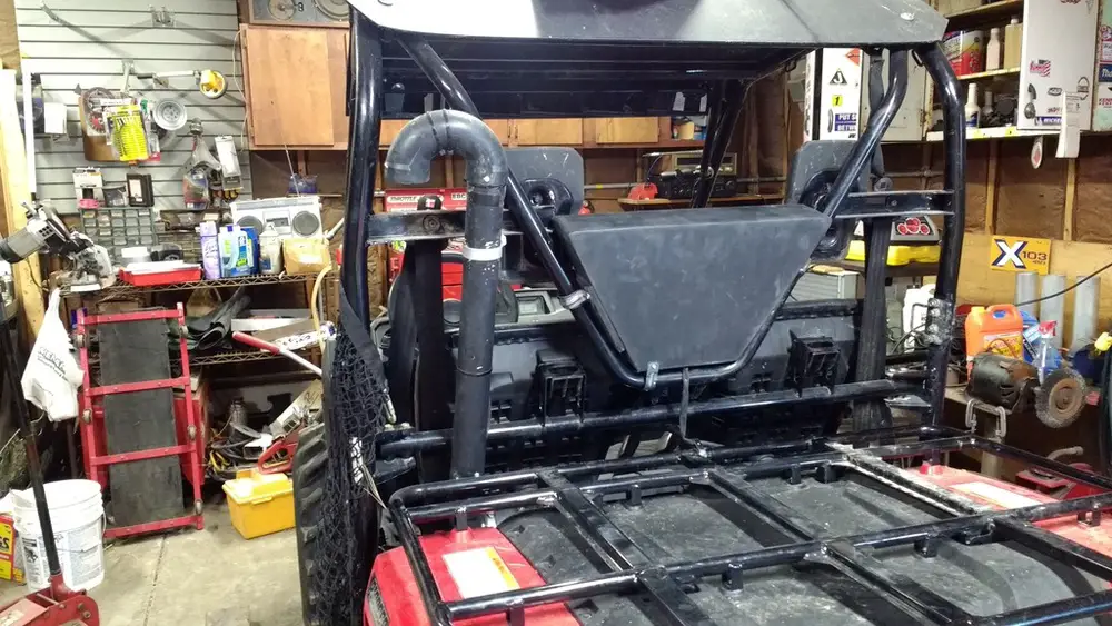

So, I got to thinking about glue and plywood and where do I have wasted space and here is what I came up with.
IMG 20170210 115516707
After I built this I hooked it up to my home receiver and I gotta say it sounded really loud. Kinda like a horn from a Klipsch. Bright and loud, not much bass, but a lot of sound.
Once the amp arrived I tested it by powering it with an old wall wart transformer that put out 12 volts at 3 amps, I have no idea what it was from, I have a collection.
I was really stupified by what I heard, LOUD. The board has two dip switches that allow you to adjust gains and I played around with it, seems to just increase the level of noise floor on the amp. I left it at default settings, but when I flipped the switches it played even louder. But, this is a cheap amp and with it powered up you do hear a bit of a hiss when you have no music playing. Pairing it with bluetooth was simple and painless, and once I power the thing off and turn it on again it pairs with my phone automatically.

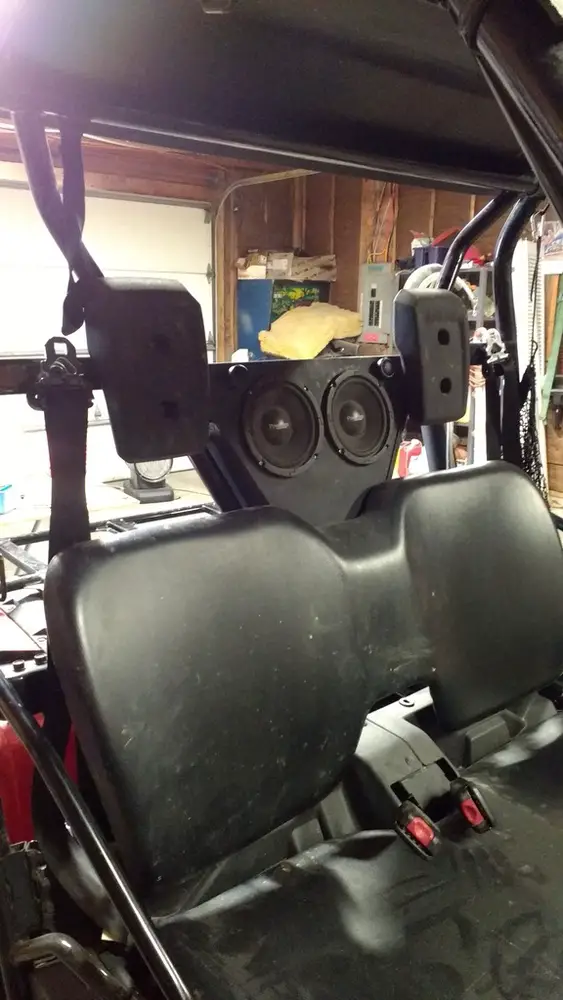

So then installed it inside the box with exotic double sided foam sticky tape and connected the speaker wires to the phoenix connectors and ran one pair of 16 gauge wire to the battery and mounted it.
IMG 20170214 122310567
I traded out the speakers for a different pair from the "pile-o-crap".
IMG 20170214 122330189
I might add a passive radiator to get a little more room inside the box and maybe make a bit more bass.

I like the wedge, looks like a nice fit. Maybe consider some grilles for those, the moisture won't hurt them much but anything sharp will.
Maybe you already have a couple in your pile of crap? ;)
I know right... I am still ciphering a way to cover those. Once I install the passive radiator I might try to find some expanded metal and make a full size grill to cover the front and mount it on some stand offs. I guess if I cant get anything I can take apart a cold air return grill or something to keep it "classy".
Maybe some plexiglass with a BUNCH of holes in it...that would be cheap.
But, if you have an idea I'm all ears...

I bet you could find metal grilles to bolt right on.
EDIT: Like these! Amazon.com: 1 Pair 2pcs 6.5" SubWoofer Mid range Metal Mesh Waffle Speaker Grill DJ PA Car: Home Audio & Theater
