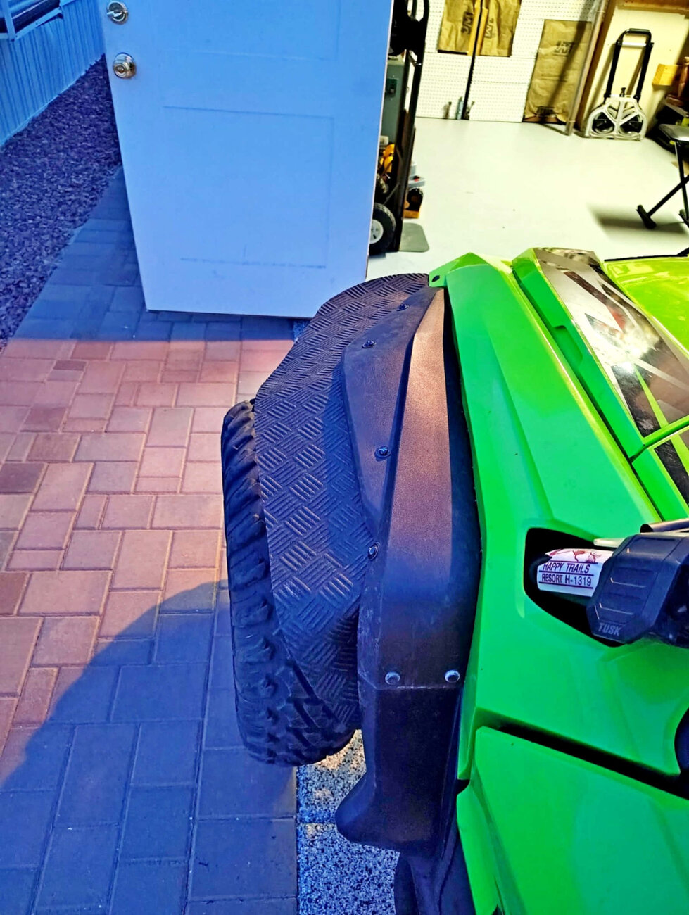

Tonight I pulled 1 of my 2" wider extensions off. I still had the roll of rubber material from my original attempt for protection. I will cut it 4" longer, going up to the headlight. And all edges will be 2" wider. I'll figure extra supports as I bolt into place. The push pins that hold the fenders aren't enough for the wider rubber, especially when coated with mud. I'm mostly in the desert. But it rains when you don't want it. And in dry times, there are water crossings.

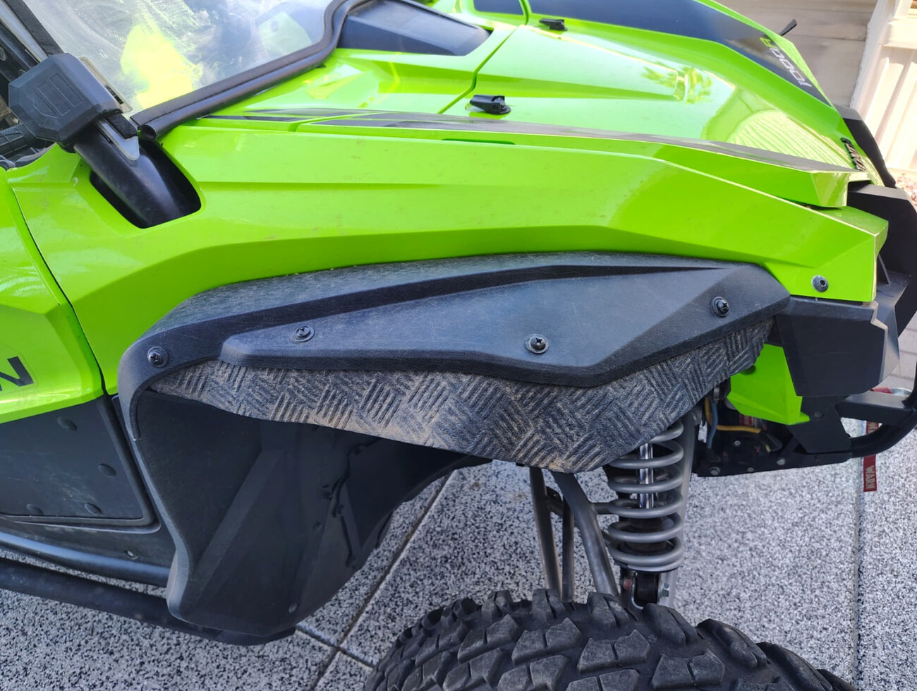

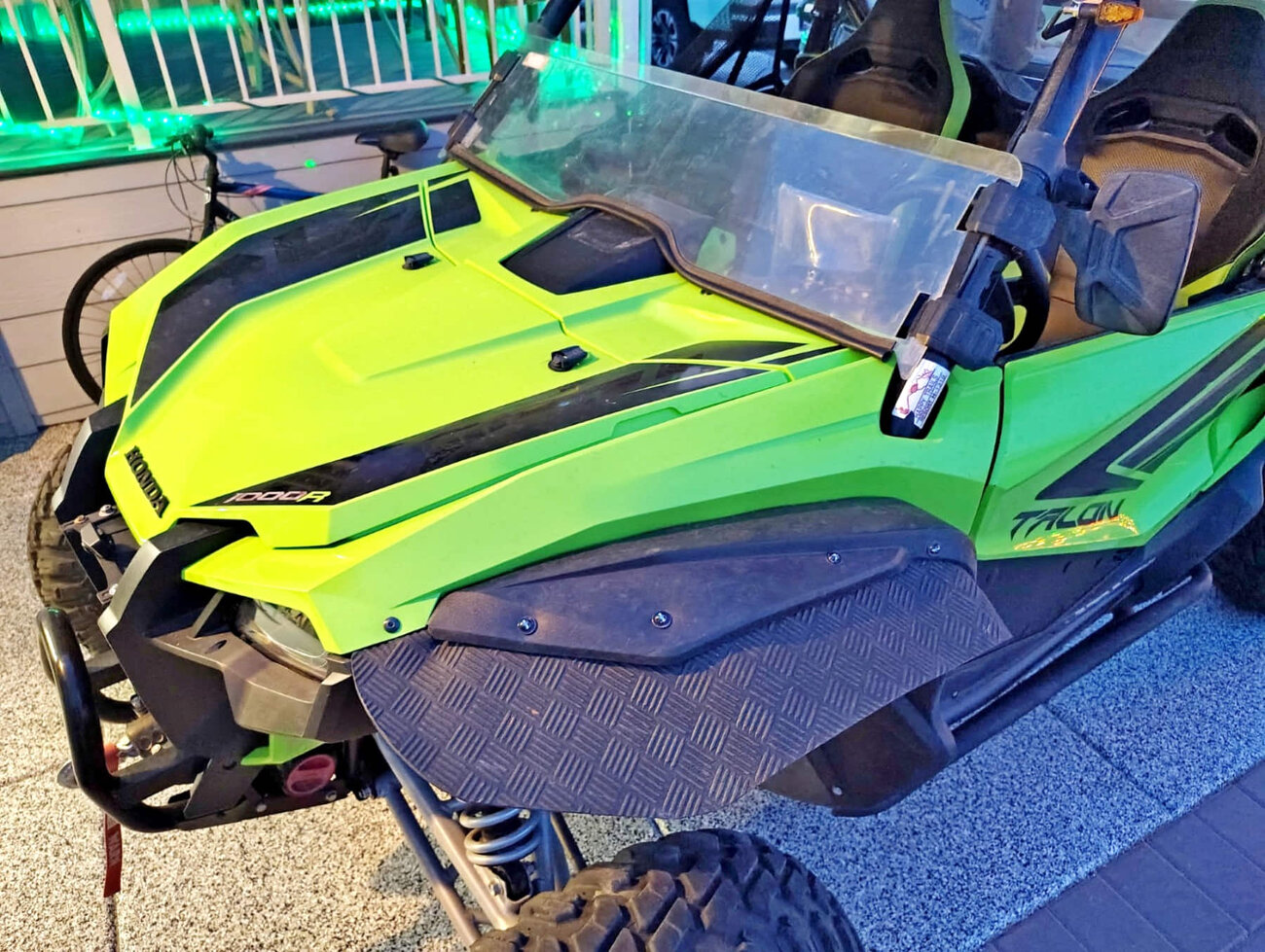

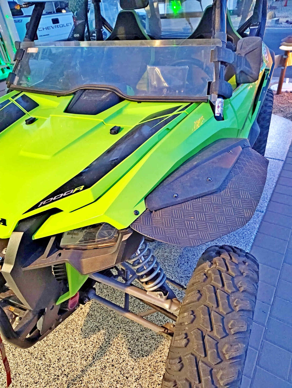

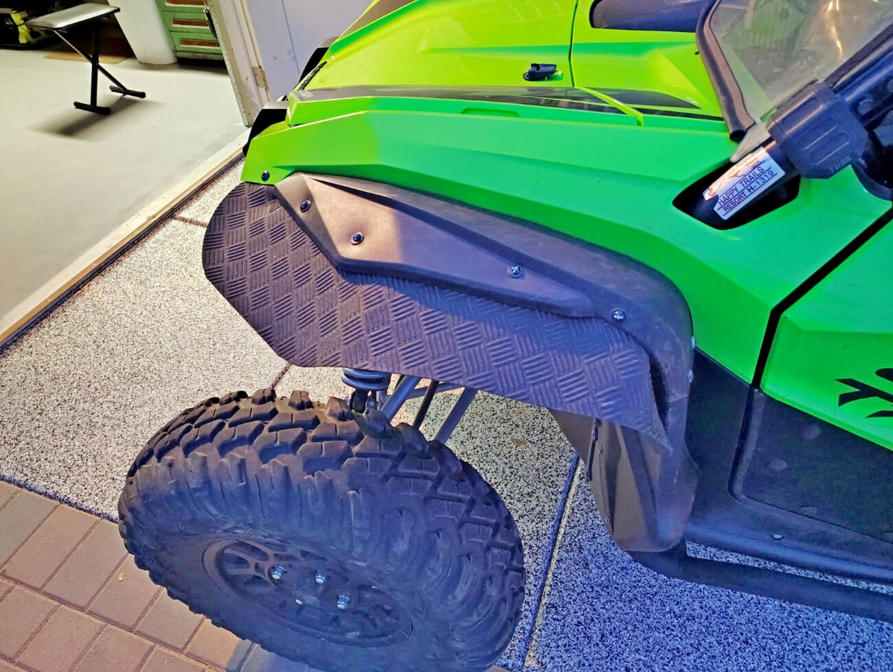

I added some rubber to my left fender last night. Even though it isn't something needed often. When it's needed, I need it. I may be looking at another 700 mile trip this fall. So far I just added the rubber, without any underneath support. I need to finish the right fender and do some test riding to see how it holds up unsupported. And I'll need to find some mud to see how that extra weight on the flares night make it sag. The rubber is about 4 inches farther forward and 2 1/2 inches wider than what I previously added. A straight line from the front of my new rubber to the high point on the rear of the tire, looks like it will make a huge difference on the spray I will ride in to. But we'll see.
The first picture is what I added a few years ago. It helped a little. But not enough.
