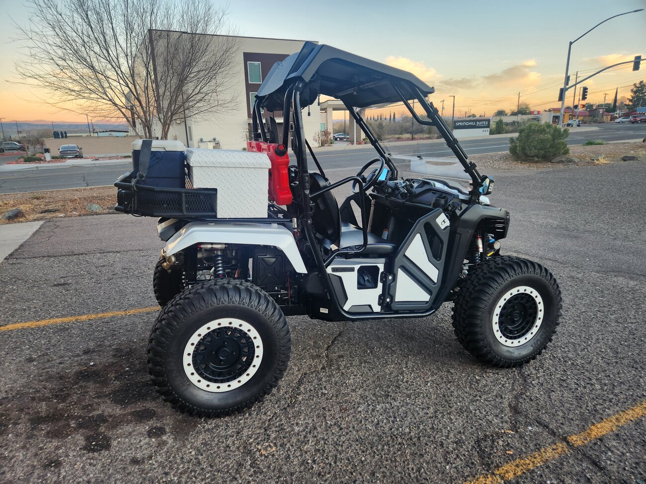

  2. Talon X LV
IMG 0906

That's gorgeous, Bear!

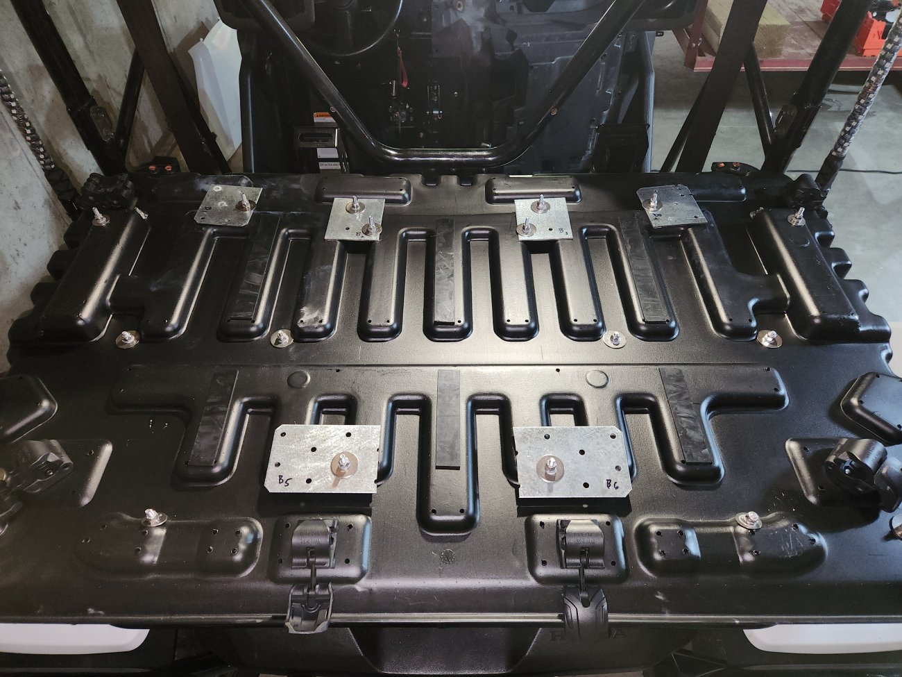

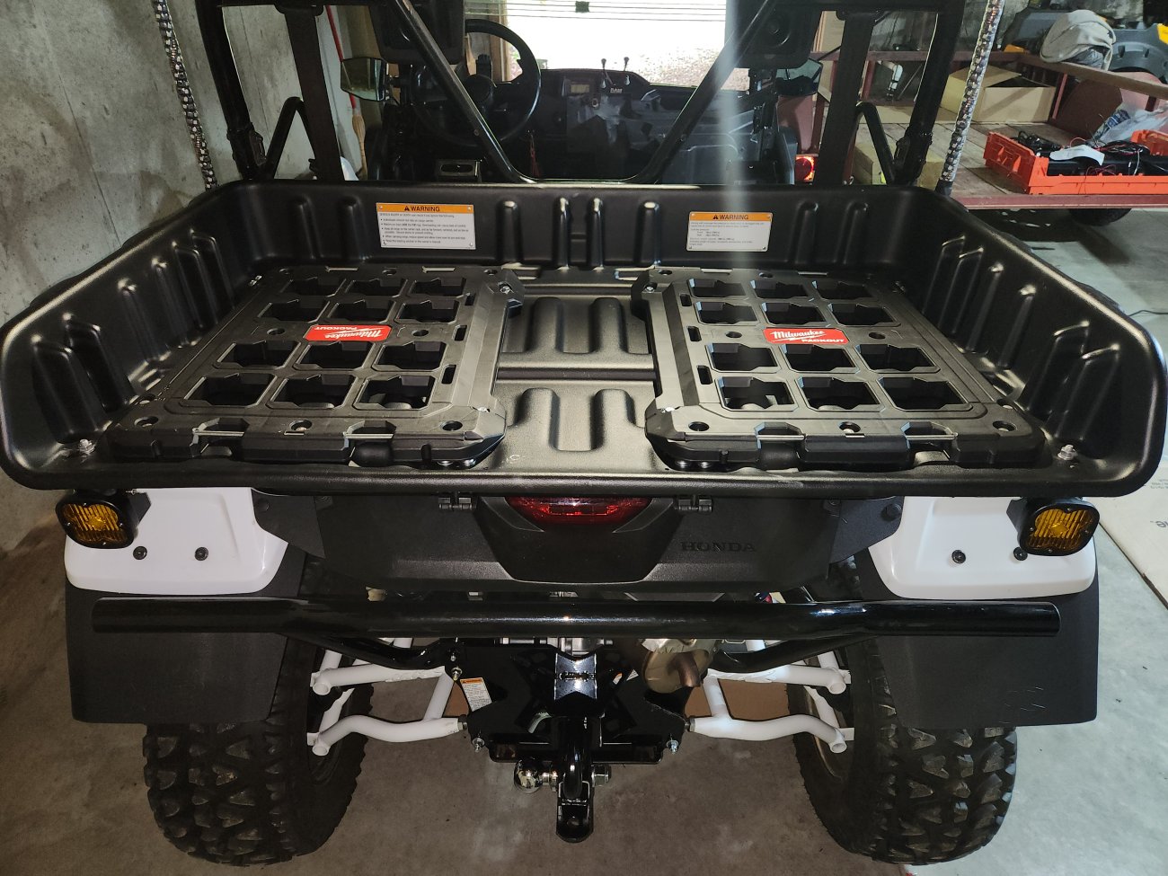

Finally got the PO bases mounted.
Cut up a couple of Simpson flat plates to span voids. Ain't proud of it but should stay put. Stainless hardware.
20240401 15290820240401 163304
Gotta choose some PO items now!
