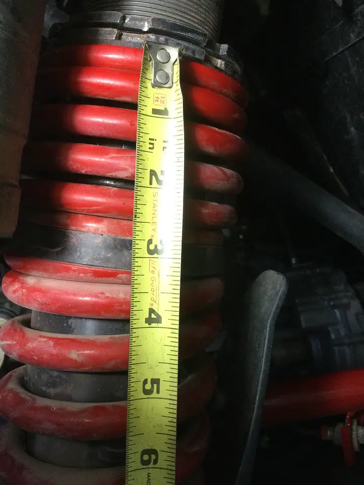

I'm not familiar with the LV but here's a photo of my tender, squished under static load. It started life at ~4" and ended up here after a few thousand miles and trying to get my ground clearance back up to 14". I had ~10-1/2" GC here.

Are the tender springs still fairly extended of have they compressed like in my photo?
They're extended. I was concerned but no need.
